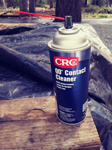

Max, several of us have experienced motor errors on our Vados. Resetting the bike (power cycling) seems to work for everyone. When this happened to me I was able to ride home after the reset. I then used a plastic friendly contact cleaner on the battery and frame mounted power connectors. I also used a 'Q-tip' soaked in the cleaner to 'scrub' the contacts. I've made this a normal part of my maintenance procedures. The motor error has not recurred for me with well over 1,000 miles since the first contact cleaning.
Thanks for the advice guys,i going to do that
