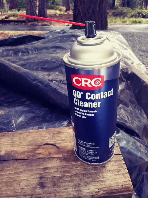

Max, several of us have experienced motor errors on our Vados. Resetting the bike (power cycling) seems to work for everyone. When this happened to me I was able to ride home after the reset. I then used a plastic friendly contact cleaner on the battery and frame mounted power connectors. I also used a 'Q-tip' soaked in the cleaner to 'scrub' the contacts. I've made this a normal part of my maintenance procedures. The motor error has not recurred for me with well over 1,000 miles since the first contact cleaning.
