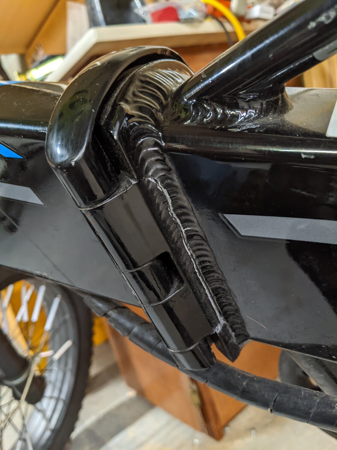

My frame by the hinge is cracked...looks like I am buying a new bike this week. Don't think I will get an Lectric again, want something a little higher quality. This is something I noticed that happened with other Lectric bikes, didn't think it would happen to me.
Well I had my bike for almost 3 years, mainly riding in NYC. Put in a little over 3000 miles and noticed a strange clicking noise. Today I noticed a little bit of wobble and looked a little more carefully... View attachment 126030

I mainly road on streets, some potholes no but I wasn't doing any major curb hopping (once in awhile I would go down a curb at a low speed) . Also avoided rough terrain. I think it is a design flaw with the bike, aluminum is not a great choice with a folding bike. If NYC had less pot holes, maybe the bike would have lasted longer. I think I will go for a non-folding bike next.
At least the bike paid for itself by not having to use the car. I am definitely avoid folding bike now unless the frame is steel. The crack looks like a fatigue crack from the constant stress from riding. Note: I only weigh about 162 pounds, so I doubt it was weight. I did us it to haul some groceries sometimes but only a small milkcrate.

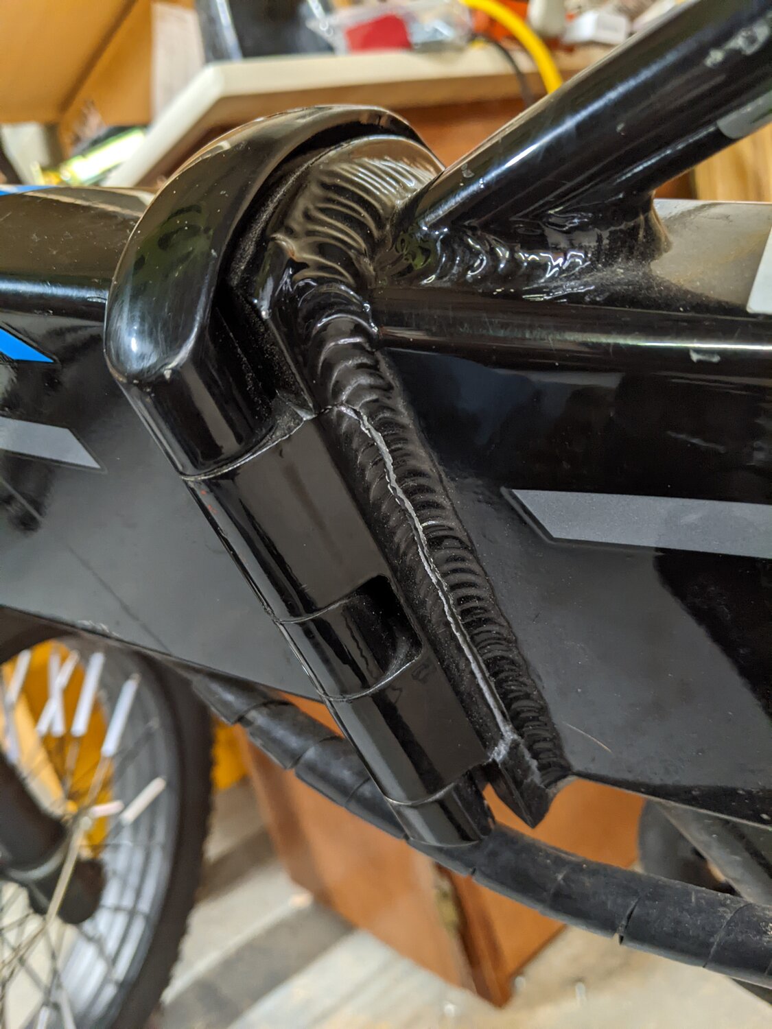

Stress crack likely from the prior bad crash you suffered back in 2020. That's the bad news. The good news is it's repairable.
I looked at the hinge a few months ago, everything was fine. The crash wasn't a bad one, wasn't going fast and I fell wrong. But I think the wear and tear from bad streets was more of a factor.
There could have been almost invisible damage initially that over time just spread. I'm sure the NYC potholes didn't help.
It is not the only Lectric bike I've seen with to this problem. Foldable bikes are going to be more susceptible to these type of issues. I got my money's worth, going to go with a non-foldable for my main bike and see if I can get this repaired and keep it as a spare.

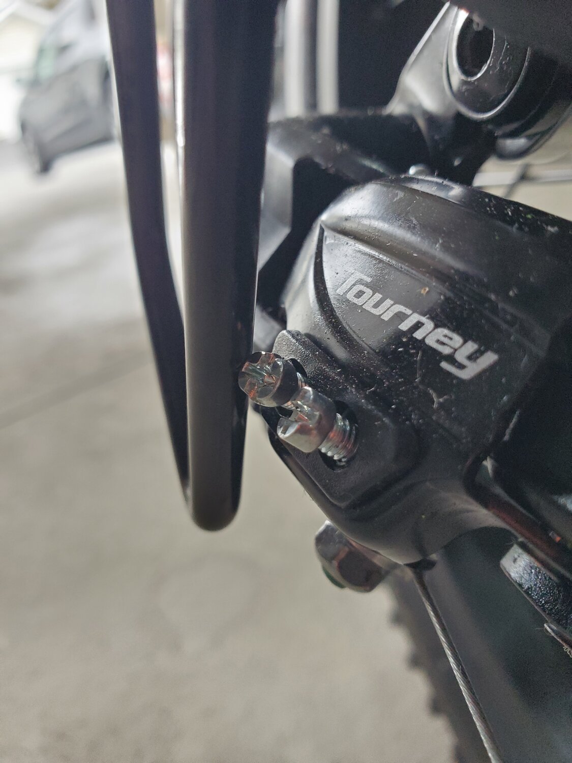

I had an issue with my two new XL 2.0's that I'm sure isn't an isolated incident. The derailleurs on both of the bikes were being "blocked" by the derailleur guard that is supposed to protect it. One bike wouldn't go into 7th gear, while the other wouldn't go past 3rd. I'm assuming this happened during shipping. In the photo I've attached you can see the derailleur screw hitting the guard. I spoke to Lectric customer service via email and was advised to simply bend the guard out so it clears the derailleur at it's furthest point. I was a bit hesitant, but he assured me it could be done safely without damaging the bike. I did it and it worked. Both bikes are shifting normally now.
I must add that Lectric customer service was quick to respond to each email I sent.

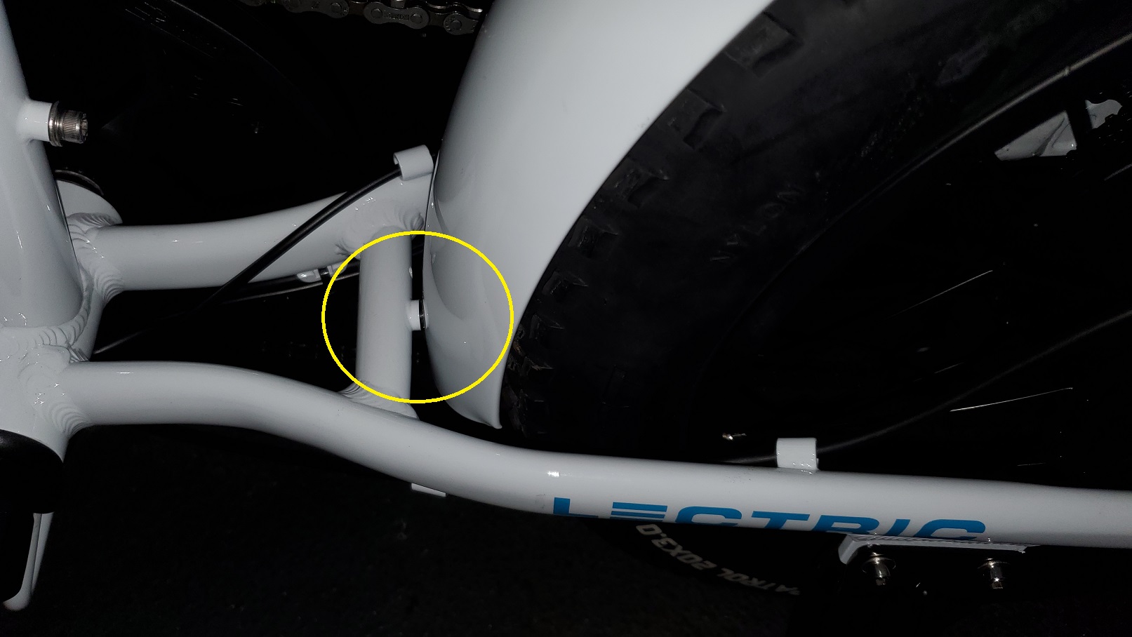

Problem: XP 2.0 step-through. Made a grinding/scraping noise when accelerating under load such as going uphill, even a hill with a fairly mild incline. Sounded like a shovel dragging on the pavement.
Possible cause: Rear fender vibrating against the frame.
Possible solution: Placing a thin rubber or plastic washer between the fender and the frame.
Here is a picture showing the location I placed the washer. It's the black washer between the fender and frame.
I first thought it was the motor because it only made the noise while under load.
When I reported the noise to Lectric, they initially dismissed it and said it was normal. I said it was not. Thinking it was the motor, I asked them to send a replacement wheel which they did. Unfortunately, this did not fix it. They then told me it was the brakes and to take it to a bike shop to have the brakes adjusted. I told them no, if it was the brakes it would be a constant noise, not something that only happens when the motor is under load.
I continued troubleshooting and eventually noticed the contact point between the fender and frame and installed the washer as pictured. This seemed to greatly reduce and possibly eliminate the noise. I'll do more testing this weekend but so far it did make a big improvement just riding it around my block.
To reach the screw you do need to take the rear wheel off but this is a pretty simple task and no different on an ebike than on a regular bike.
So, if you run across a similar issue, it won't hurt to at least give this a try. If you have the right tools it shouldn't take more than 45 minutes to remove the wheel, install the washer, and replace the wheel. There are several videos on Youtube that will walk you through the wheel removal/replacement.

I got the new controller today and installed it (I got. New wheel a few weeks back). Yesterday I took the rear wheel off and put rubber washers on the two places where the fender attaches to the frame. After installing the new controller I took the bike for a short test ride. I heard the sound right away and then it stopped. It reappeared a few times during my 8 mile ride, always for just a few seconds and pretty much under load conditions.
