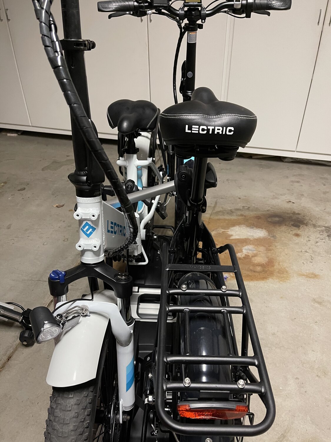

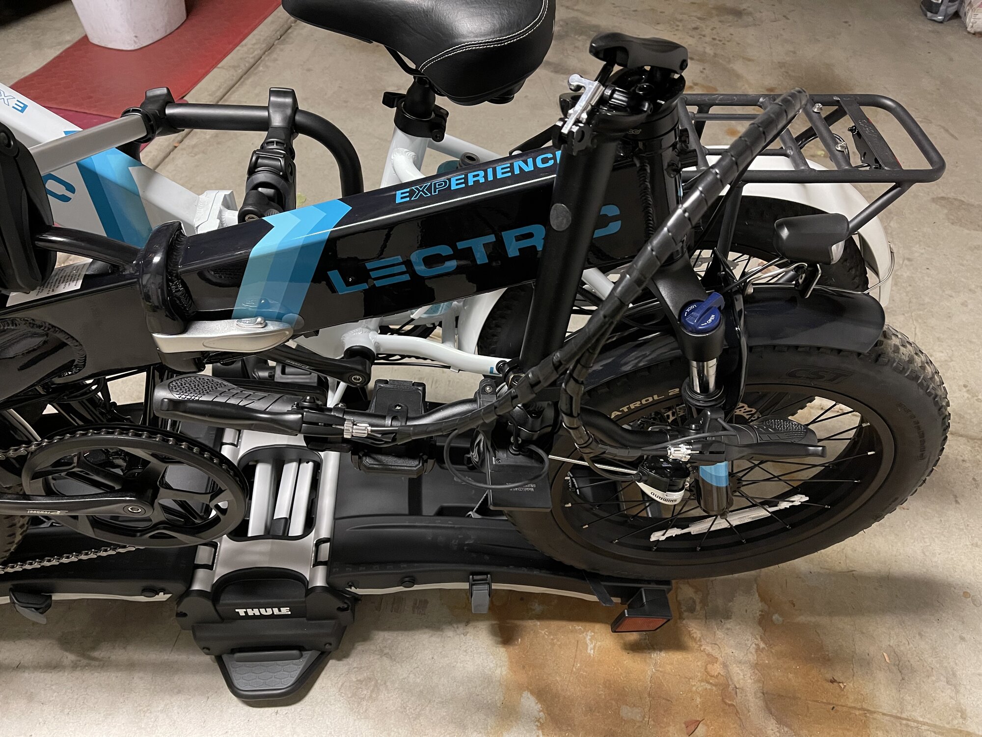

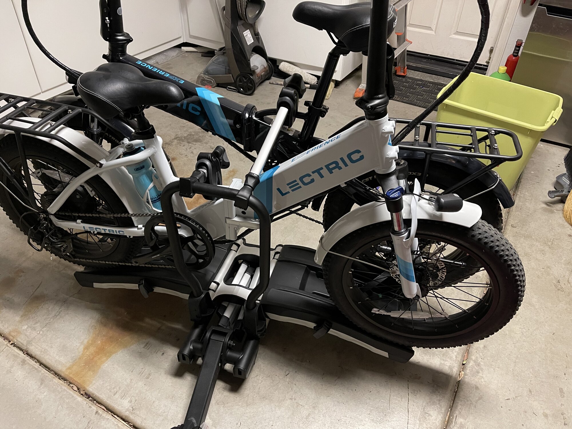

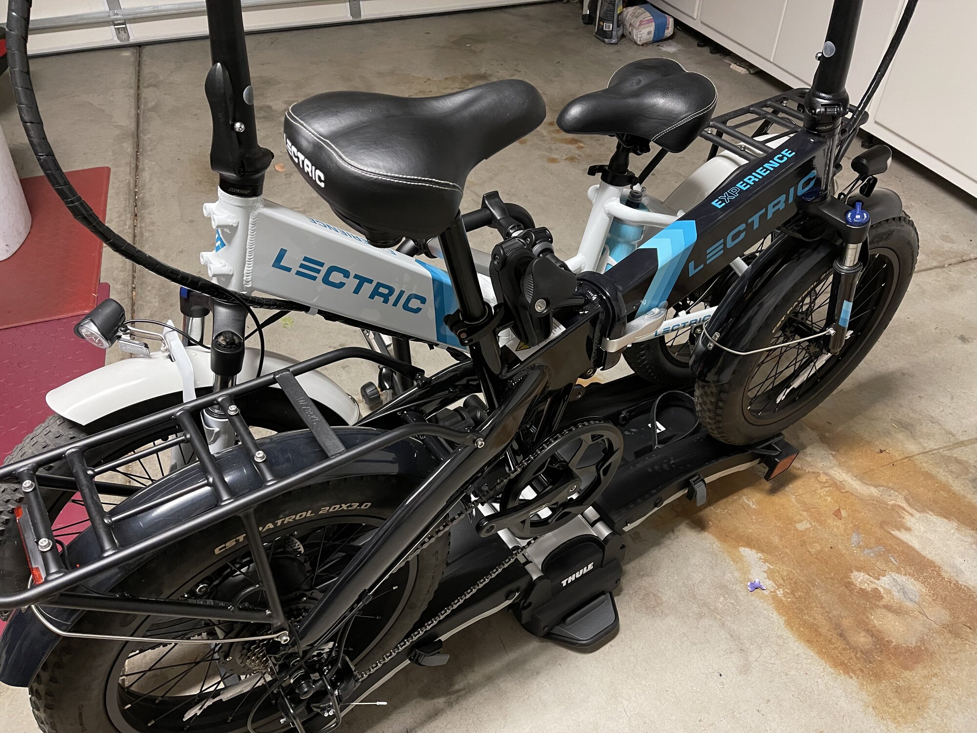

As for bike racks, I fortunately years ago had bought a "Softride" receiver-mount rack. Weighs a ton but one of the horizontal supports slips under the frame just in front of the rear fender, and I've found a beefy strap perfectly supports the front of the bike from the small frame tube located just over the controller location. 600lb capacity on the strap--it isn't going to fail. And this particular rack has a parallelogram design, so it can pivot away from the vehicle for rear hatch access.
