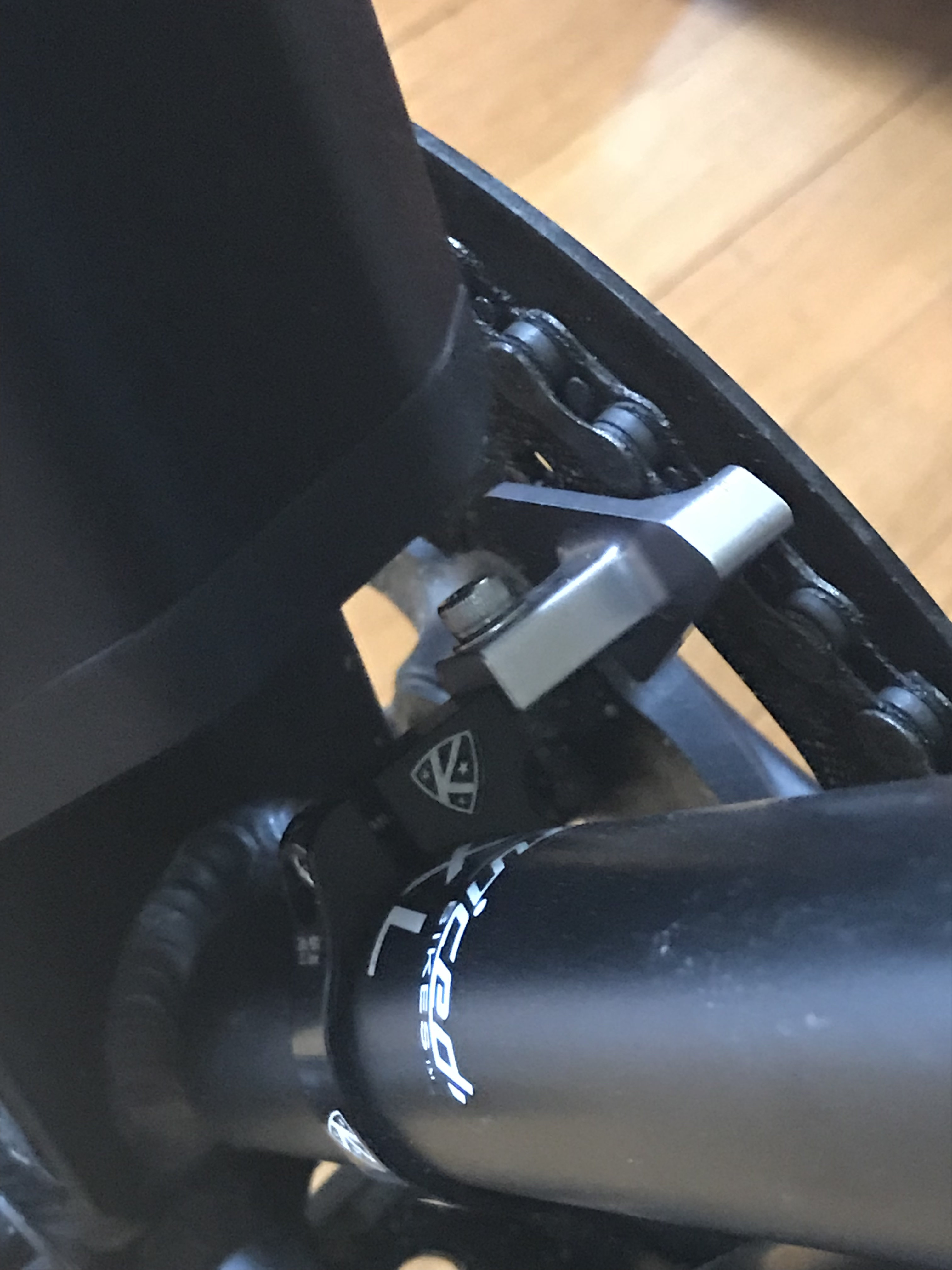

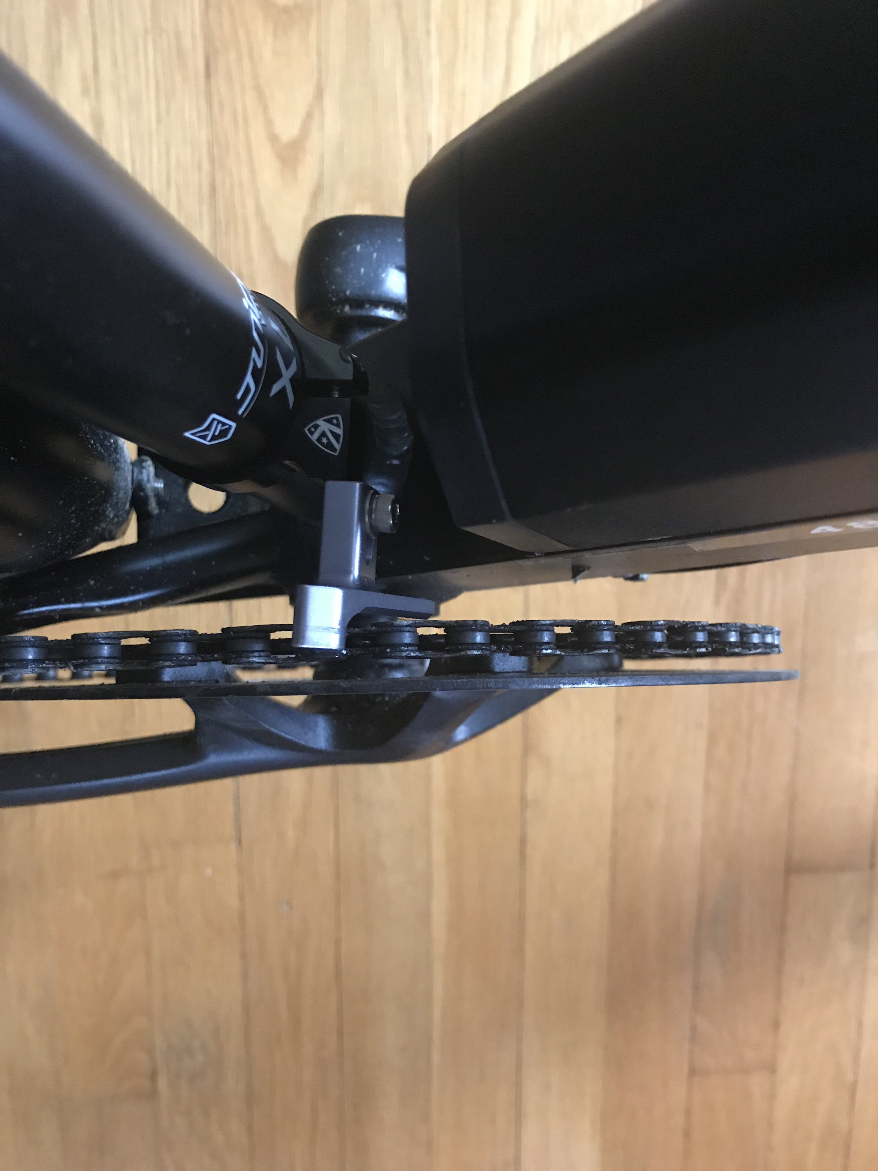

The FAQ on the Juiced Websites list a few things you can do to avoid chain drops. I haven't seen that mentioned here in the forum, so I thought I post the link.
https://juicedbikes.happyfox.com/kb...ring-when-going-over-bumps-or-shifting-gears/
I installed the exact chain catcher that is listed (K-Edge Cross Single) there after I had two chain drops during my first ten rides or so. So far, so good - no more drops. Time will tell if it is going to hold up.
The chain catcher is a bit pricy for what it is, but it fits perfectly and I was able to get a returned but new one for $20 on eBay.
Slow, can you post a pic of your chain guide installed? Thanks.
Thanks for the pics. Nice that you were able to find a cheaper one. I'm hoping I don't need to spend $60 to fix this problem.
