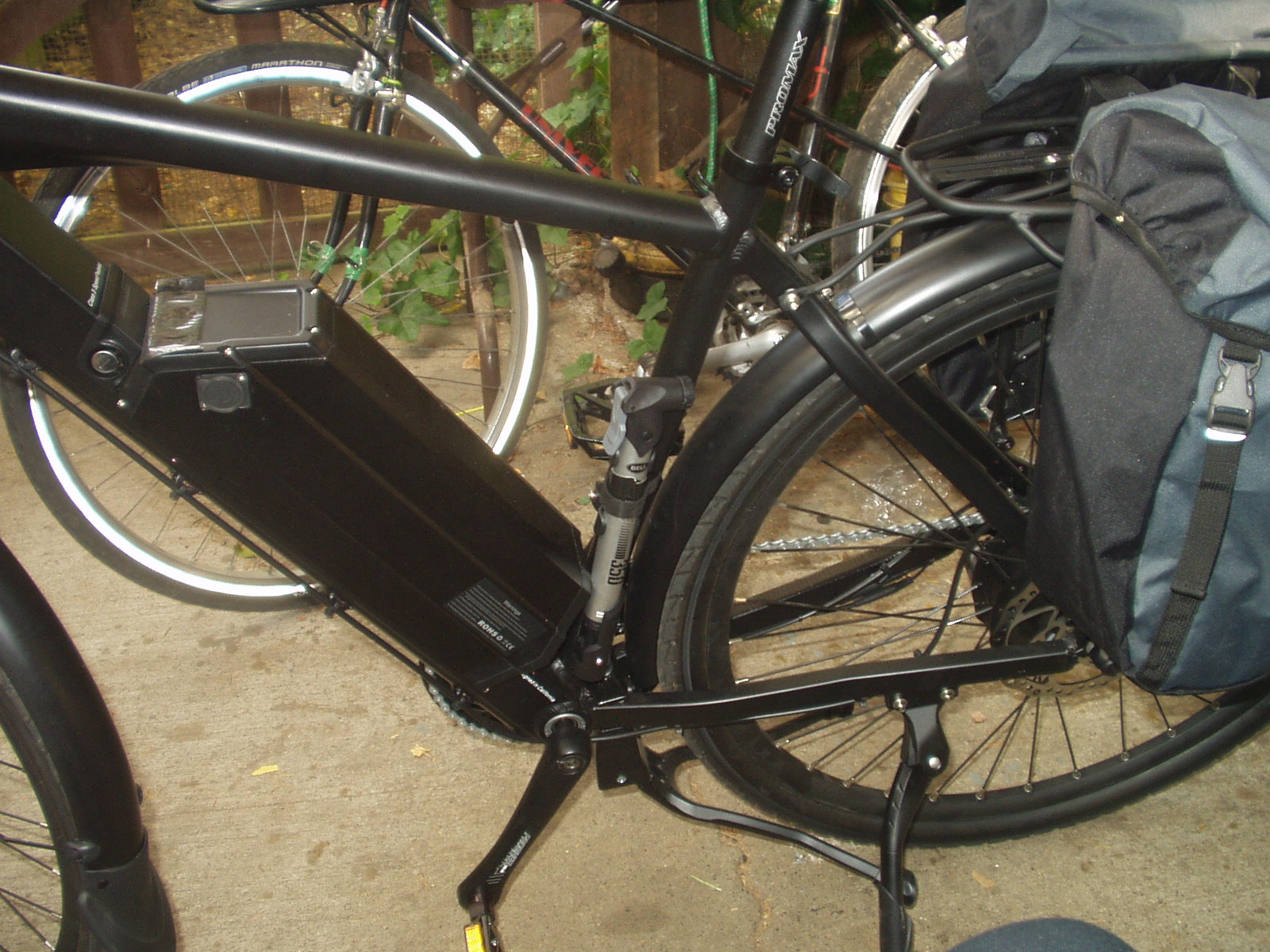

Living in the rain forest, I put black duct tape over the button before I ever rode my CCS. Ant has just confirmed
my initial doubt as to it's being completely waterproof. Pretty cheap, easy precaution. 013.JPG
my initial doubt as to it's being completely waterproof. Pretty cheap, easy precaution.View attachment 20060
My thanks to you and Ant for this suggestion. The rainy season in NC is about to start. I'll put some black Gorilla tape over the button. Should do the job, and blend in nicely.
