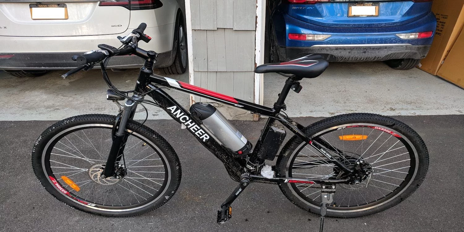

What's with the Ancheer? I know they're cheap; is it any good?
