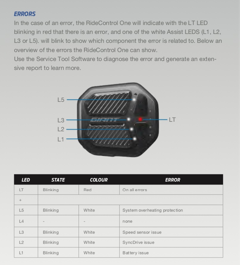

The flashing red LED and associated Assist Level white LED are displaying a fault code that will assist in diagnostics. See the attached picture. The dealer service tool should be able to give them more detailed information. Unfortunately as is usually the way it is clear that historical faults are not written to NVM and a power reset is clearing the fault. Basically the faults needs to happen when they can connect the dealer Service Tool.
Thanks, that information should be helpful. I will have her watch for the other LEDs when it happens again.
