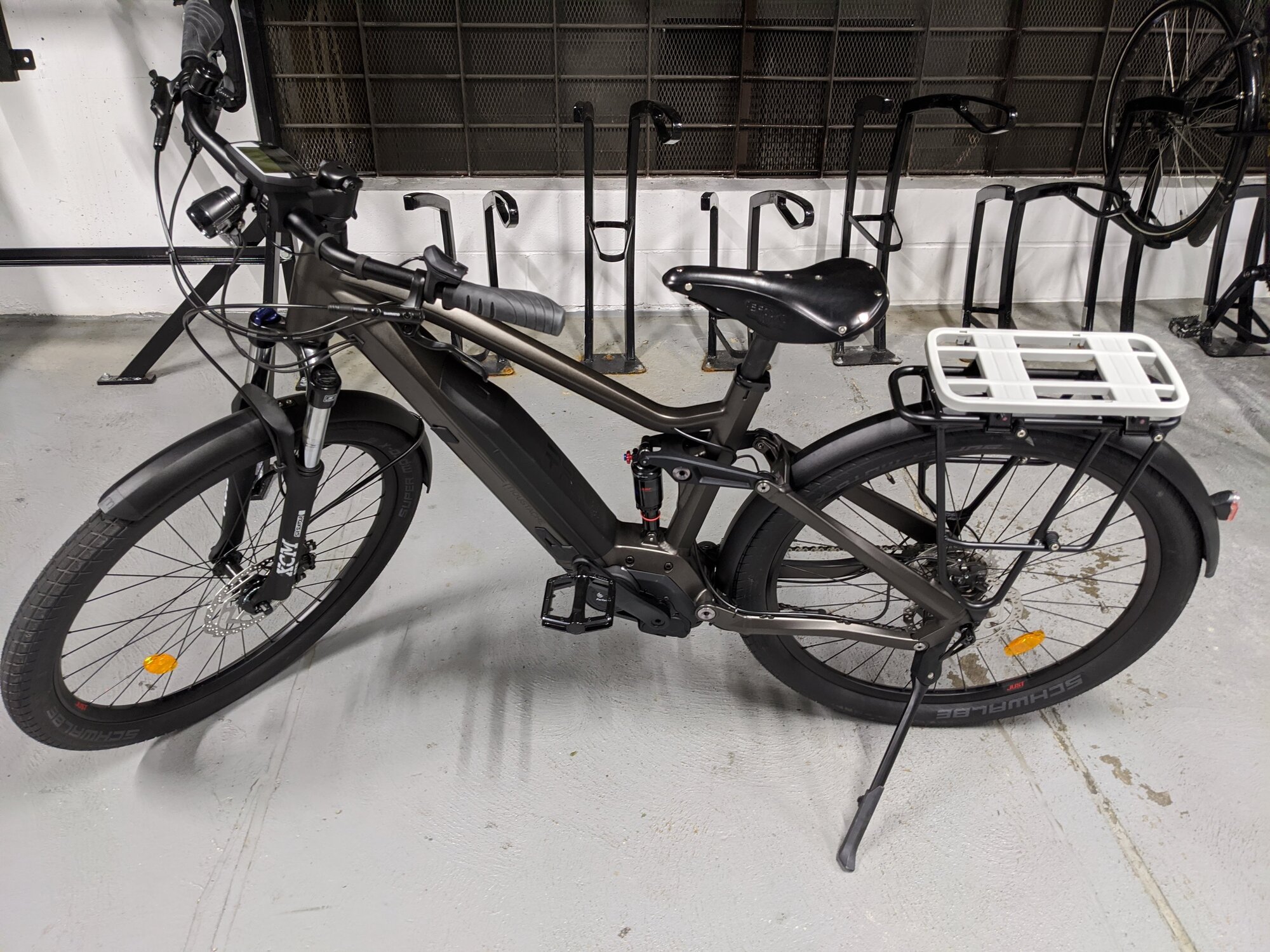

Hey Jason,
Thanks for tagging me. A few questions for you--would you mind uploading a picture of your bike?
Is the drive unit on your bike a Performance Line CX? Assuming yes, since you mentioned it being a MTB. We also have a Performance Line Cruise drive unit.
Which specific drive unit does your wife's Gazelle have?
Could you describe the vibration you feel? Is it in the cranks/pedals?
When you say "unobtainable," what do you exactly mean by that? The Performance Line drive unit will provide assistance up to 32km/hr in your scenario. Dependent on mode of assistance and other factors, the feeling as you approach the "cutoff" will vary.

Hey Jason,
Hi Stephen, picture below of Moustache Friday 27 FS, sorry it doesn't have the drive unit pictured I can get that later if needed. It actually isn't the CX, it is just the Performance Line the same as on my wife's Gazelle Arroyo C8. It's hard to describe the vibration but yes I feel it down in the crank/pedals all the way up through to the handlebars. Admittedly I haven't ridden my wife's as much but I haven't felt the same in hers.
In regards to the "unobtainable" speed what I mean is even in Turbo mode on a very flat surface or in some cases a slight decline I just can't reach 32km/hr, the cutoff comes in around 28-29 sometimes but not always with the vibration/grinding feeling. My wife's the assistance cuts out quite nicely right around 32km/hr.
All that said I did learn something new on my commute yesterday. My wheel circumference looked to be quite inaccurately set all the way down (can't remember the exact value, 1800's I think). With it set to what I measured of around 2220 the assistance cutout is closer to a display of 32km/hr. Is that an expected observation/experience? Unfortunately even with the circumference increase the vibration experience is no different.
