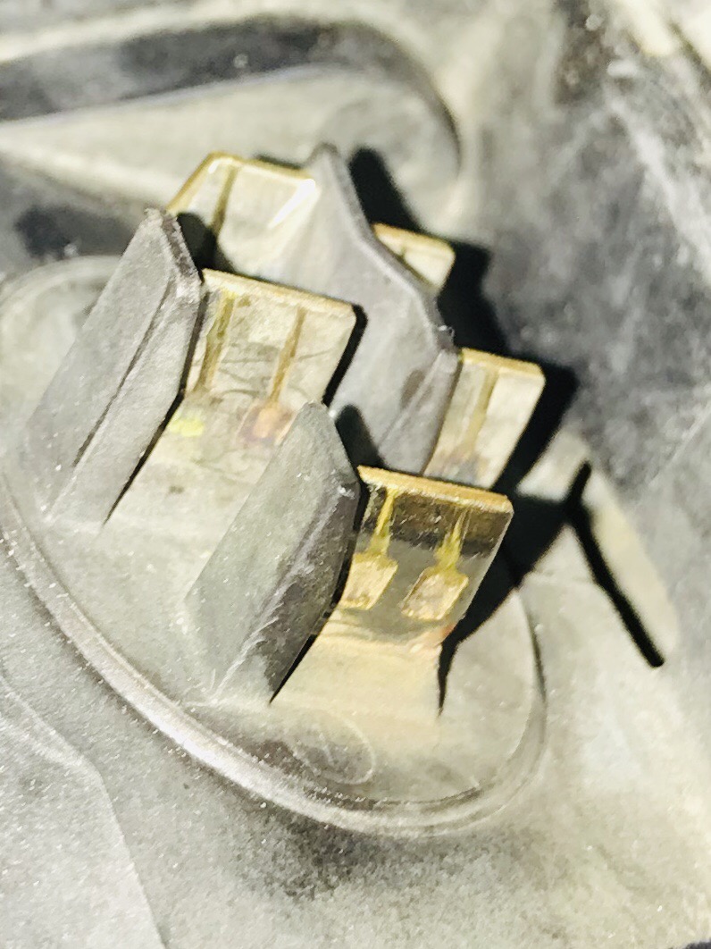

Hi everyone, my Bosch performance line motor has started cutting out on random bumps while I am riding. Its a commuter bike just over a year old with about 6500 miles on it. It doesn't do it on every ride, but some rides it will happen more often than others. I will be riding along, hit a bump on the sidewalk, lose assistance, look down at the lcd just in time to see it say "shutting down" then it shuts down. No errors when I power it back up and everything is back to normal and it may or may not happen again on that ride. One oddity I've found while looking around the bike. The terminals on the bike where the battery plugs into have little holes or indents on them where the battery contacts rest on them. Its worse on the plus terminal, but the minus terminal has them also. Has anyone seen that before? The motor is still under warranty so I will take it in soon to have it looked at. Thank you!
I am actually having my local shop try a warranty claim for the exact same thing on my Haibike. Corrosion and deformation on the plus terminal of my battery. When I carefully clean them off and bend them in I can make it better but it usually comes back after a while. I get the same occasional cut-out when I hit a bump. Also, sometimes the battery starts charging but quits before it is full. My guess is that the heat from the charging process is enough to bend the plus terminal enough to lose contact. I'm hoping to get a replacement battery.
Hello all, just wanted to follow up on this. I took the advice of a few people here and tightened the battery mounts and that did seem to fix it. I've had a strap around the battery since I bought the bike to hold the battery in place better but I guess that wasn't enough. Anyway, I have over a hundred miles without a shutdown. Thanks everyone!!
