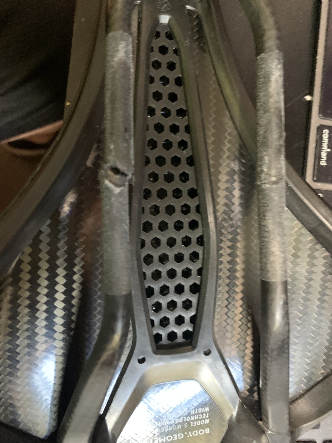

I have had for several months a S-Works Power with Mirror saddle (carbon) on my 2022 Vado 5.0.
I also have the KINEKT Active Suspension Seatpost ( https://cirruscycles.com/products/kinekt-active-suspension-seatpost )
I've been a user since the day of the release of the product(s) (both items).

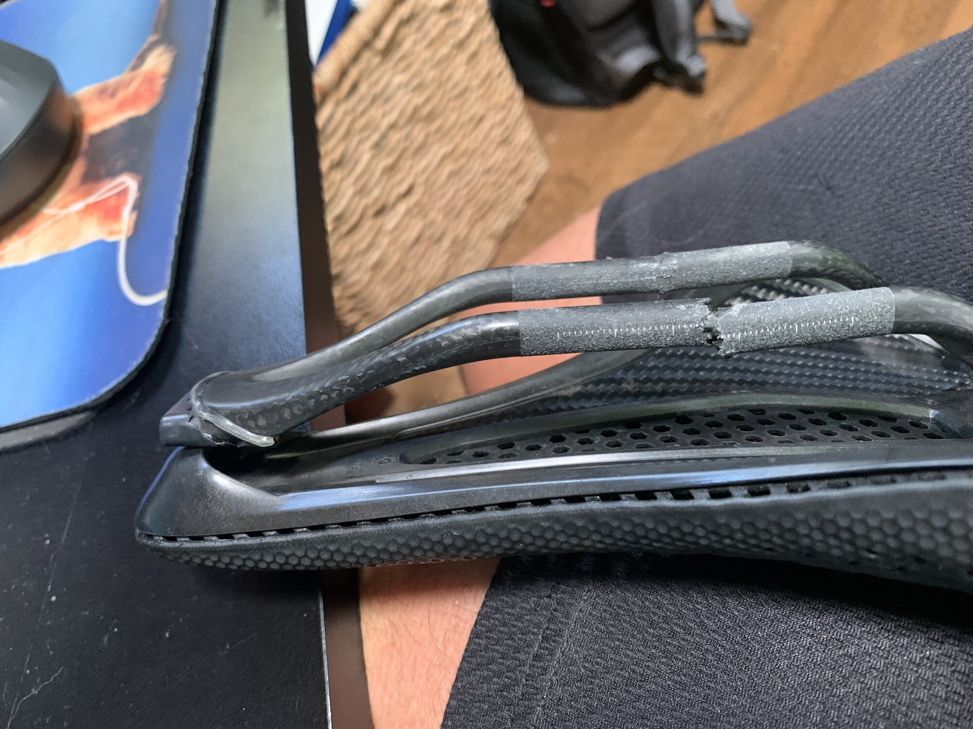

A few weeks ago a "clicking" was heard while pedaling.
I had posted a separate inquiry here about that thinking it was the motor cover bolts.
It wasn't.
It was the rails of the seat.
I called Kinekt today.
"Jake" said they have done no studies of using any carbon fiber seats with the Kinet posts.
I asked to have it escalated to an engineer.
He said they no longer have any engineers.
Just sharing my dilemma.
Is it the Seatpost/spring causing stress on the seat rails, or????

If anything a suspension seat post should put less stress on carbon fiber rails (or any other material) than a fixed, rigid seatpost with no compliance.
I have the same setup with the Power Pro Mirror (titanium rails). So far so good. Are you sure your weight doesn't come into play? or hit a big drop/bump that bottomed out?
I guess I would just assume it is a specialized warranty issue. Carbon fiber and Titanium rails do break on bike seats.

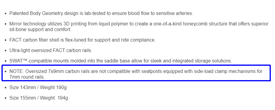

From the product page:
Note: 7 x 9mm carbon rails require a compatible seatpost clamp or an adapter kit.
I assume the Kinekt is designed for standard 7x7 round rails

carbon fiber is meant to be clamped consistently/evenly. you can’t clamp a 9x7mm carbon fiber oval in a clamp designed for a 7x7mm circle. the forces will be applied unevenly, eventually shearing or damaging the carbon fiber in some way.
specialized sells two kinds of seat clamps, one for 7x7, and one for 9x7. the instructions with the power mirror (i have a couple specialized carbon rail seats) are pretty clear on this.
this is not kinekt’s problem nor specialized’s. presumably there is an appropriate kinekt clamp for an elliptical rail saddle, although very few people put super light saddles on suspension posts, for obvious reasons.

I was tempted to buy one of the Specialized saddles with the Mirror technology and I actually found the right information before I decided to purchase the seat exactly in the Power Mirror description:
You seem to have not read that Guru.

it really says it pretty clearly in the instructions, and in other places at stefan noted. your LBS did not "professionally" install the seat, they should not have put a 9x7 rail into a 7x7 clamp.
the good news for standard seat post users is that the clamps are now readily available - back when i got my first mirror seat it was really hard to find the 9x7 clamp. literally every shop i called knew exactly what i needed "oh you mean the one for the carbon rails?"
Well, I returned the seat today. They submitted it for warranty. IF accepted, I'll get the credit and replace it with the Titanium model. At the time of original purchase, Titanium was not an option, only carbon. Hence the forward movement of the situation.
