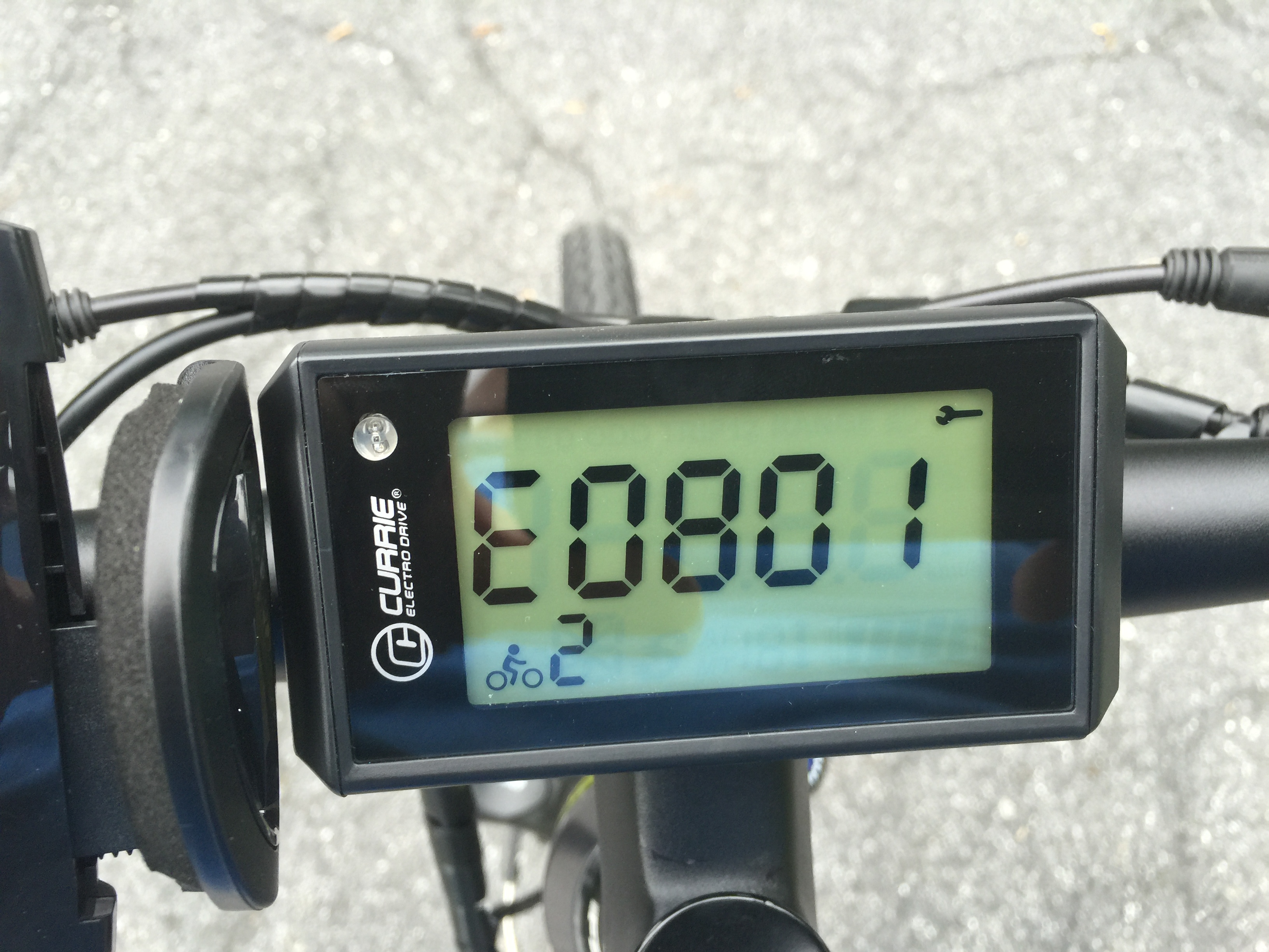

Am I a jinxed E-bike owner? 3 miles on new E3 Pro Tour and I got an error code.
No power.
I was able to ride home with this type of failure but definitely harder than a normal bike.
I know IZip will take care of it but this isfrustrating.
No power.
I had the same issue after 4 days of use (about 25 miles on it). I purchased it brand spanking new and they could not figure out what was going on. I ended up just getting a different brand because there was nothing they could tell me that would make me feel safe with it. Maybe there may be a few bad lemons in the bunch.
I forgot I subscribed to this thread when I first bought the bike and was just alerted of your post. I didn't want to leave you thinking maybe it' something you did to the bike, because that's what I initially thought.
Thanks for replying. I got this bicycle as a replacement for a bad 2014 E3Path Plus that I had issues with from the beginning.
What bike did you end up getting?
Stromer ST1 with the city kit. Although I miss not having the wheel lock I had on the ProTour, I've had no issues with the Stromer going on 4 months (20 miles a day/5 days a week)
I was able to pick up my E3 Protour after motor and controller replacement.
My previous two e-bike we hub motors. Giant esuede and the 2014 IZip E3 path plus.
It takes some getting used to riding with the hub motor. Court describes it well when he compares it like a hub motor being an automatic transmission and the mid drive as a manual transmission.
If I do not have it in the right gear for the speed or hill there is a bit of hiccuping. By the end of my 20 mile ride today I was getting it down.
Where the assist button are placed on the bike makes it easy to change assist levels. On level ground I just used level one and can maintain 12-15MPH.
I used level 4 when I had to get into car traffic and One big hill in the beginning of my ride.
I like the way it feels. I was able to get a small frame which fit me nicely so that is another plus. I feel like I am controlling the bicycle better than my previous E-bikes.
My motor went out again this week. It was not electronic this time. A grinding in the motor. When I contacted my dealer and Chawn from Accell, the dealer told me they just put out a recall for these motors. He had the new motor in his store the next day.
I picked up the bike and rode it today.
All I can say is WOW what a difference. The shifts between gears is so much smoother. I was easily able to get the bike speed up to 28MPH even when I was not in the lowest gear. It is like getting a new bicycle again it is that much different.
When I turn the bicycle "on" it does not go through a smart-up sequence that it used to. It is just ready to ride.
Hopefully this finally solves the issues.
