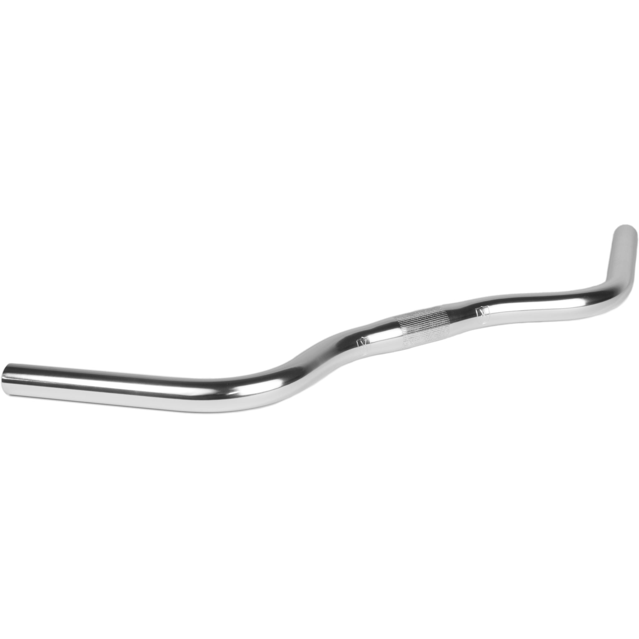

Just wanted to confirm with others on here, would the handlebar below attached below work for the 700XA , plus would I need to buy a stem as well or not? also linked . Many thanks.
Or
and stem needed? I think the current one on the 700XA would suffice.
I'm not familiar with the 700xa but what you need to match is the clamp size (the very center of the bar) with the current bar if you want to use the current stem. The two bars you linked have different center diameter measurements but yes they are both considered swept back.
Sorry it was a typo , I meant to state 700XR. I was going by figures under the 1RideUp spec sheet, or was I reading them wrong?. Attached below.

Oh yes, one of the bars I posted wasn't 31.8mm? Ive updated my first post
