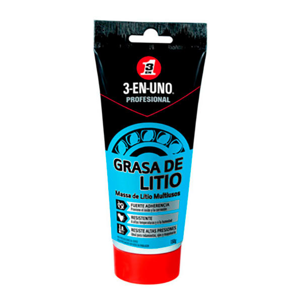

Hi,
I have lub my front hub bearings with a good quality lithium grease. Because it was the only grease I had in the house. It´s not the white version, but the version for bearings , high temparture, etc... but because it´s a fancy bike and because there are a lot of fancy greases for bikes, my question is if is it fine to lub hub bearings with this kind of grease or should I buy some fancy one to lub my hubs?
I´ve removed the old redish grease and gave it a good clean, hub, bearing balls, etc before applying the new grease.
Thank you.
That's probably just fine for the bearings, but you probably don't want to use it in the freehub. That may require a specific grease. The manufacturer should be able to tell you what to use there.
