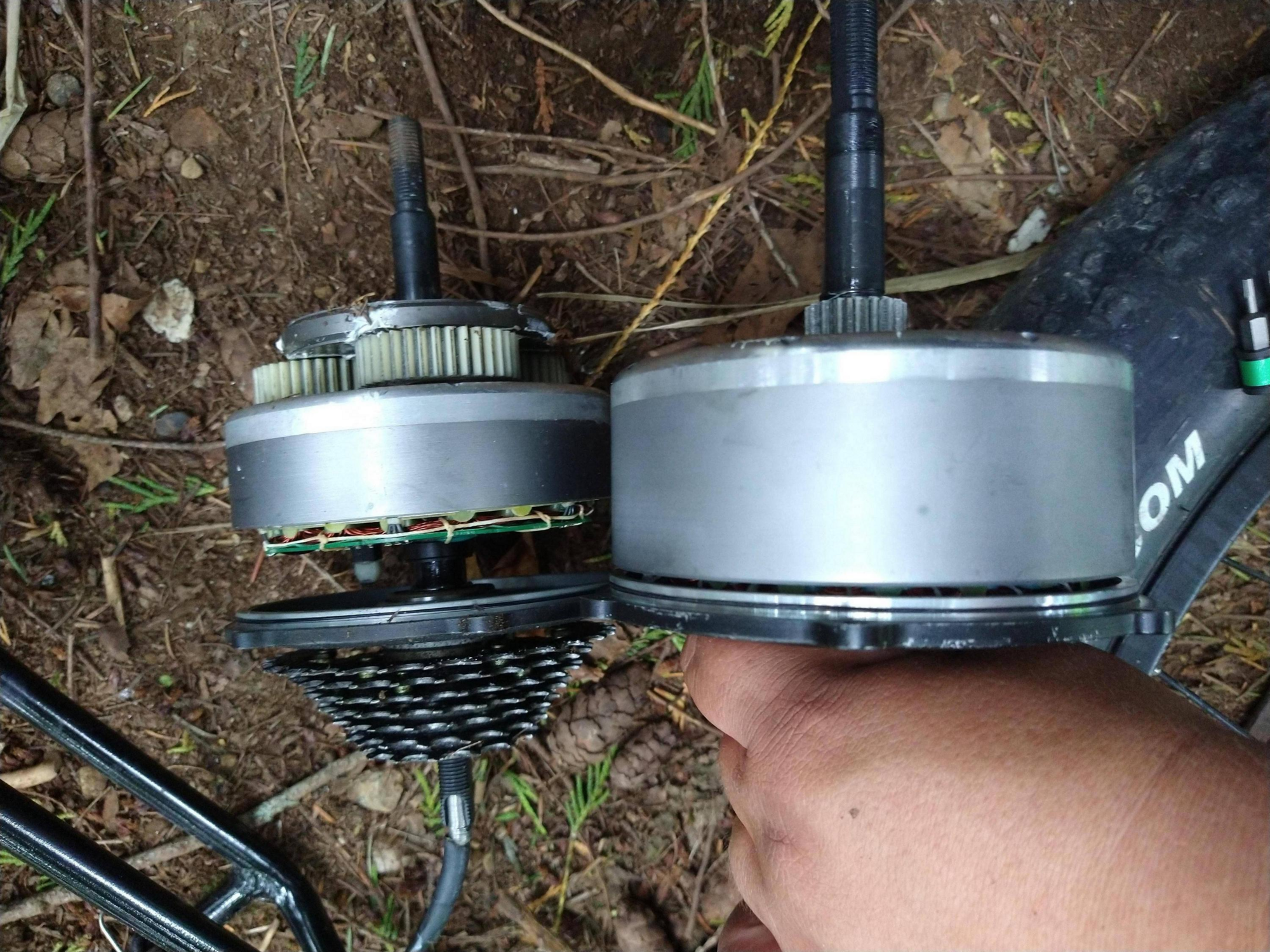

Picture below has the 750w RAD Rover upgrade kit showing on the right. Issue for you is I don't believe this would fit your bike as you don't have a drop out dimension wide enough. This kit is for a fatty. I'm not sure it's even possible to convert a regular width motor. That motor you have listed above is showing it has a 138mm drop out/OLD dimension. Fatty's are generally 170-190mm (way wider, and no, yours cannot be spread). Even if/when you decide to re-lace to convert to a larger motor, that 138mm drop out/OLD dimension will be key as the NEW motor will need to fit there, making them pretty unusual/difficult to find.
If the motor core fits, it will likely have the same power capability and also the same result under the same load. The G60 motor swaps only work because they use thin and thick cores in the same motor housing,
Yeah, you might get 2.3" tires to fit on an ebikeling rim. Ask a bike shop what they would charge to respoke an ebikeling motor into a 44mm rim,
The G060 motors were commonly upgraded because Bafang used the same external casing for an EU-spec 250w motor, which was in fact identical to the 350wmotor core (only difference wass the engraving on the motor outside). Also the 500w version could be swapped in as it had the same physical parts with more copper windings. The 'bigfoot' 750w version actually filled the casing and was - as you can see - a big upgrade. Those motors have been subjected to 2 kw continuous power with custom controllers, and more commonly 1500w peaks.
There were other details like the 750w motors had a bigger plug to handle the increased current, and the Rad models had the big plug on them so they could visually mimic a real 750... but none of that matters to you.
You have a G040 and not a G060. There appear to be only two G040's - the 350w and the more powerful 500w. And you already have that one. There's nowhere to go. So on this motor casing, you are not going to be doing a simple motor core swap to upgrade. Its likely then you will need a whole new motor, controller, display, throttle... the whole bit. Somewhere like Grin Technologies is where I'd look for a proper quality kit. The kind of money involved probably makes this an option you won't want to pursue.
