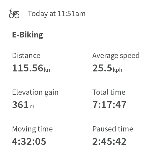

Been on a ride today, Jeremy? 😊
Silly me, I could have done it on a throttle 😊
