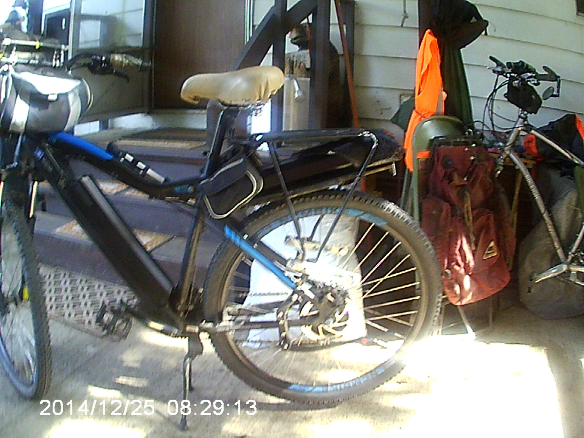

I added a shelf to the under side of my rack for a second battery extending my range to at least 60 miles.
Thatś about 3 times as far as I´d ´enjoy´ riding in one day at my age. I´ve two more batteries I can load on
a small trailer more than doubling my range. Pretty sure I´d be travelling throttle only after the 1st 25 miles.
However, that´s not the full extent of my irrational quest to conquer range anxiety. Last week I finally committed
to putting a kit on my ultralight road bike. I seem to have encountered a few unforseen issues, but a complete
restoration is staggering along nicejy. ( i put 8k miles on the bike built for someone half my size.) I weighed it
before starting; even with the addition of an aluminum top & chrome 8¨ riser bars tube, 22 pds. Thatś pretty
amazing for a steel bike.(tange pro tubing mixte). Hoping to come in under 40 pd. With the 8ah bat. in my
backpack I can toss it on a bus rack & travel in comfort.🥴 PICT0023.jpg The 8ah charges in 2 hrs.
backpack I can toss it on a bus rack & travel in comfort.🥴View attachment 81101 The 8ah charges in 2 hrs.

I notice in your pics you have 2 kickstands. I switched to a center mounted double stand myself, but why the rear traditional single leg kickstand too?

Did you build it out wth that top tube to give the bike more stability ? Only one way to get on that bike, It is a good antitheft system also .
Actually the top tube was put there to support my inframe pannier, but is structural as well. The frame is
somewhat flexible intentionally. My attempt to electrify it was a bust. The stays are just too narrow for the
kit I have. I could go with a front wheel kit, but that would be fairly awkward. Und zo, it will remain what it is.
