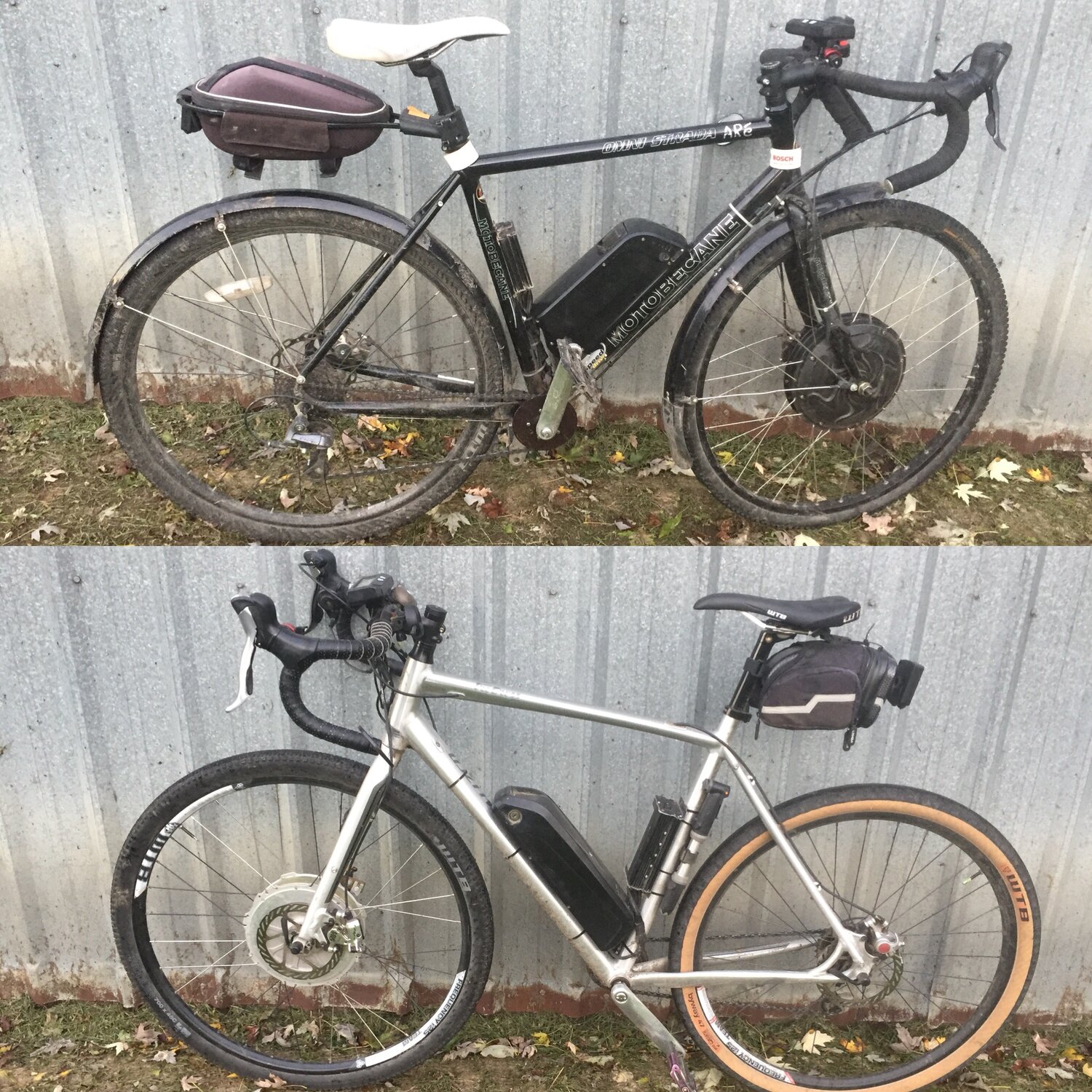

"If you want 30 mph, probably need a 1000W direct drive motor with a 25A controller and 52V. I shudder to see those on a front fork."
Shudder away Harry. I've got thousands of miles on the above as shown below with no issues at all. The key is in the torque arm setup and in general keeping an eye on the situation before rides.

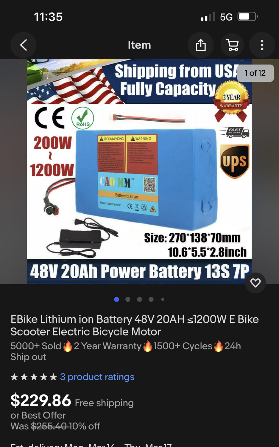

this is what’s weighing heavily on my troubled mind. Delivered in 3 days by UPS and Bobs your…

Your uncle seems to be a bit too cheap to trust, but its your money. ...
It might be worth you taking a look through the DIY section of the forum and searching for 'cheap battery' and the inevitable results - 'when something sounds too good to be true' compared to what some experienced guys are telling you.... it probably is. I'm sure I've seen that or very similar battery packs being discussed.
Total no-name on the motor as well. No direct experience on hub motors but you've got people who do have experience with them in this thread.
Jumping into e-bikes I started 'on the cheap' and read tons of info from what people had bought and done before. Will leave it at the $ numbers crept upward with the more I learned.
Spend low and do it many times as you burn out the motor and roll the dice on the battery and charger (think - fire is a possibility), or build it better for more $, hopefully once, or if not, far fewer times than the $500 special?
