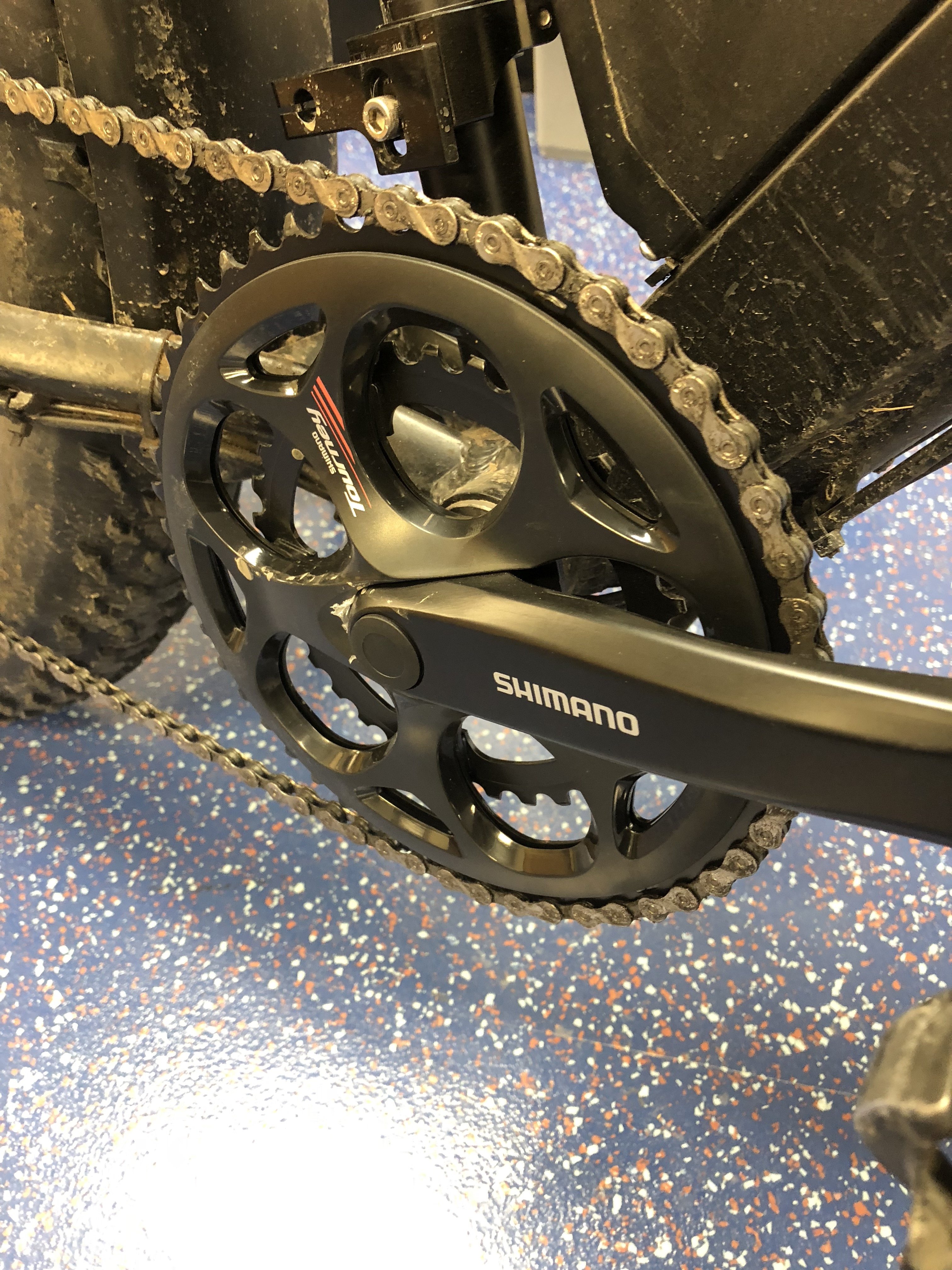

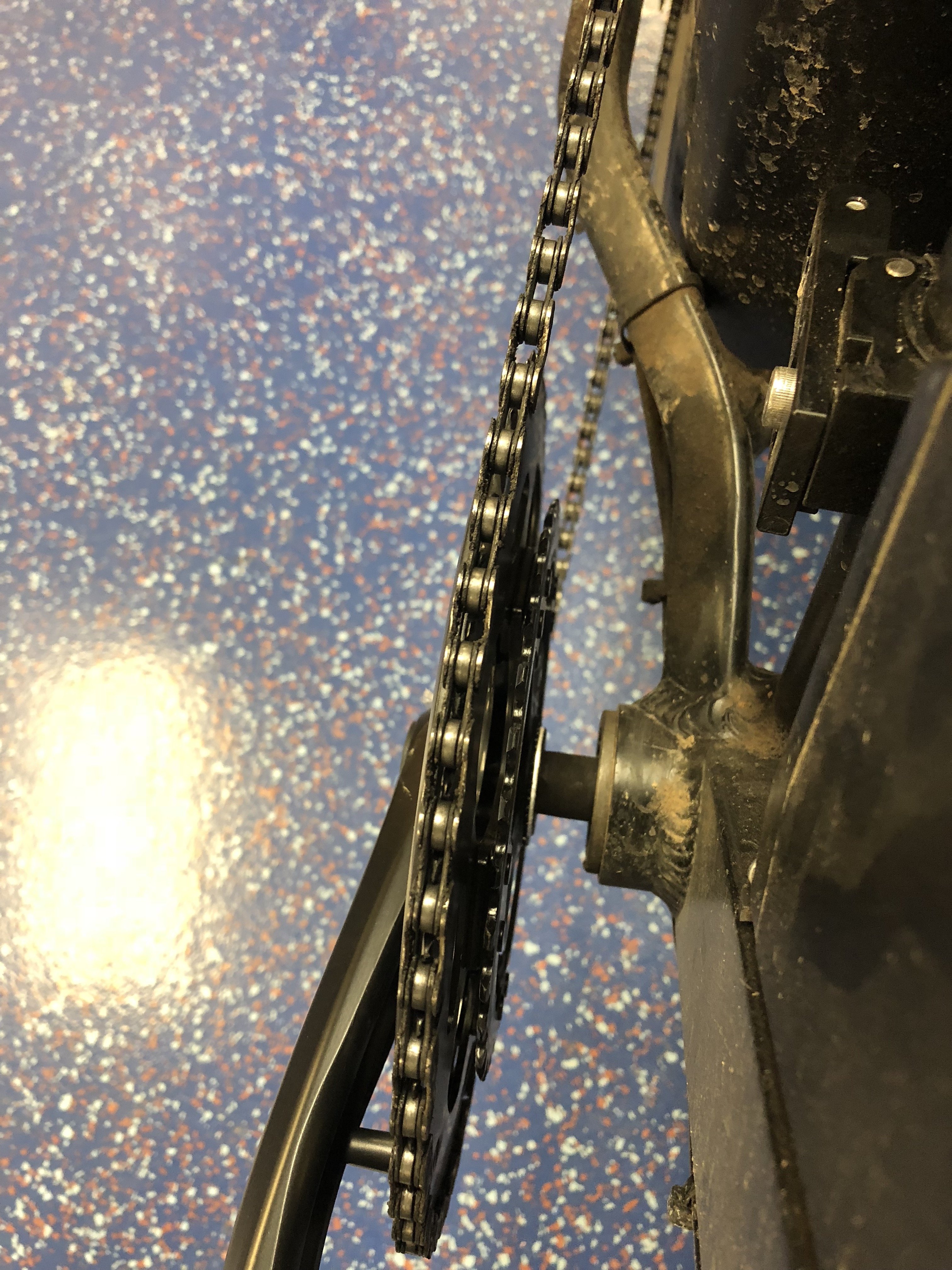

I just changed to a different chainring to experiment with the lower gearing for mountain biking. The Shimano Tourney was about $50. I haven't taken it out in the mountains yet, but can tell you that the chain doesn't drop in the bigger ring even though it's a little farther away from the frame. It is a 50T/34T sized chainring combination.

I just changed to a different chainring to experiment with the lower gearing for mountain biking. The Shimano Tourney was about $50. I haven't taken it out in the mountains yet, but can tell you that the chain doesn't drop in the bigger ring even though it's a little farther away from the frame. It is a 50T/34T sized chainring combination.View attachment 19870View attachment 19871
Have you had the opportunity to try out the 34T much yet?

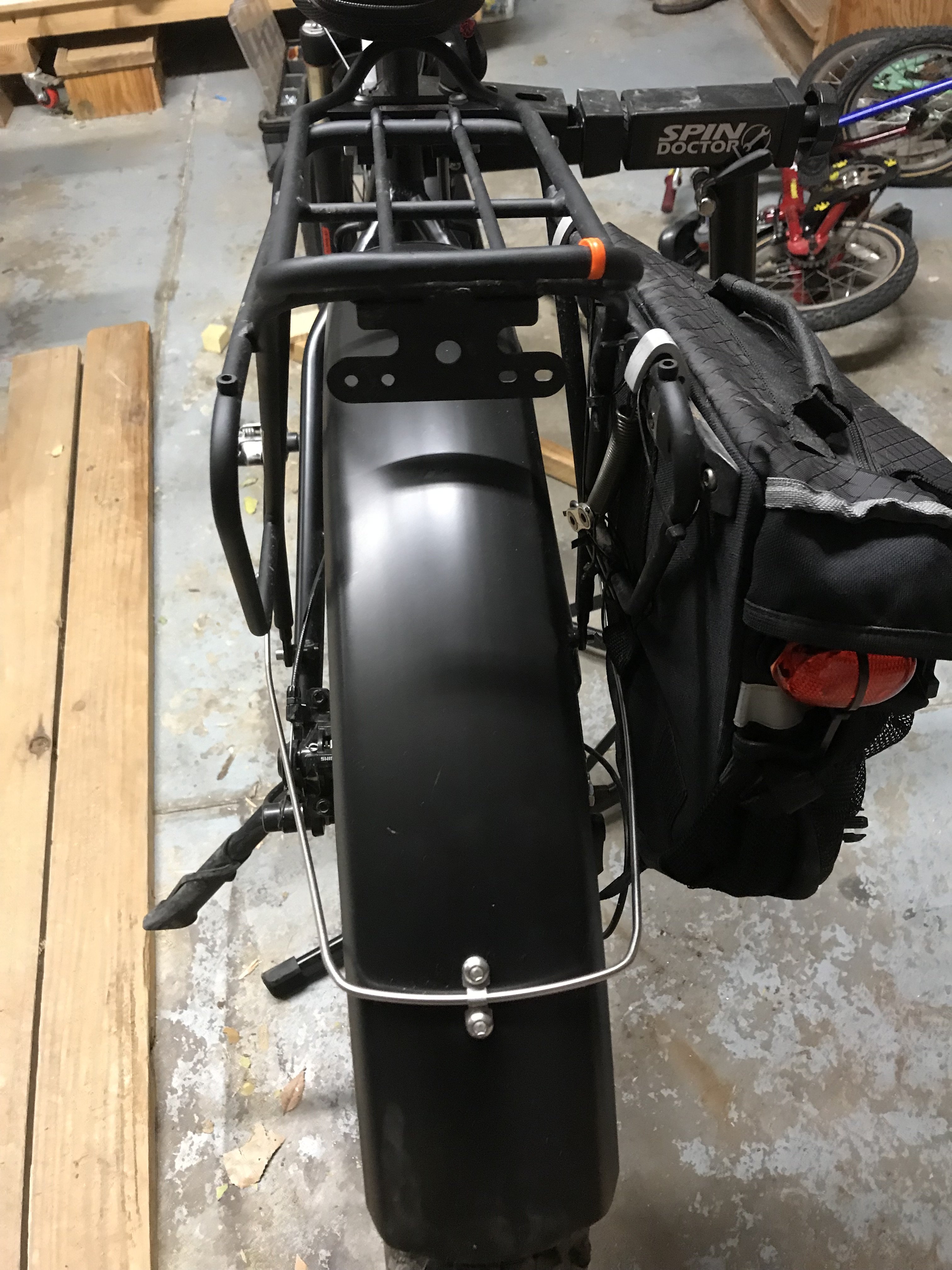

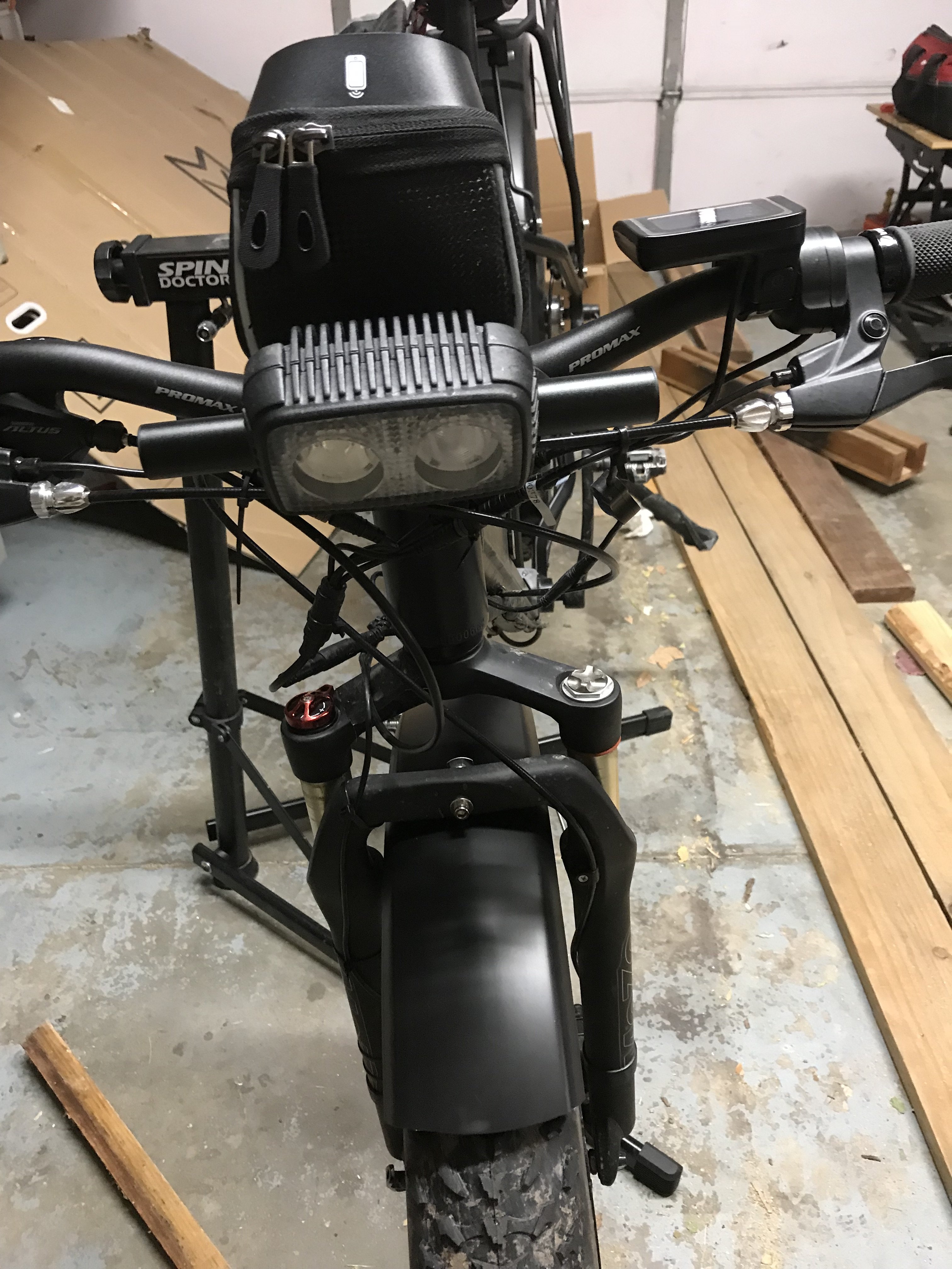

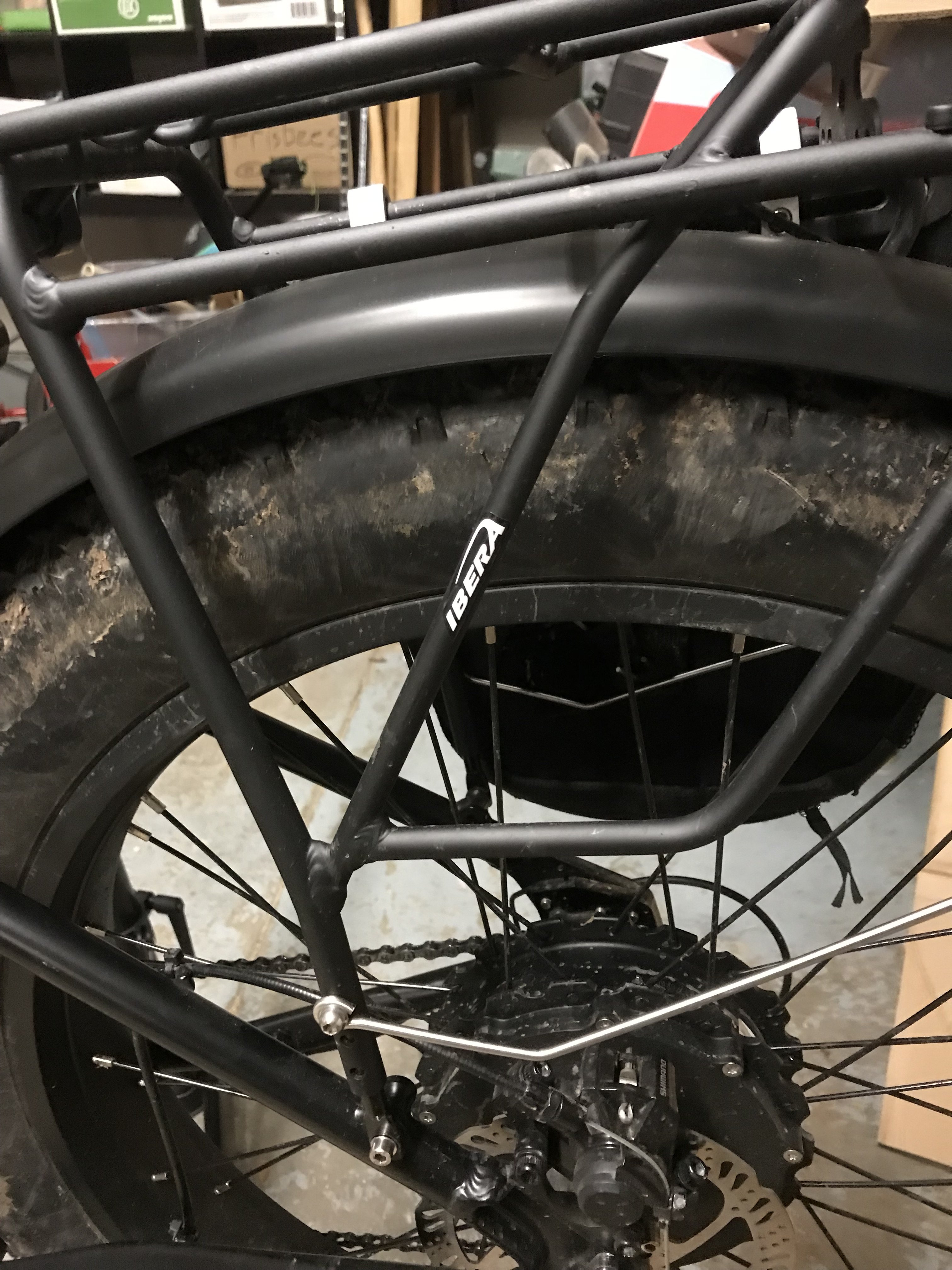

I've got about 100 miles on the bike so far and I'm loving it! I ride most of the time in ECO or 1 since that easily puts me in the mid-20's and helps reduce the battery draw and use. It's cold here now (mid teens) in the mornings and just a little better in the afternoon. Some of the changes that I've made already are an accessory bar that I mounted the light on. I like it up higher. I just drilled a hole through the aluminum mounting bar and bolted it to that with the existing hardware. I also put on an Ibera fat bike rack and it fit almost perfect. Since I didn't need the spacers I had to get shorter bolts, but were easy to get in stainless at the local hardware store. I plan on getting their rack pack with expanding panniers. I also got a handlebar bag to hold a couple of tools and the battery key as well as my phone. One of my most needed adds was the fenders. I got the RadBikes full fenders for the RadRover and they required just a little bit of modification to fit great. The rear wheel is a little bit of a pain to take off since I'm used to non ebikes. For the rear fenders I drilled out the rivets and drilled a hole in the plastic at the right point for the upper cross mount, but that was all. Since I will use this year-round for commuting in snow and rain the fenders will be fantastic.

What model IBERA rack did put on the bike ? Also are you having any issues with your bike such as the bikes power dying after a few minutes and also the bike studdering at low speeds ?
It works great! It makes it much more versatile in the hills and trails. I was able to climb just about everything. Most of the time when I'm on the trails I leave it in ECO and then when the climbing starts will move up the levels based on the hill length and steepness.
