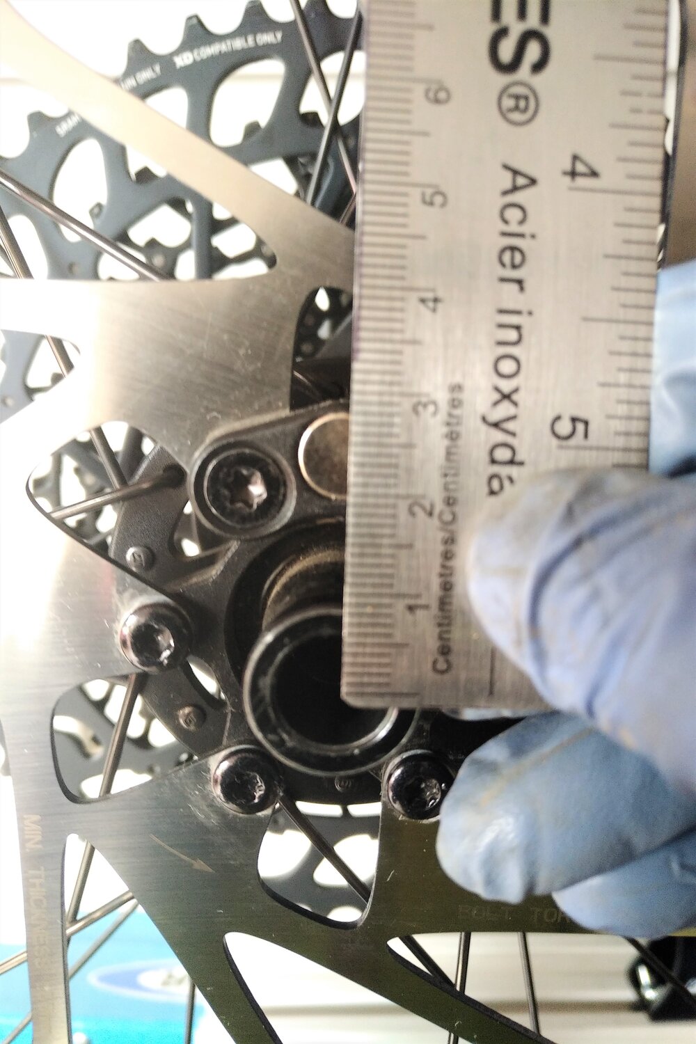

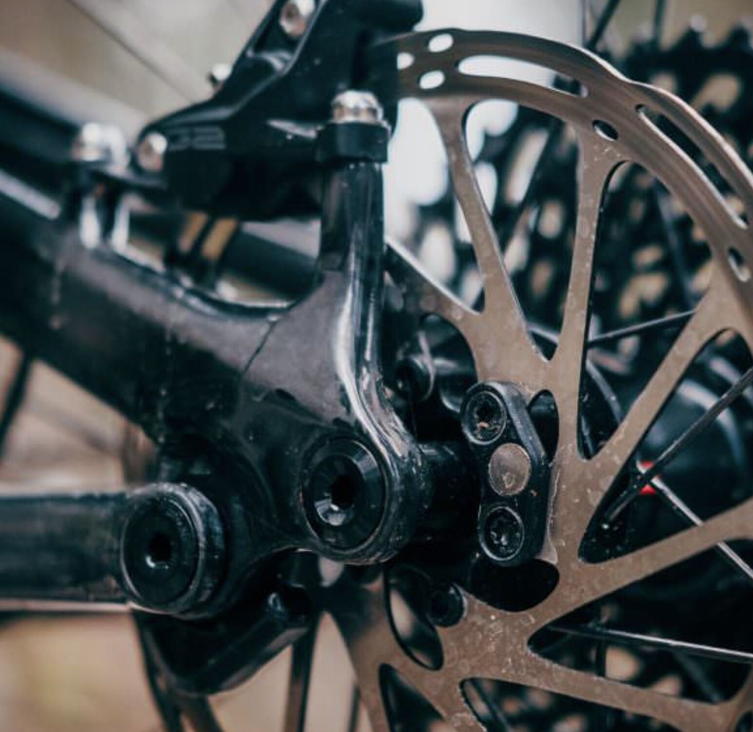

I assume you mean for 6 bolt disc brake hubs and the Levo SL speed sensor magnet S194200016? Looks like it may work but search the Vado SL threads and see if any Levo users have used the Creo magnet to go from six bolt to CenterLock.
the position looks similar - just inside the chainstay, around 25mm from center of axle, but you should probably ask someone with a levo SL to measure...

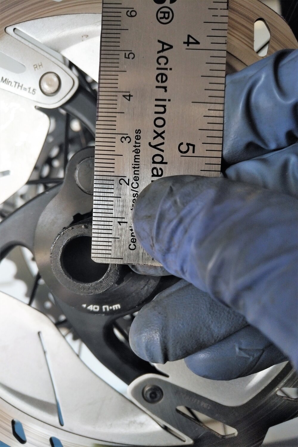

Unless I’m mistaken, the measurement for the Creo from the center of the axle to the center of the speed sensor magnet looks to be 20mm.
For the Levo, it's closer to 25mm.
I can’t say definitively if the difference would be out of tolerance enough to throw the Creo’s readings off or if it would even register. I suspect that it might be fine and that there should be sufficient clearance at the chain stay for the Levo magnet.
Sounds like it may not read the sensor correctly if there is a mis-match.

yes, with the correct parts ;) the discussion above is about using the levo magnet holder on a creo… it’ll be misaligned by 5mm or so!
Not sure how different the spacings will be between the Creo and a Vado SL. But eyeballing the gap between the center lock SL magnet and the sensor housing appears to be < 5mm. Quick comparison between the 6 bolt Tero magnet and the SL magnet, I'd agree the 6 bolt magnet appears to be a bit further out. I think the Tero and Levo rotor/magnet distances are the same - rotor bolt pattern is standard and Spec only listed one replacement magnet set for the 6 bolt setup. If the Creo has a similar small air gap between the magnet and sensor, I'd be wary that a Levo magnet might be too big and possibly hit the sensor.
I have run wheels with both 6 bolt and CL rotor and the magnet has never been an issue. It is bolted in place by an allen key and can easy be moved if needed. With regards to wheels I use MTB Boost wheels 148 x12 rear and 15 x110 front, but with a 15mm to 12mm sleeve fitted. Done thousands of miles like this with no issues. I found an awesome set on Newmen Wheels from Germany that are sun 1300g for the pair with hookless carbon and half the price of Rovals
This....direct from Specialized....also mentioned in the Creo FAQ about tires and wheels the the Levo magnet will work when used with the 6 bolt disk mount on the Creo....Make sure you get the latest magnet....there was an earlier one that appears to place the magnet ever further away from the center....I think pre 2019.... use part # S194200016 as stated below....Got mine at Performance Bicycle for 12 bucks...
