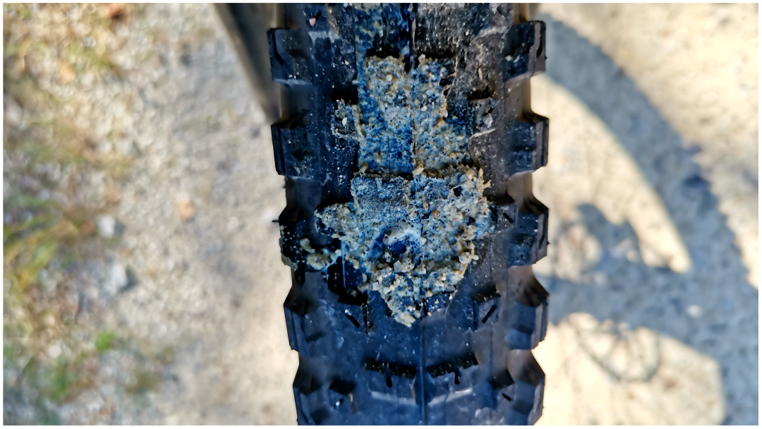

@reed scott: One of my e-bikes is equipped with tubeless wheels. I have mixed feeling about the concept. Last August I rode into a gravel road made of extremely hard and fine rock. A small shard of rock punctured a 2.6" thick tubeless tyre. The sealant was actually gushing through the hole, making the whole front of the bike dirty and difficult to clean (but that was just an aside). I was able to return at low tyre pressure to some civilised place. Meanwhile, the sealant did its work and the puncture got self-repaired (I had no tubeless repair kit with me). It was enough to re-inflate the wheel and I could continue my long trip.
Sealant attempting to do its work on the ride I mentioned. It eventually worked OK.
However, such fix is temporary. After returning home, it is basically necessary to remove the tyre (and pour any remaining sealant to a vessel); the rim tape should be replaced with a new one; the tyre is the best to vulcanise, replace on the wheel, adding fresh sealant. It is indeed a dirty job.
Benefits are the possibility to ride in rough terrain at low inflation pressure and the self-repairing capability (especially if one carries the repair kit with them - no need to remove the wheel). I reckon it is often easier to use a regular tubed wheel and just replace the inner tube on the ride...
