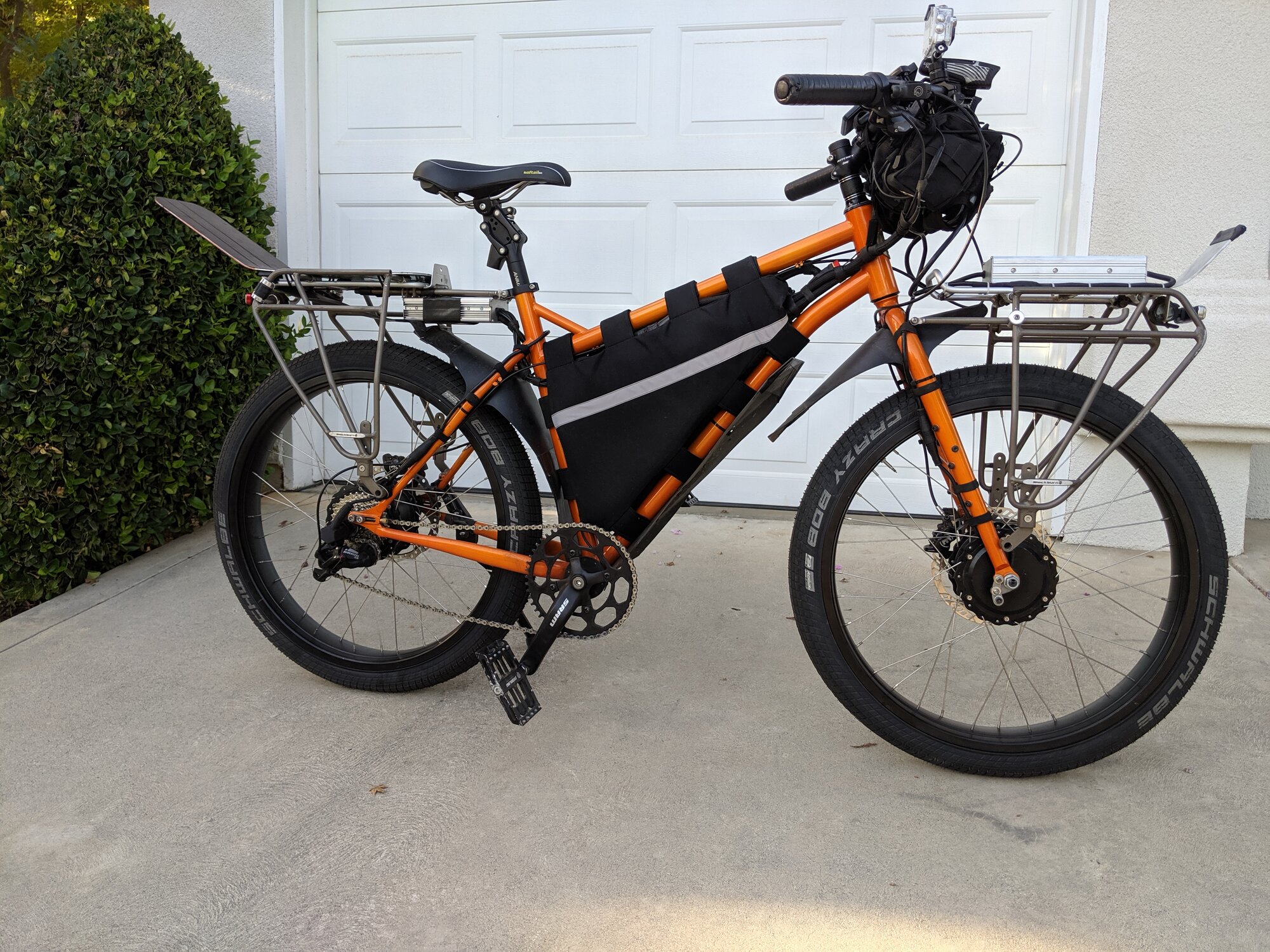

Ignoring the charts, if you have 60mm rims you can go all the way down to a 2.5" tire, although that is well below what any chart is going to recommend. Lots of people have done that with fat bikes who, for example, are looking for a shorter bike to fit riders of smaller stature (i.e. their wives). I did it once years ago looking for faster rolling wheels and I got that, at the expense of ride comfort. The ride on a 28 mph bike going over potholes was so rough I feared for the frame in the long term... and my spine. That bike had 80mm rims (75 internal) so a 2.5 was a big misfit. I would have never done it except I had seen so many others do it I knew it was safe. You need an oversized tube (undersized for an 80mm rim) to spread the tire and let the bead seat, which it will do happily and without future failure.
So... in this pic these tires are actually 2.35" on 80mm rims. So you see why I say 2.5" on 60mm is perfectly do-able. I believe I was using 3.5" tubes inside yes I really had a sidewall.
