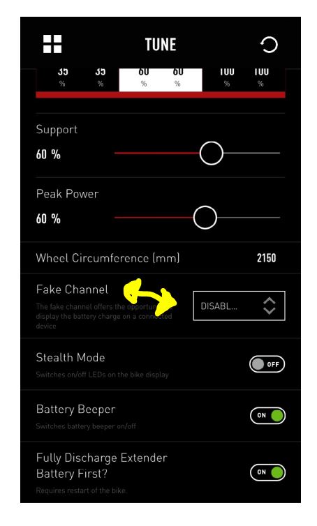

How to disable fake channel in Mission Control?
I just got an email back from specialized rider care and they confirmed that they removed the fake channel from MC. They also said that the loss of battery level and support level in the Ride app is “a known issue” and they will work on it.

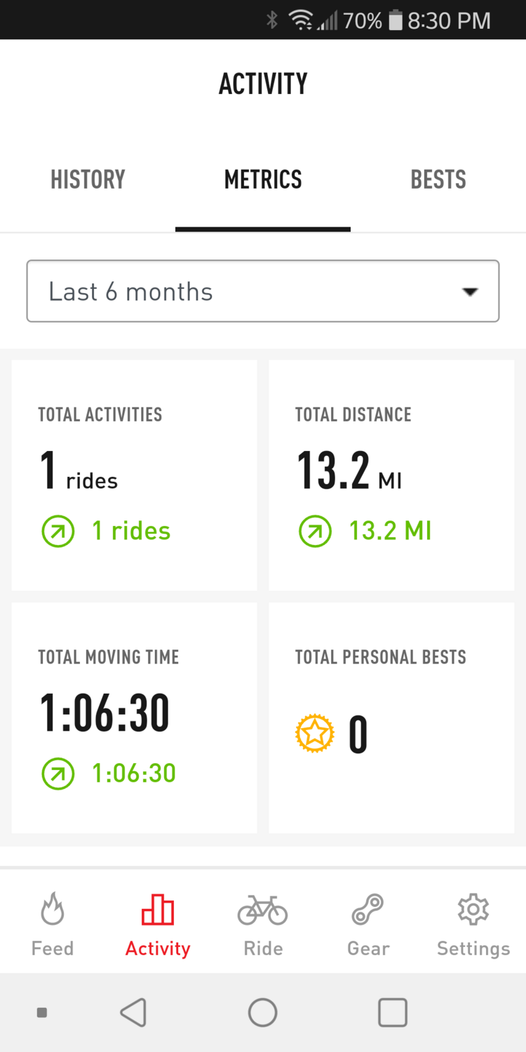

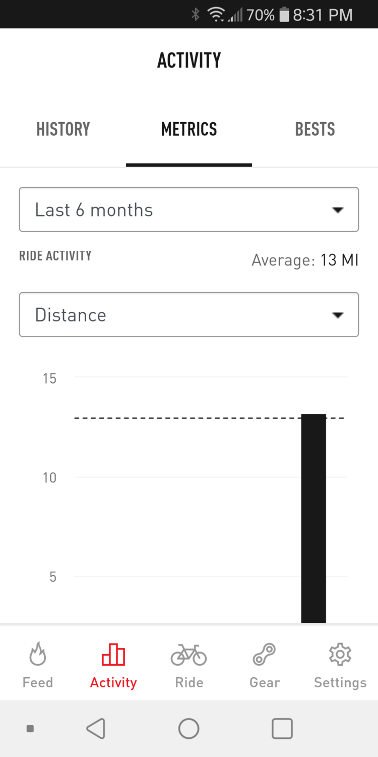

All I see in the Ride app is - under Metrics - Total activities, ride distance, total moving time, personal bests, then, under Ride Activity a bar chart showing my average distance,(or, selectable-moving time, ascent, or calories. Power - a horizontal line chart with a green dot with Average power, or max power selectable. Speed - a horizontal line chart with a blue dot with average speed or max speed selectable. Cadence - a horizontal line chart with a red dot with average cadence or max cadence selectable. And that's it. No info about battery power or rider power.
The first page shows my route and distance, moving time and ascent. No info about mode I was in.
I am not sure how useful Ride is.
So, I will be buying a GPS. Any thoughts about model, and app to use to display the data in a useful manner?

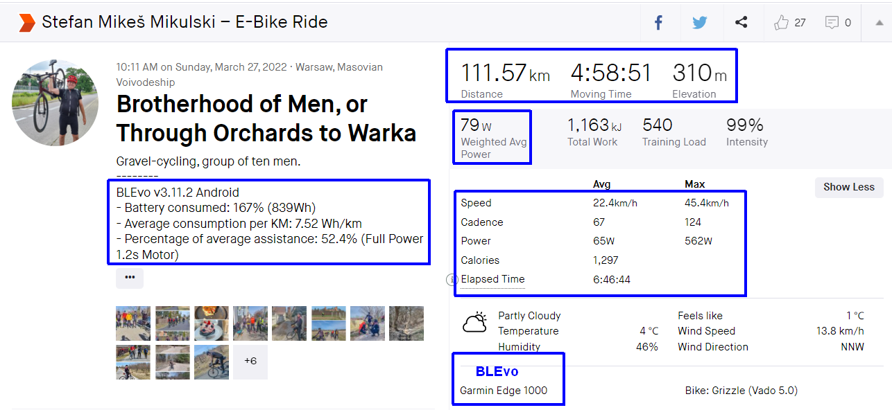

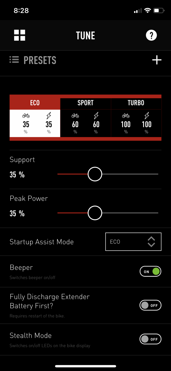

BLEvo is far more than the MC. I only use MC to tell my Vado SL, for instance, to "Discharge the Range Extender first" or set the "Stealth mode". There are very few things BLEvo cannot do it but there are far more things MC cannot do.

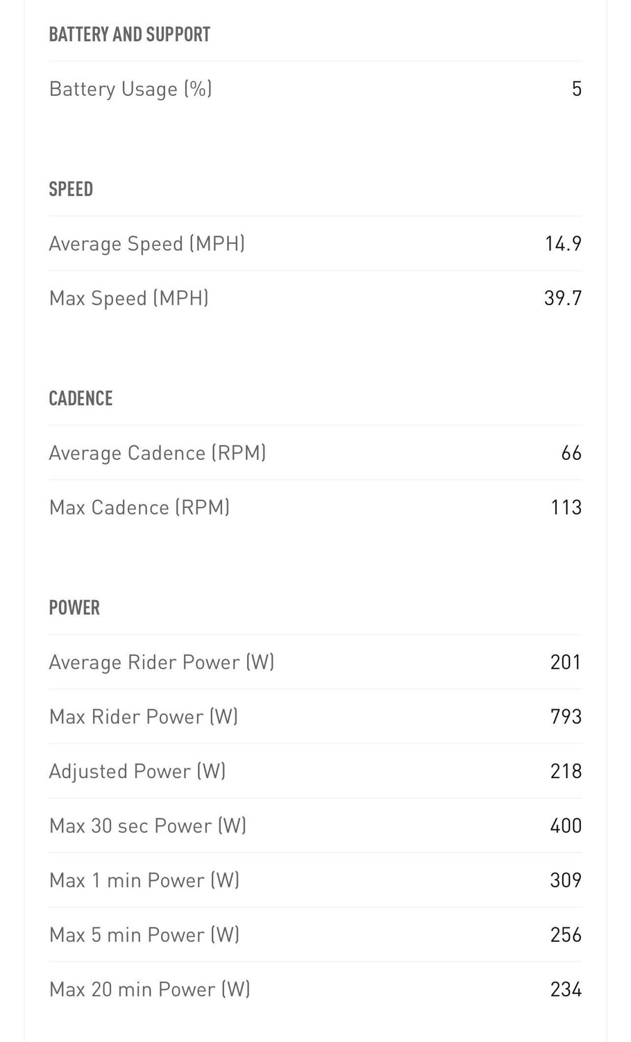

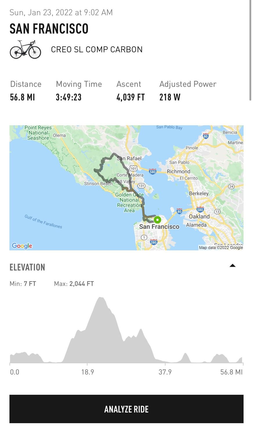

this is a selection of the screens i see in ride for an activity:
are you definitely logged into mission control and ride, you have an account, etc? not really sure what else would cause the data to not show up. maybe send a screenshot?

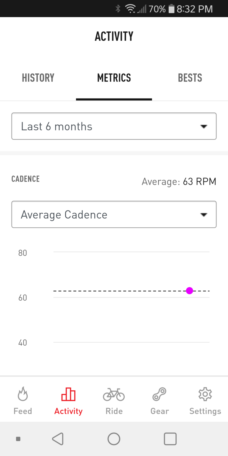

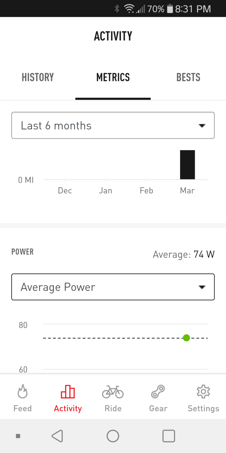

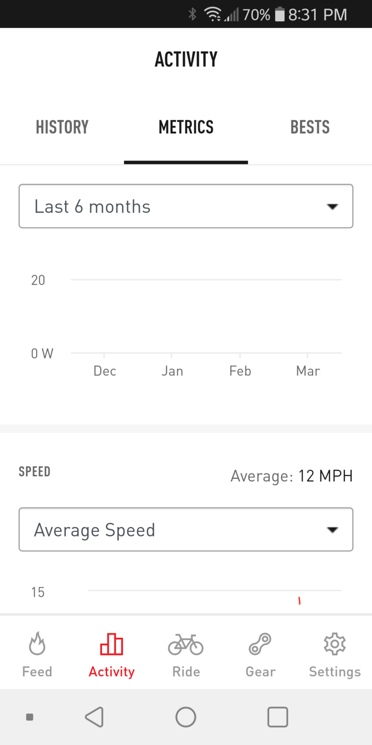

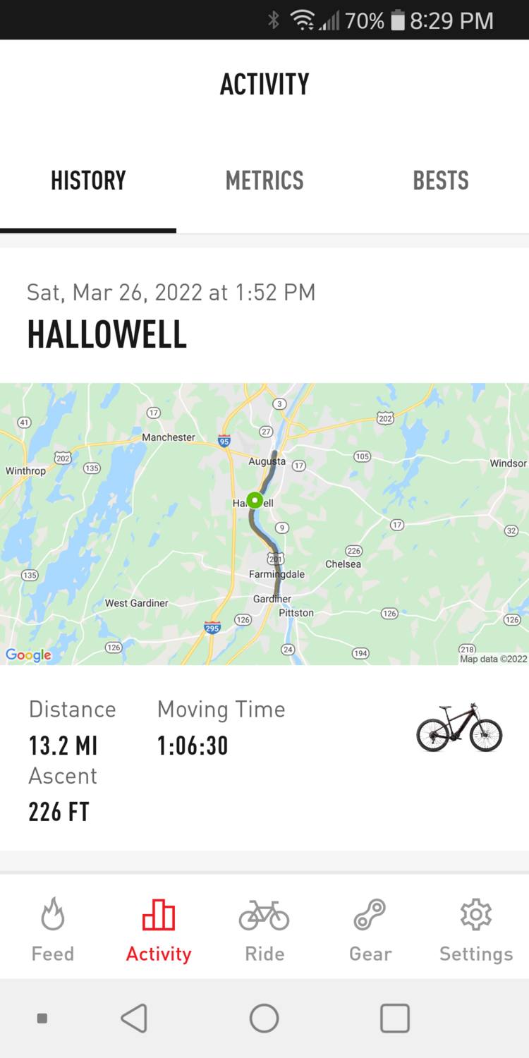

I am running Ride, App version 3.7.19 (148519) on an Android smartphone running Android 9. Here is what I see when I select the History tab.
Here is what I see when I select the Metrics tab

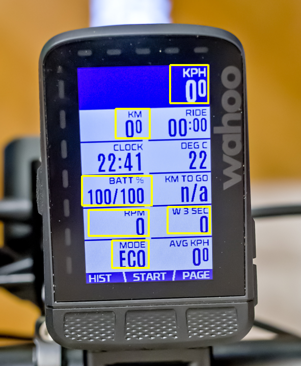

Here's my practical selection:
such as Ebike Edge Multifield or the Ebike applications by Jan Cepek
The beauty of newer Garmin Edge computers is they only need to connect to a single E-Bike Sensor, and any third-party Data Fields are not necessary and confusing. My brother who rides a Giant e-bike and owns an Edge 530 has deleted the E-Bike Multifield, and has just composed his data screen from available Garmin fields that include e-bike specific data, same as Wahoo.
Many thanks for the detailed info. Looks like most of those fields map to similar fields on the Garmin 830.
My main hope is to capture rider power output vs bike input, as well as the usual speed/cadence/distance/etc stuff, and while it seems there's not a quantitative figure for bike input that's okay; assist mode should be sufficient for me. I guess I've just always been a data geek - I was using an audio interface to upload Polar RS200SD running watch data fifteen years ago. :)
It is reassuring to see that I ought to be able to easily get all the data I care for - and without really doing anything different from my non-e bikes.

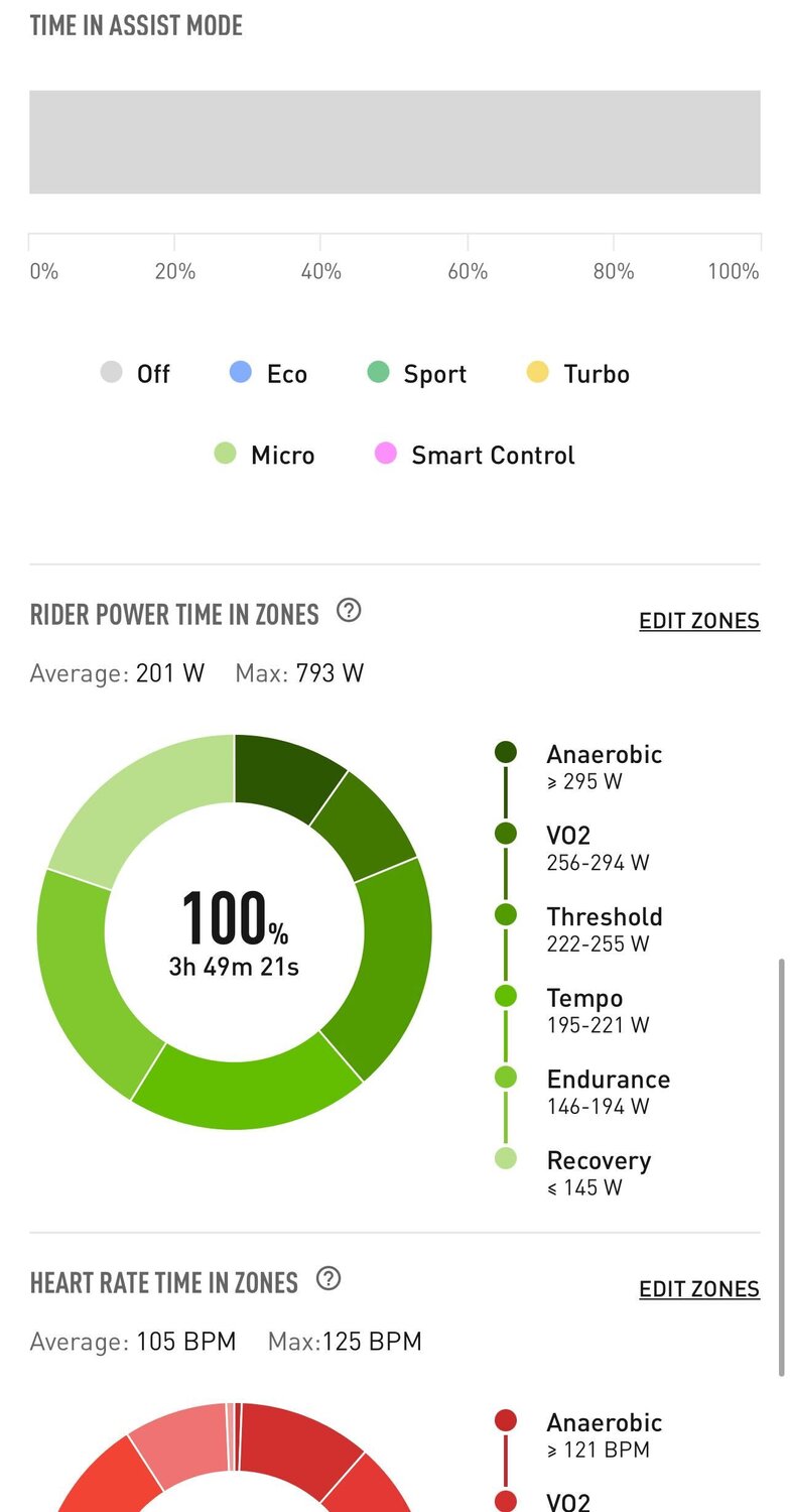

but the "time in assist mode" chart is broken and the "battery and support" fields under "ride details" are missing. when i look at older rides, that data is still there, and the chart still works.
I did a ride this morning, recording it in both MC and RideWithGPS, just like I have done every other ride. For some reason I can't explain, BATTERY AND SUPPORT and TIME IN ASSIST MODE are displaying in Ride today. The ride I did yesterday, recorded in exactly the same way, did not show with of those in Ride. Weird! I have no confidence that the next ride will properly display those two data fields, but fingers are crossed. (Like @mschwett much older rides do display these fields.)
given that the data goes from MC up to specialized's cloud and then back to Ride, it's entirely possible that they fixed it, or are fixing it, or it's an intermittent bug caused by something on their end.

I used MC on my ride yesterday and Ride did show battery level and the time in assist modes chart again. Seems like the IT techs at Specialized did sort out the problem. I’m glad to have that data back. I had asked Ride tech support a few months ago if they would add more ebike data functions in future updates but the reply was that Ride is intended for their smart helmets and they weren’t going to expand it.
