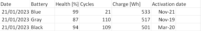

I am the first owner of a specific e-bike. The first battery was activated on Nov 1st 2019.
I am in the position to be able to measure the exact status of my batteries. Each of these batteries shall be 604 Wh freshly after the activation. Neither of them was with the "black" battery being the most hopeless, and the "blue" battery coming next.
How comes a 604 Wh battery (nominal) with health of 99% can only hold 533 Wh remains a mystery to me.

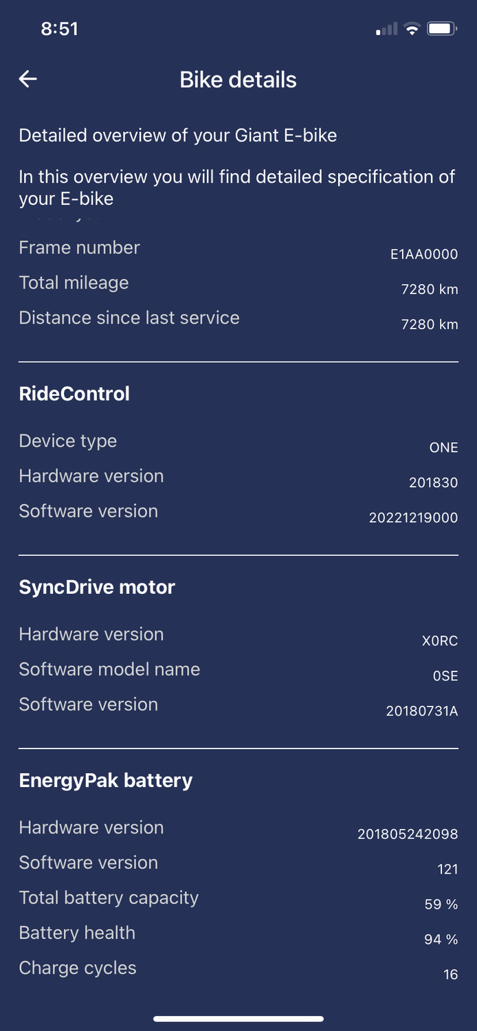

I have a 400Wh and 500Wh batteries for my 2019 Explore E3
I believe the 400Wh was manufacture at 201809, that's what the hardware version indicate. It has 67 cycles and health hoover around 91% to 93%
The 500Wh has a hardware version 201803, so I suspect it's manufactured in 2018 March. It has 7 cycles and health is at 94%.
From what I heard, Giant uses Panasonic cell, and it supposed to be good for years if you take good care of it. I usually just charge it to 90% instead of 100%. I don't think I have ever drained the battery to 0% since I purchased the bike back in 2019 Sep. However, I bought the 500Wh battery from a guy who has his bike stolen (who showed me the receipt to prove the battery and the charger aren't not stolen), so the battery might have been sitting at 0% for awhile before me.

Check it out, this battery prob manufactured 5 years ago, but still have 94% health as of this morning.
... but you only have 16 charge cycles on it. that's as much or more of an issue than calendar time. if you are constantly charging to 100%, waiting a few days to ride, and then discharging fully, you'll go through a hundred charge cycles in a year and both the deep discharge and fully charged storage time will be a major hit to life.
on the other hand, if you charge to 80% and then ride it in a month, repeat 12 times, the battery will likely last many, many years!

That makes sense with the given number of recharges. Giant does not specify the effective battery charge though. I would say that would be more closer to 400 Wh than to 500, how do you think Dave?
