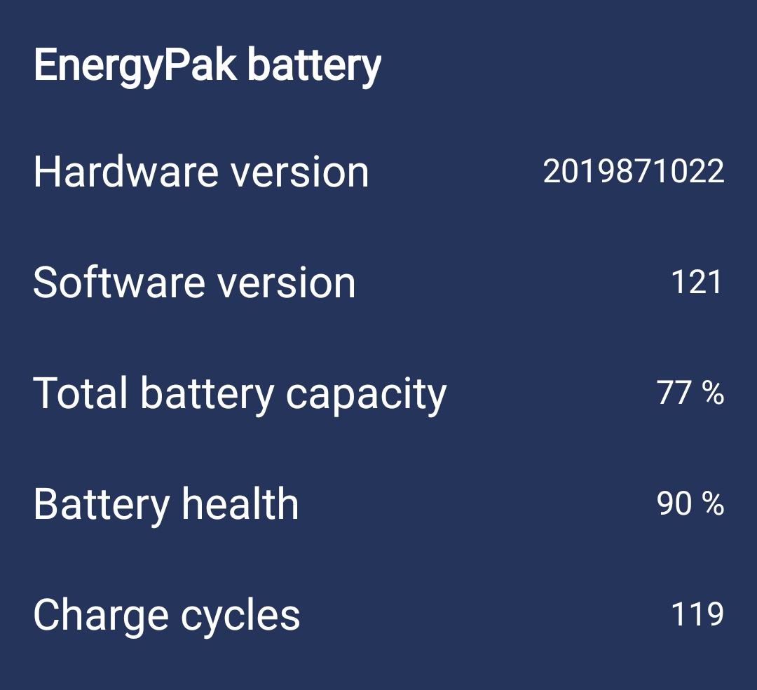

Mine seems to have settled on 90% the last few cycles, more than sufficient for any ride I throw at it.

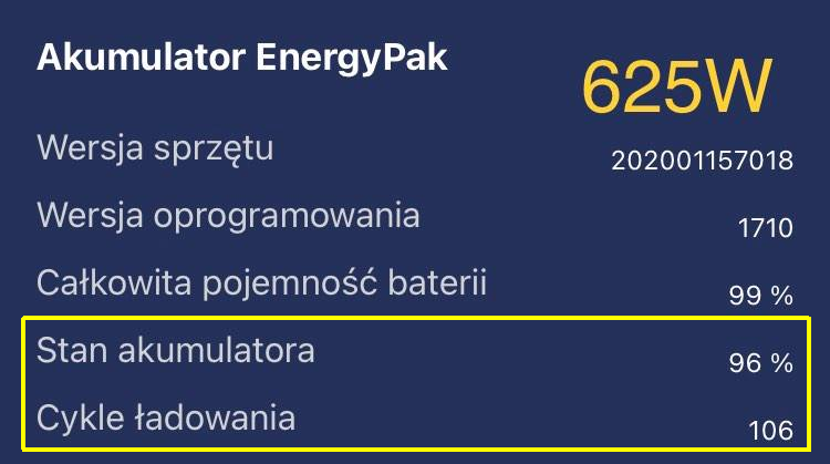

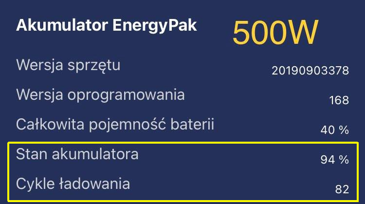

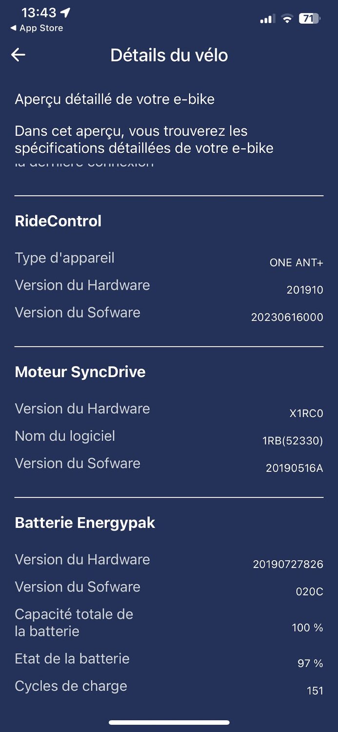

151 cycles!
I'd be interested in what y'all think. How much longer?
I also have a brand new 500 w/h one also and I alternate.
