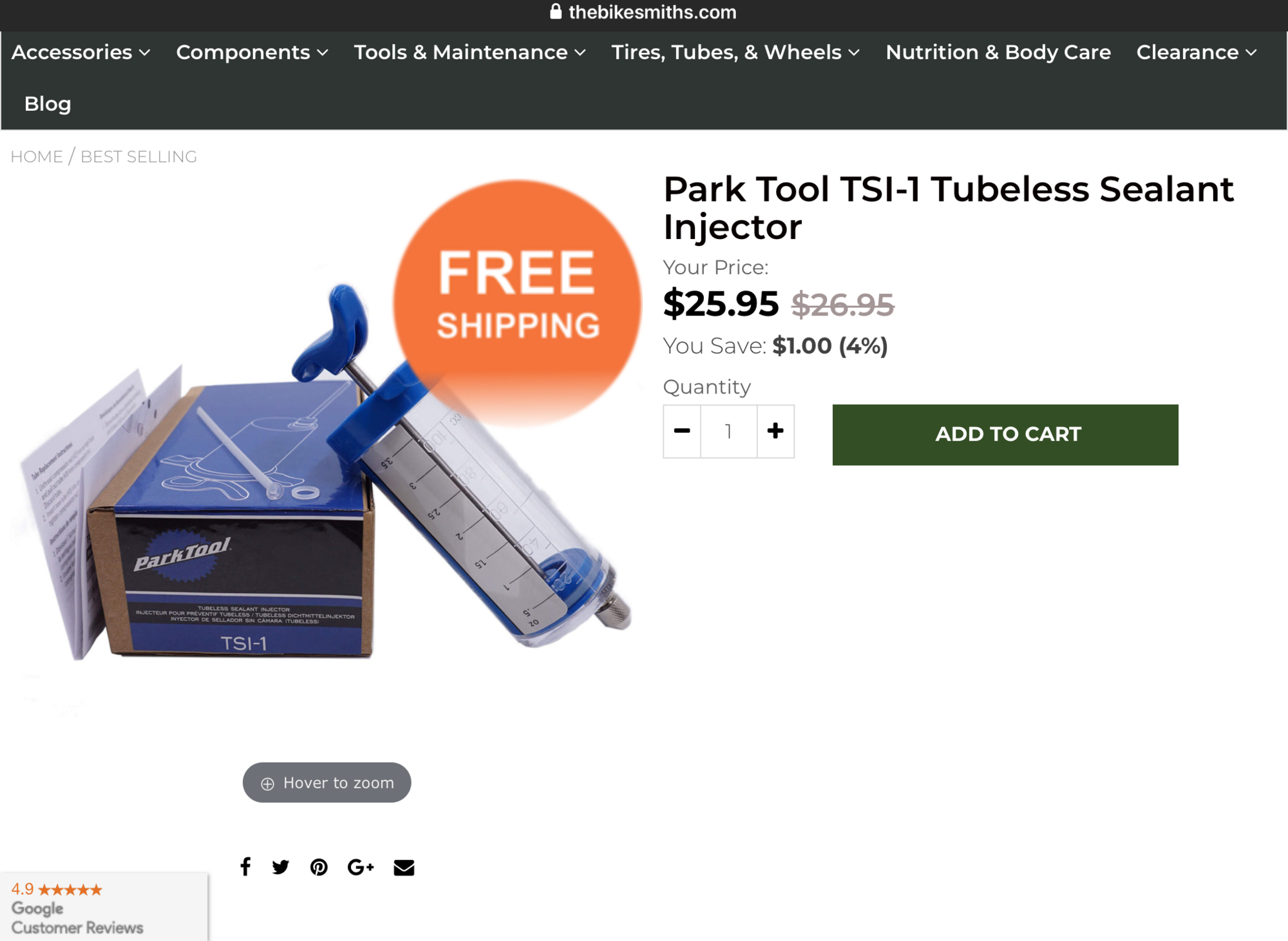

Is there another tool suitable for tubed tires?
Park Tool TSI-1 Tubeless Sealant Injector
30 years of refusing to use. An old dog can still learn...

As far as getting it in to the tire, I don’t know why you’d need an injector… remove the valve core and just pour one of those two ounce bottles of Stan’s in through the valve stem. The tip of the bottle fits nicely on the stem (assuming Presta here), then screw the core back on and pump it up again. No fuss, minimal muss.

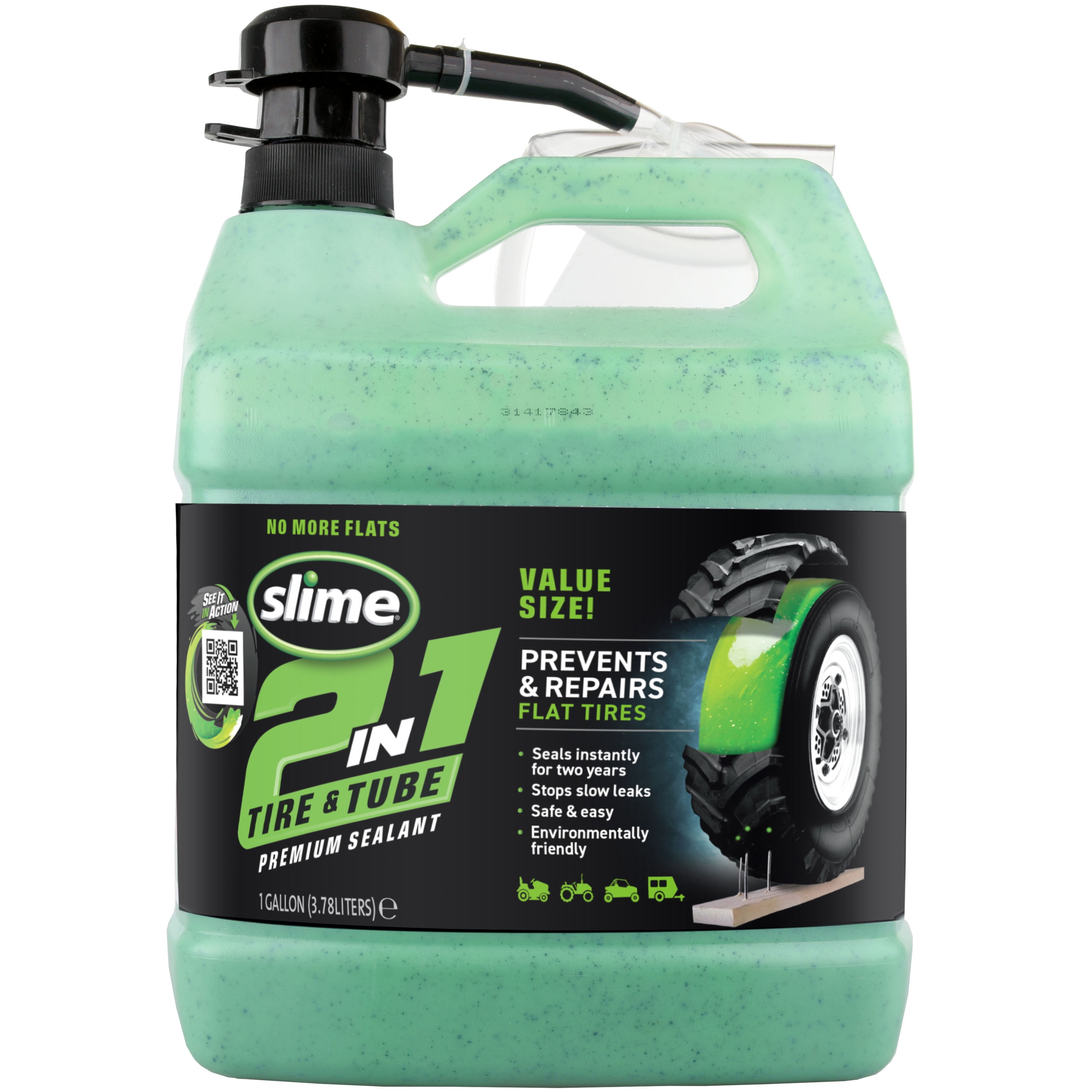

I buy Slime in a gallon jug. With 6 bikes and many tractor implements which have pneumatic tires, I use a lot of the stuff. It's much cheaper in quantity.
The gallon jug comes with a pump that dispenses one oz. with each stroke.
It's convenient to use but it's important to clean the injector tube after each use.

For my tubeless set up, I use a disposable 25 ml syringe and a blunt drawing up needle - they are cheaper from the vet than chemists , and my current supply are all ( used) horse ones - so far stans plays well with penicillin. They get a bit grungy after about 12 months (10 tyres in a 5 bike family) , so I throw them out .
Theoretically this would cost about the same as that park tools syringe after 10 years IF we ever get rid off the horse....but for now the stupid creature seems dedicated to giving me a lifetime supply of syringes.
