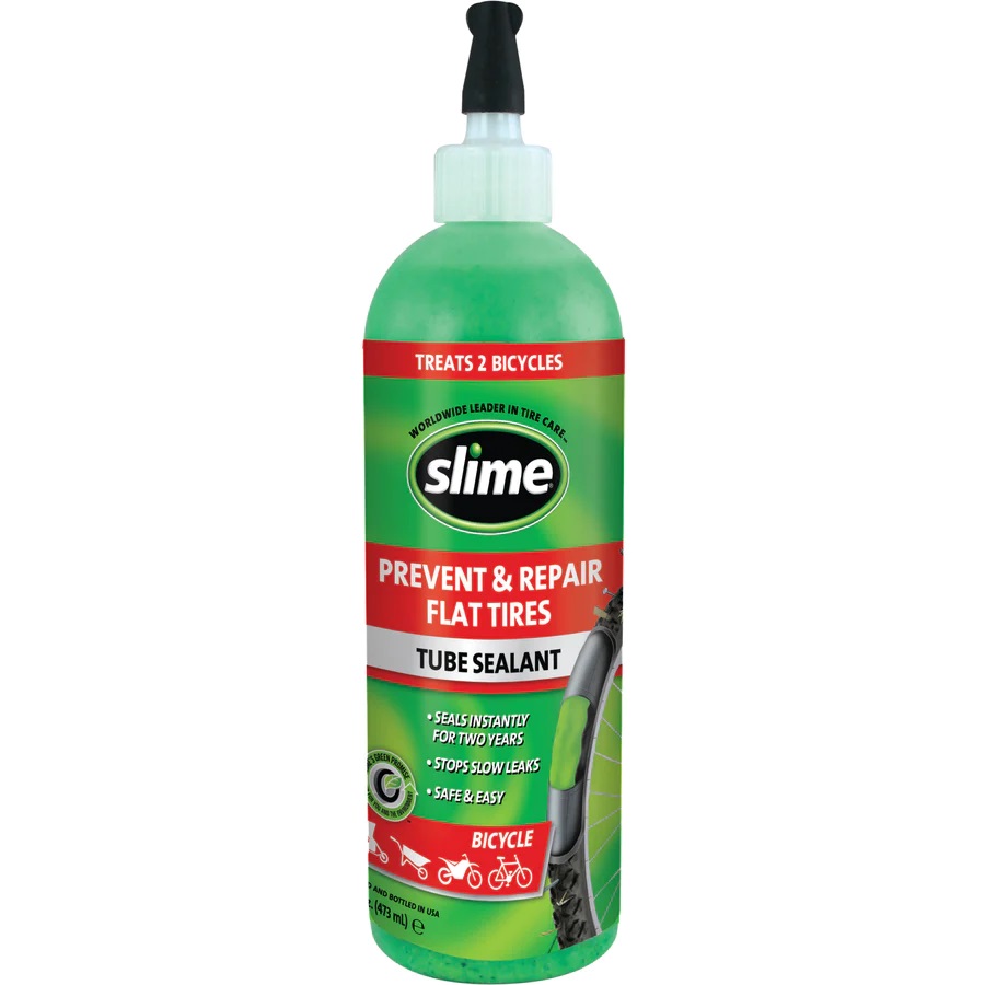

Green slime are great inside golf carts.
Not for my bike .
Can you show photo a bottle of green slime? I will tell you if that is okay for ebike
That's not correct, at least regarding Slime. In fact, Slime has a product for tires with tubes and another product for tubeless. I don't know what Slime 2 in 1.
I'd pull the tack, or whatever, if I could get at it, but I'm also prepared to fix a flat or even replace the tube. I haven't had any flats though since I started using Slime.
TT
The Slime 2 in 1 description from the Slime website. Of course it's All Sell but the basic take away is that it works for both applications, Tubeless or Tubed Tires.
I have used this on my non motor bicycle and still had frequent flats. I think it's only recommended for tube equipped tires.
The other thing I don't like about it is, it sealed the valve on my tires. Took me awhile to figure out that the valve was seized. I thought my pump was faulty.
