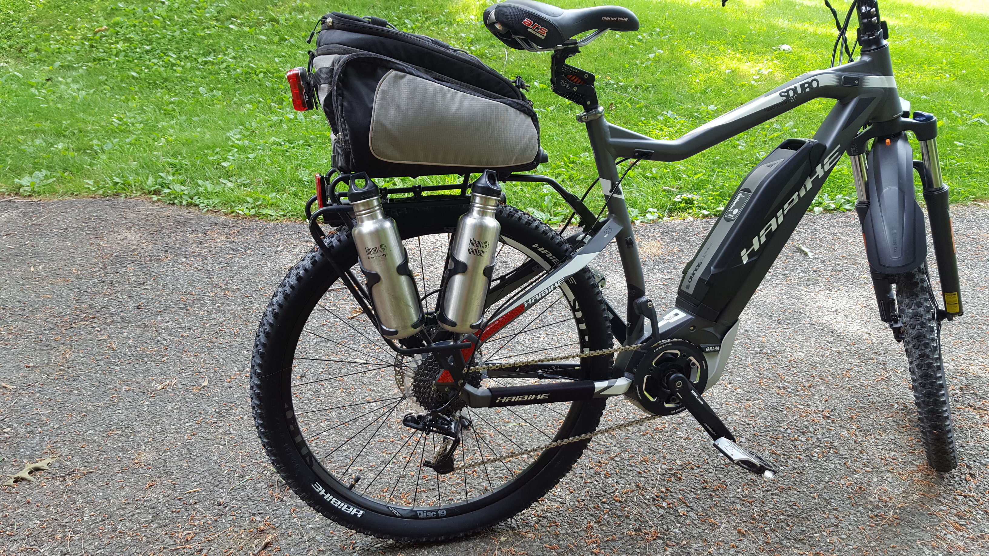

How do you carry water when you ride your Haibike?
This is my solution for water.
That's a pretty fancy setup you have there!
Can you share some closeup shots of the bottle mounts?
Here you go Ravi, First, here
's the hardware. pretty basic: a few metric bolts, washers, and lock nuts. The clamps are insulated and can be found in any hardware store in the electrical dept.

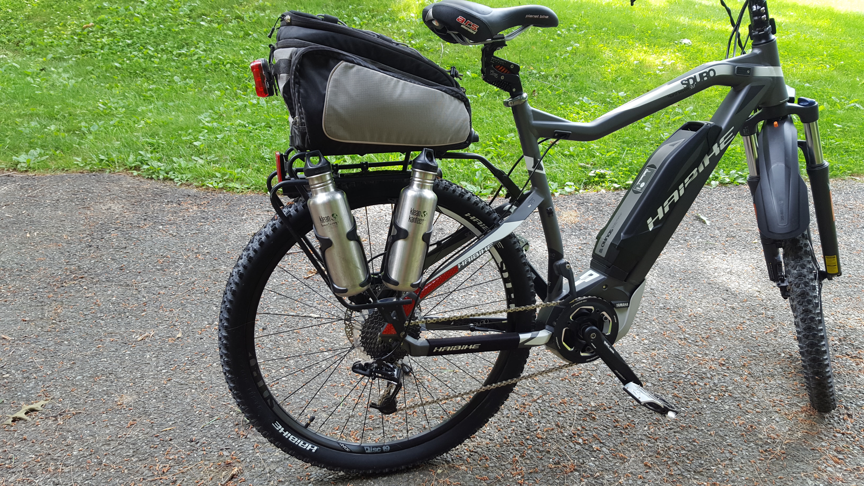

Here is the same hardware mounting the pump
Here is a shot of the fabricated forward rack mount. because there are no rack mounting holes in the seat stays, I used the fender mount bolt location under the cross tube. a piece of 3/4"x 4" square aluminum tubing, a fabricated steel bracket and some bolts with locknuts . so far this has worked out real well.
