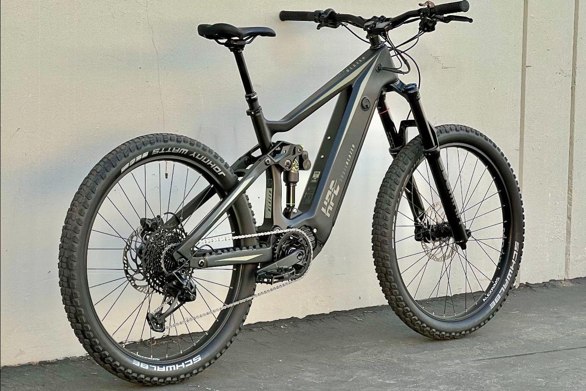

HPC has their Maverick bike coming out soon. It has an Ultra motor with a max power of 3000 watts. They MIGHT be a source for high power replacement motors if they will sell the motor by itself. They may make it only available on a complete bike.

I just ordered a HPC Trailbazer. I got the frame kit which includes the frame, motor, battery, front suspension fork and rear shock. The fork is the DVO Onyx and rear shock is the DVO Topaz Prime. This is going to replace the gold WW Hydra I had. I’m taking all the parts from it and installing them on the Trailblazer. Specs are 1800w and 52V 17.5AH battery. It’s down on power compared to the Hydra but in this case I think that’s a good thing. You can also get a 750 or 1200 watt version. HPC has been around for years and even has a defense line for the military. Bikes and batteries are made here in the USA. Pricing is in the area of WW. Just waiting on it to be delivered.
