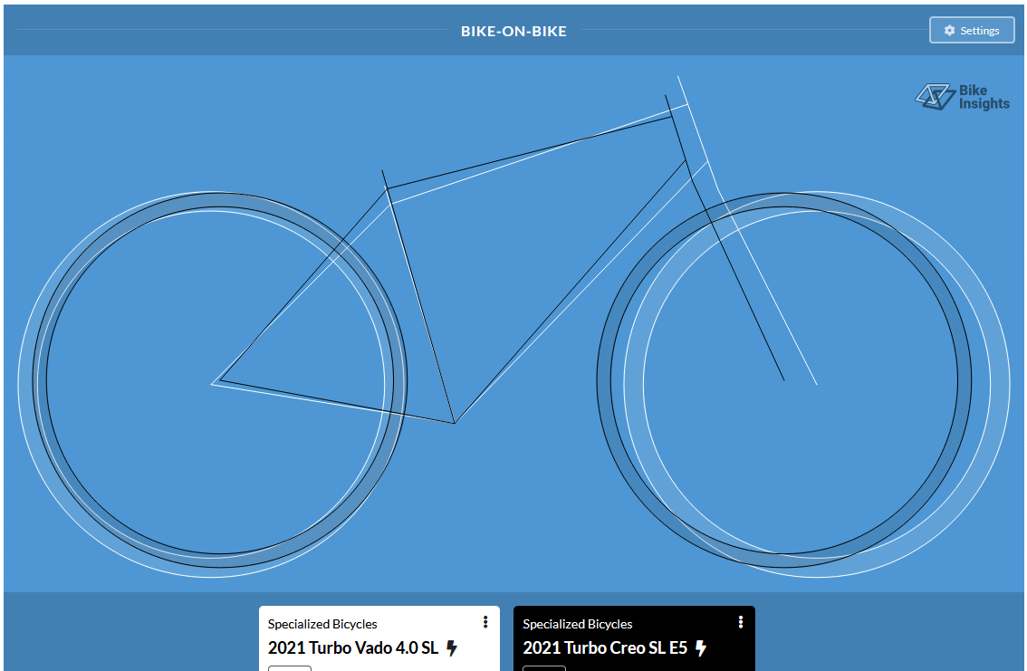

@radiant3centaur there's a bit of geometry differences beyond just the handlebars. Check out this site for numbers, and then this site for the graph below. Ride the Vado SL and consider if changing handlebars (and perhaps stem) would really have any true change in your ride posture.

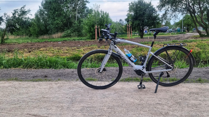

I'm afraid you cannot recover the bigger share of the cost you put into the Vado SL as the market is now full of new e-bikes. (I could see an interesting quote here in Poland: a person was selling an absolute legal -- not stolen -- Vado SL 5.0 with low mileage for a fraction of the original price). To save your family life, I'd suggest to wait to see whether Specialized would not release the new Creo, the one with the new SL 1.2 motor in the coming months.
You seem to be a self-aware road cyclist. I was considering purchase of Creo EVO as a proper gravel e-bike in the Autumn of 2021. As a non roadie, I disliked the Creo (the drop bar was not for me!) Moreover, the utilitarian aspect to keep the Vado SL won. I simply needed an e-bike with a rear rack for grocery shopping, and for carrying multiple Range Extenders in a pannier for my long rides. As I had already owned a Vado SL, I put all my effort to "gravelize" it, and I think I succeeded at that :)
Just shudder to think I could put narrow tyres on my Vado SL! :D
