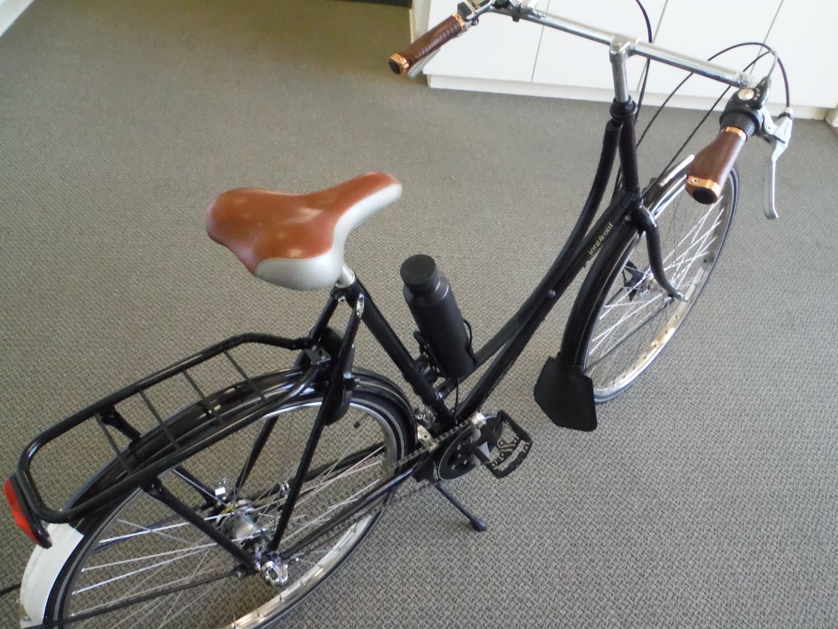

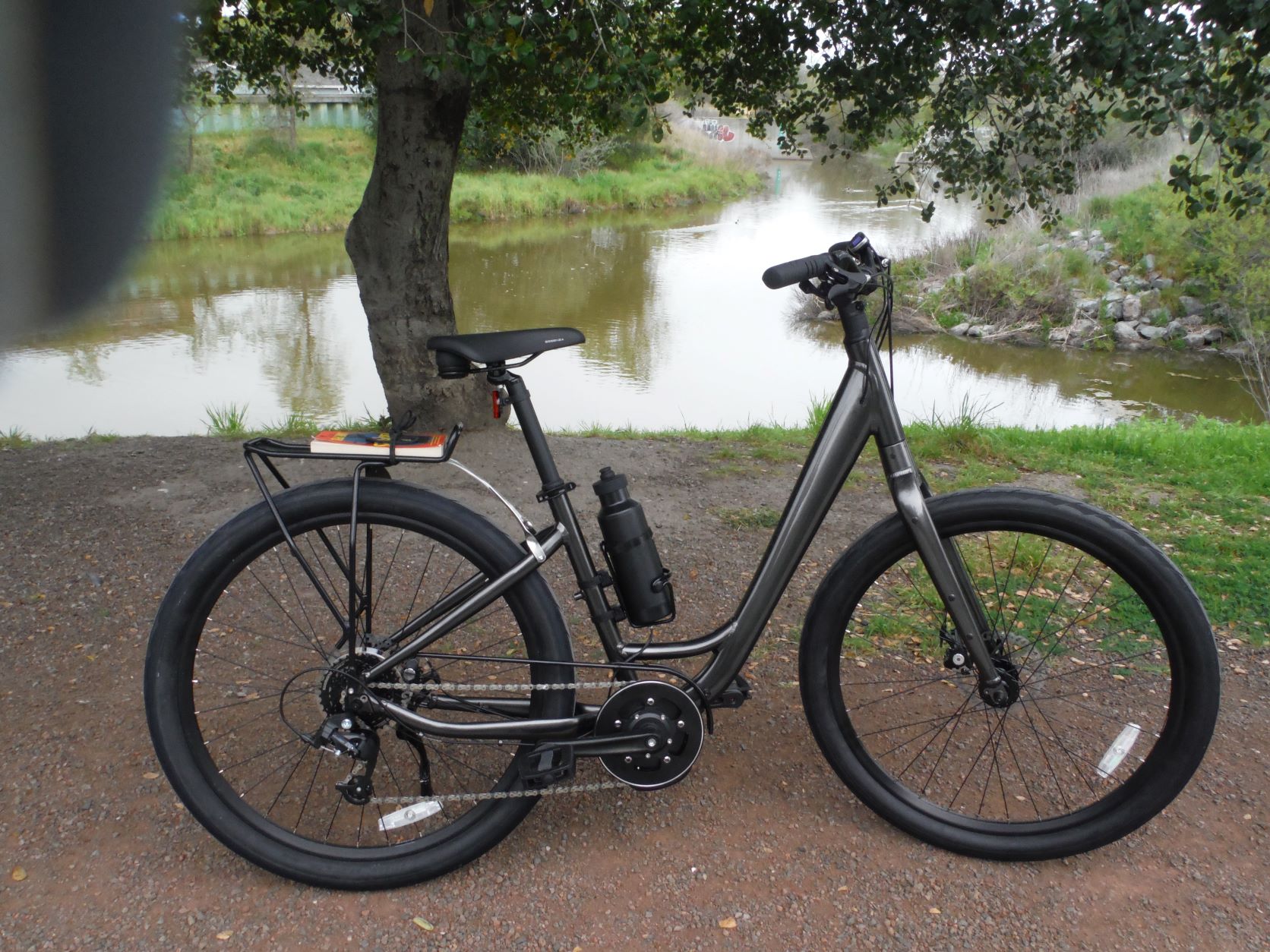

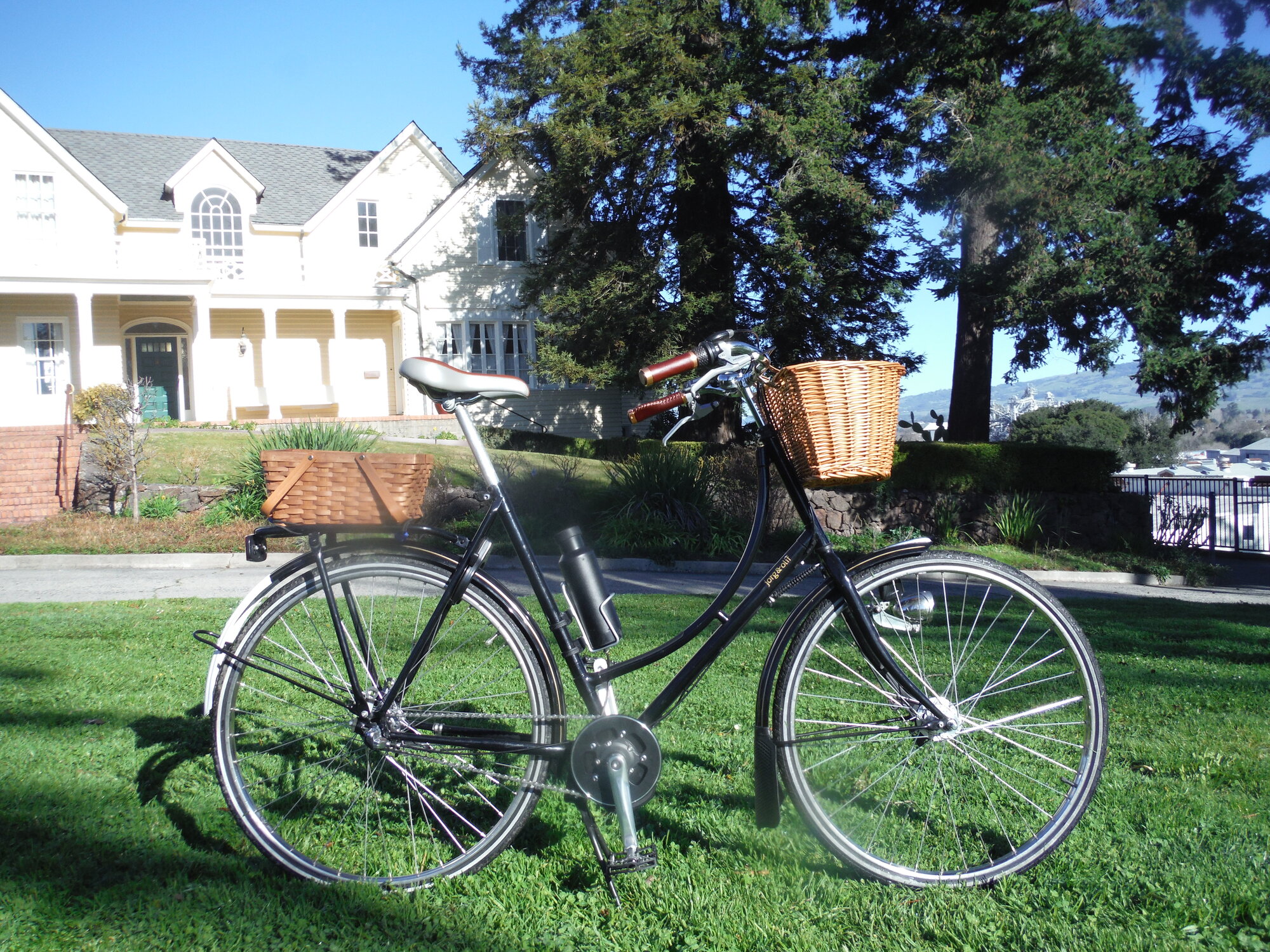

Here's one that @PedalUma built... is that what you had in mind?
That pink Public one has gravel tires so it can go more places. Those WTB tires on it have hard compound at the center and soft nobs at the edges. I have a small Giant Momentum Vida that has not yet been converted. It is not a Pashley. It is an advanced computer cad generated with a superior step through frame design. Here are a couple of them in Mediums, mid-drives, not Small. And here is a Dutch bike I made electric that is like a Pashley Princess. It blows away $4700 bikes. Someone handy in you neighborhood could do this for you.
PedalUma, do you really think someone with no experience in bike maintenance, or a lot of mechanical and electrical aptitude, could rely on a home built bike built by a neighbor? I'm doubtful...
