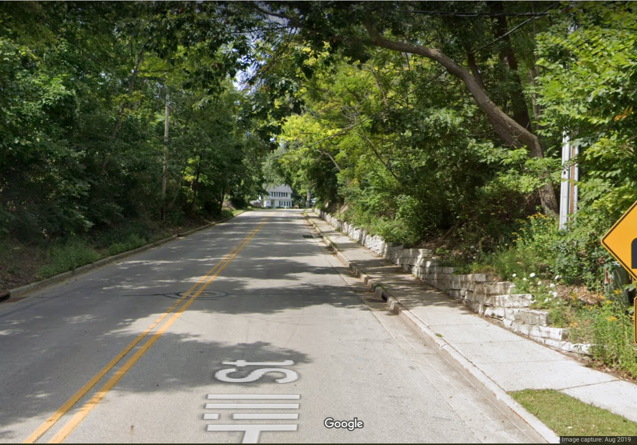

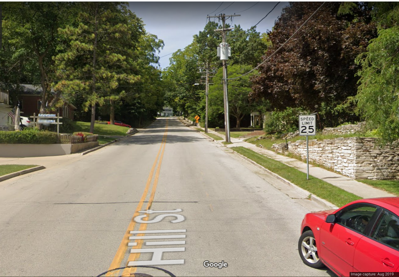

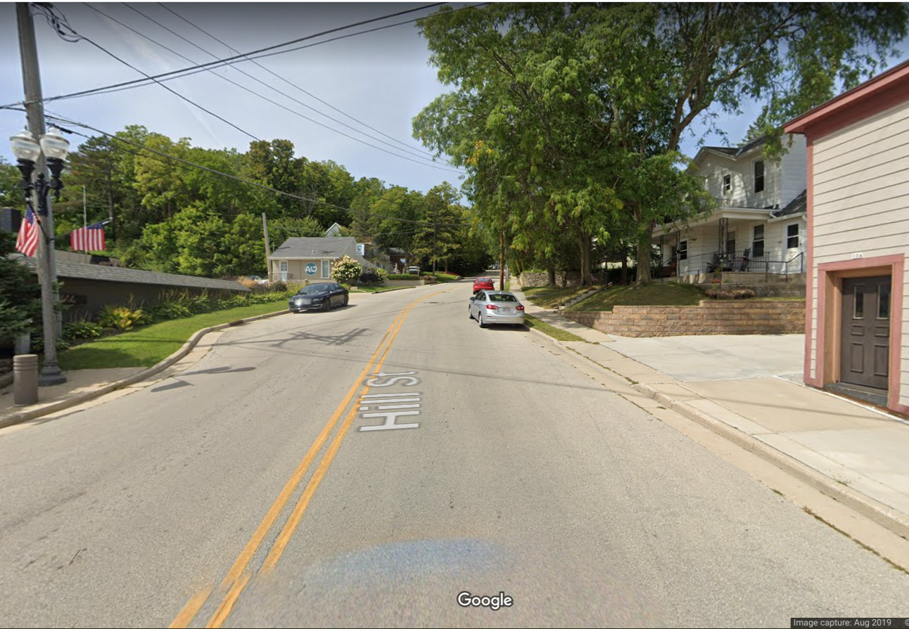

I attached a few pictures of the steepest hill below at the beginning, middle and end of the hill.
Screenshot 2020-12-28 at 5.11.14 PM.pngScreenshot 2020-12-28 at 5.18.34 PM.pngScreenshot 2020-12-28 at 5.19.54 PM.png
View attachment 75327View attachment 75328View attachment 75329
Yeah hills don't show well in flat 2d pictures. My Ultra will pull 35 degree hills on throttle and be going too fast by the top.
