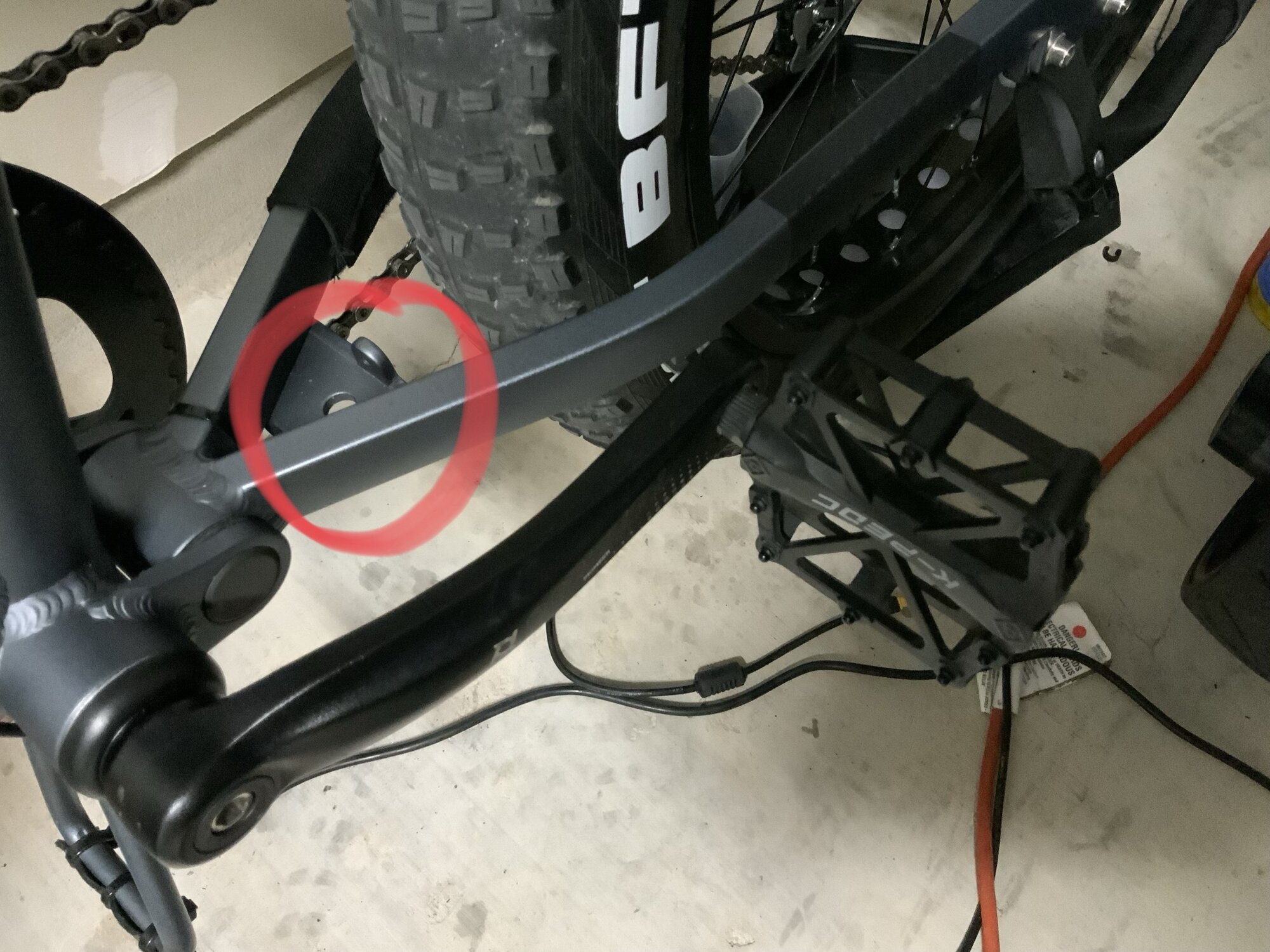

There is a hole near the lower suspension arm.. right in front of the rear wheel where you can mount the center stand. I was thinking of going to a center stand setup
For me... I’d keep the bracket as is
There is a hole near the lower suspension arm.. right in front of the rear wheel where you can mount the center stand.View attachment 70684
I noticed it on my bike and started scratching my head. I’m wondering why it’s not being used and if it has anything to do with the weight distribution. Seems weird having something so rigid at the bottom of the bike that can catch rocks and gravel. That happens a lot with the stock rear suspension (I’m 6’, 250 lbs riding trails).

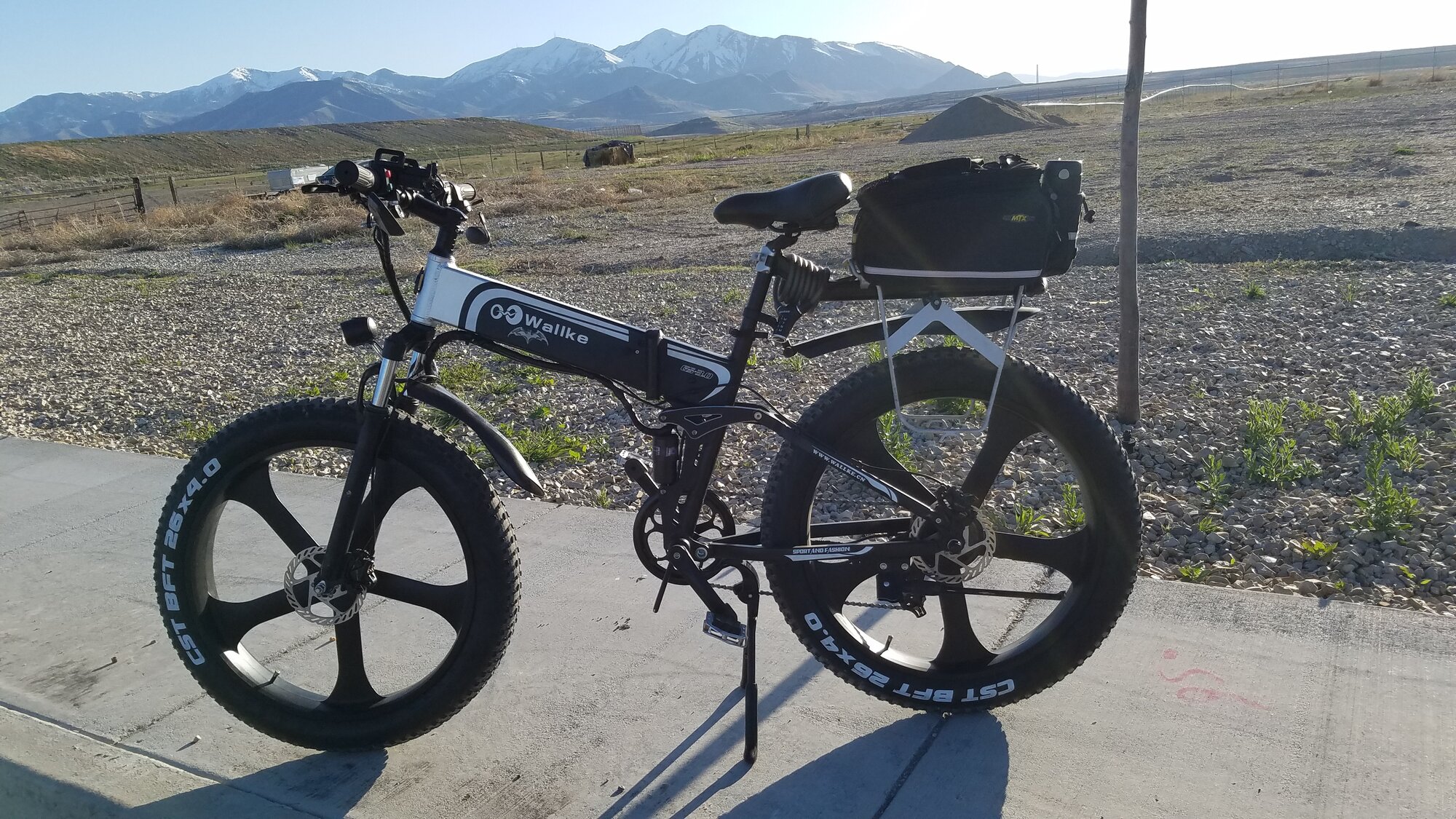

I'm using the single kickstand that mounts in the middle of the frame, but I would only use it on a lighter framed bike. The Wallke is way too heavy IMO for a single middle-mount kickstand. Plus the one that comes on the Wallke X3 is actually more beefy & sturdy than what's available on Amazon. Plus, if you remove the kickstand on the Wallke then the bracket is still there and it looks weird without the kickstand connected to it, since it's part of the frame and you can't remove it or cut it off.
Here's a pic of my middle-mount kickstand, and if anyone is interested I'm using this one: https://www.amazon.com/dp/B00DYFS3N4
I don’t plan on removing the single kickstand, just adding a double kick stand where your single kickstand is pictured 👌🏿. It’s the U shaped bracket at the bottom I wanna take a hacksaw to🪓.
Its there to balance the bike once the bike is folded in 2 ,but like you say when you are on trails it catches everything ,but don't worry after plowing through some fallen tree stumps that clunk of metal will fold right back 😜.shouldn't bother you anymore ,but yeah i will eventually cut it off and paint over the exposed area .👍
