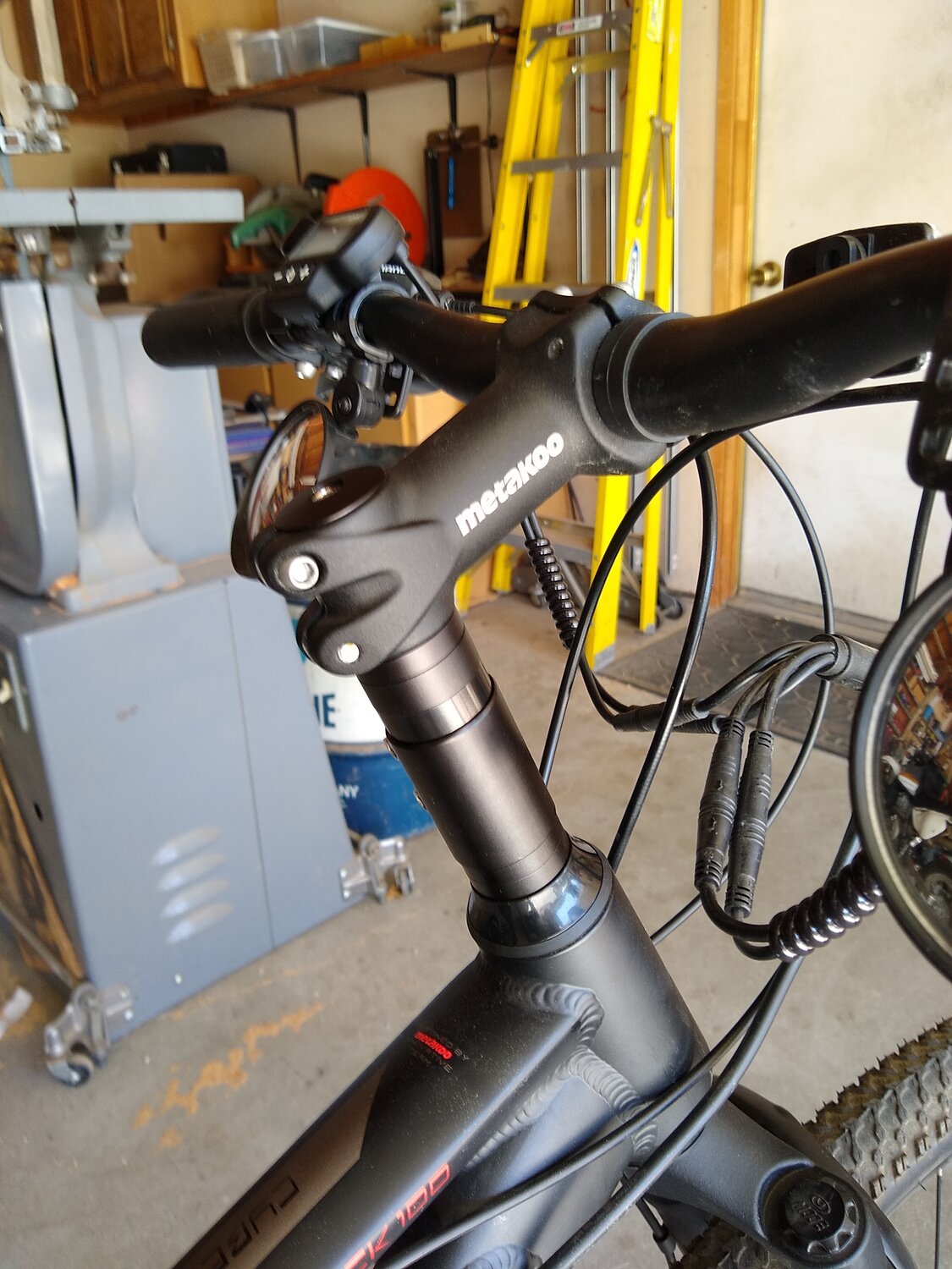

So today my stem riser came and I got it installed with no drama except needing 3 hands. It brought my bars up about 70 mm and that's a big difference for comfort. No issue with cables and wires length, they left me a nice service loop to work with. I love these inexpensive generic bikes. Parts are available and very reasonably priced. Just over $10.00 US shipped. Only a 3 day wait for it to arrive. I took it out a bit ago through some pretty rough terrain and it felt rock solid.

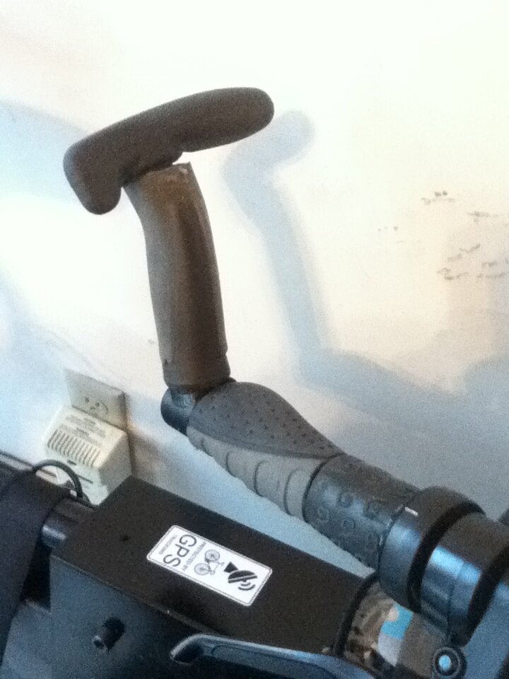

I found the simplest way is to raise, just the grips. That way you don't have to worry about cable length and or switching the brake levers and such. Plus they only cost about $15.
