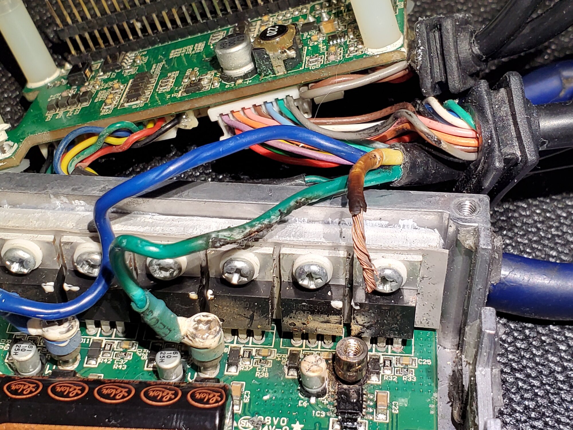

Hi, I bought a Haibike Urban Plus back in January 2019, the bike was working with no problems until 2 days ago, when I was riding the motor out of the sudden start making a much louder buzz than usual making the whole bicycle vibrate to the point that I can feel the vibration all over my body specially in my hands and feet also making the Cobi.bike display shake a little, when I engage the crank the battery light and the buzzing sound goes on sometimes taking a few seconds for the motor to start working and I couldn't get higher than 23 m/h, on the diganostics section under inspection on mybike settings (cobi.bike) shows zero errors
The speed sensor, the battery and the cobi.bike system seem to be working properly.
I'm in Key West FL and there's not ebike shops where I can take it for a check out.
If anyone has any suggestions please reply this post. Thank you in advance!

Hi Guys my bike got fixed!
I sent a technical support request to Haibike explaining what was wrong with the bicycle, about 3 weeks later I got an email from Haibike saying
Mauricio:
Sounds like there may be a connectivity or voltage issue between the battery and motor.
We recommend a diagnostic test, testing the battery for voltage and testing for voltage to the motor,
making sure the battery is good, we have good solid voltage numbers to the motor.
A diagnostic test may reveal any other issues.
Let us know what is found.
Thank you and best regards,
Leif Fleming.
I took the battery off and checked the voltage, the voltage was good, then I took the controller off to check for voltage to the motor and opened up the controller to look for the hot wires and I found a short circuit in the controller box, the yellow phase cable and all around it has significant burn marks including the green phase cable insulation.
The controller box is the:
AA508011626
CN32QT
R3 48V
17C01249
Mr Fleming immediately ordered and got a discount for me, the part it was $199.00 after the discount = $135.00 with taxes and shipping and handling with FedEx, 3 days later the part got delivered, installed the controller and everything back together, took it for a spin and is working like the first day (smooth quiet and fast).
Thanks to Mr Fleming, Haibike Technical Support and Alta Cycling Group LLC.
I hope this information could be helpful for someone having the same problems with their Urban Plus Bike.
3 days later the part got delivered, installed the controller and everything back together, took it for a spin and is working like the first day (smooth quiet and fast). Thanks to Mr Fleming, Haibike Technical Support and Alta Cycling Group LLC.
View attachment 59412View attachment 59413View attachment 59414​
