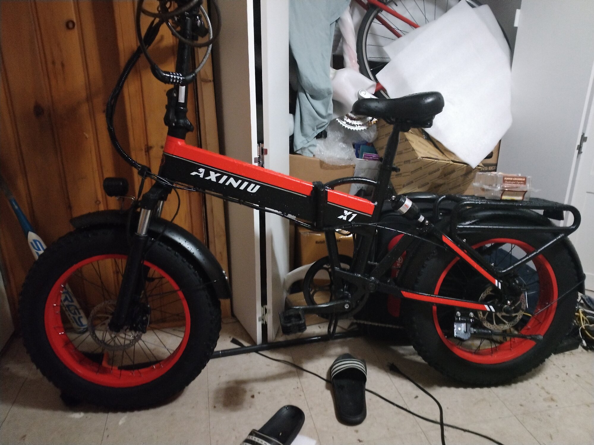

Recently Purchased this New AXINIU X1 750W. Tested with less than 17 miles (PAS 1-2) traveling went up a slight hill and power disconnected. Now the bike loses power every thirty seconds or so while using. The bike stays on in walk assist. I'm not sure what happened. Do you think I should request a return and refund or troubleshoot the repair?

Get bike replaced. I’d guess it would take longer to diagnose the problem, get the parts and then repair the problem.

FIXED: 2nd question?
M15 Display settings error.
Checked 24v instead of 48v
The battery died with out signalling the display screen. Went home, charged the battery and changed the setting. Back in business. 🤦‍♂️
