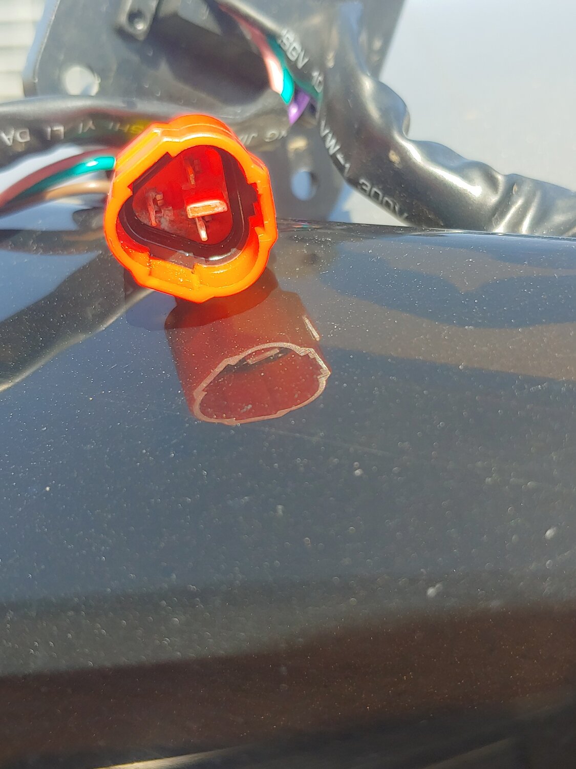

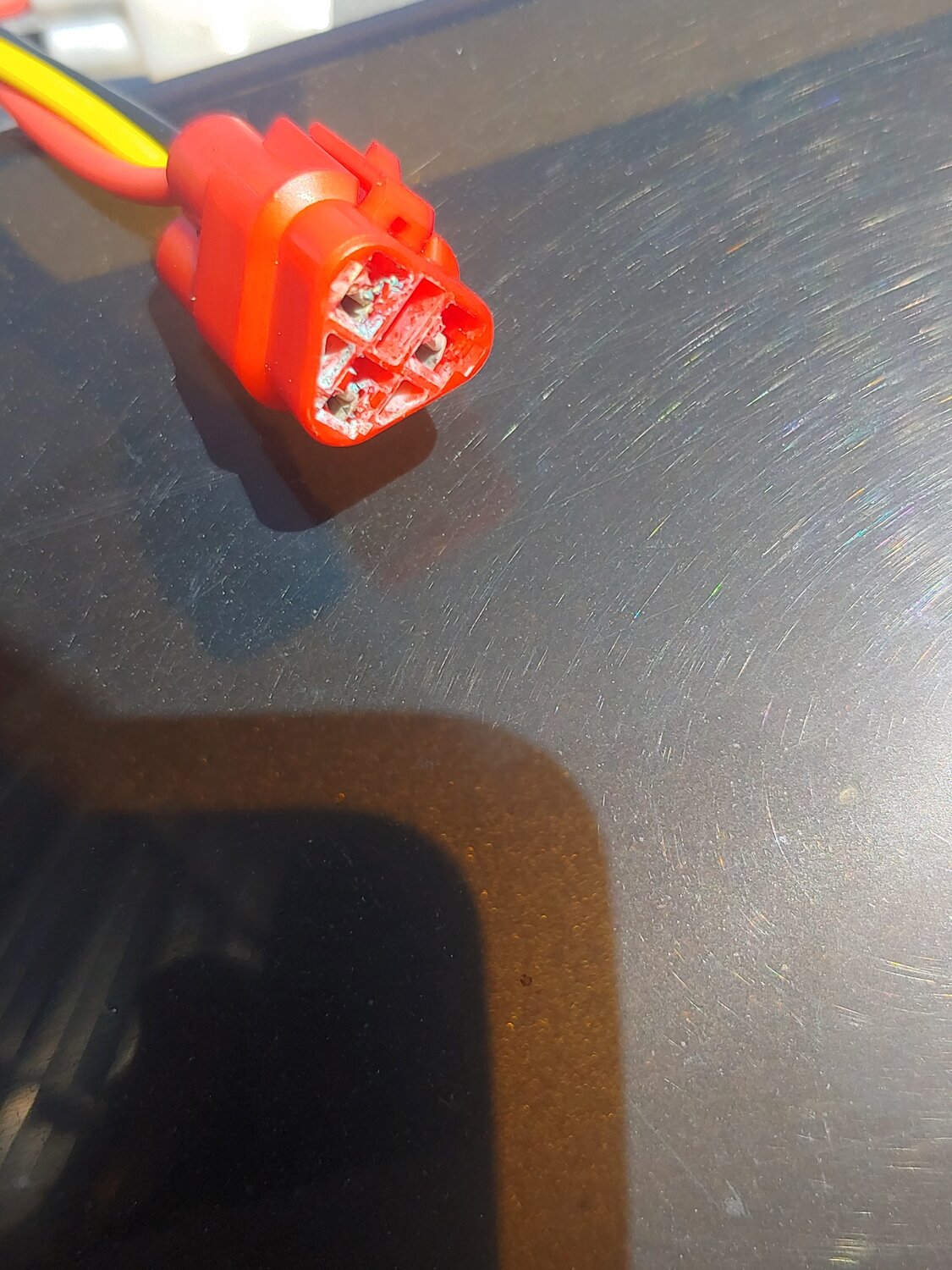

The electrical gremlin that shut my Trance down last year was caused by a something as simple as a corrosion in the motor connector. The shop cleaned it up and applied a bit of dielectric grease to the connection and had the bike back to me the next day. Who would have thought?
