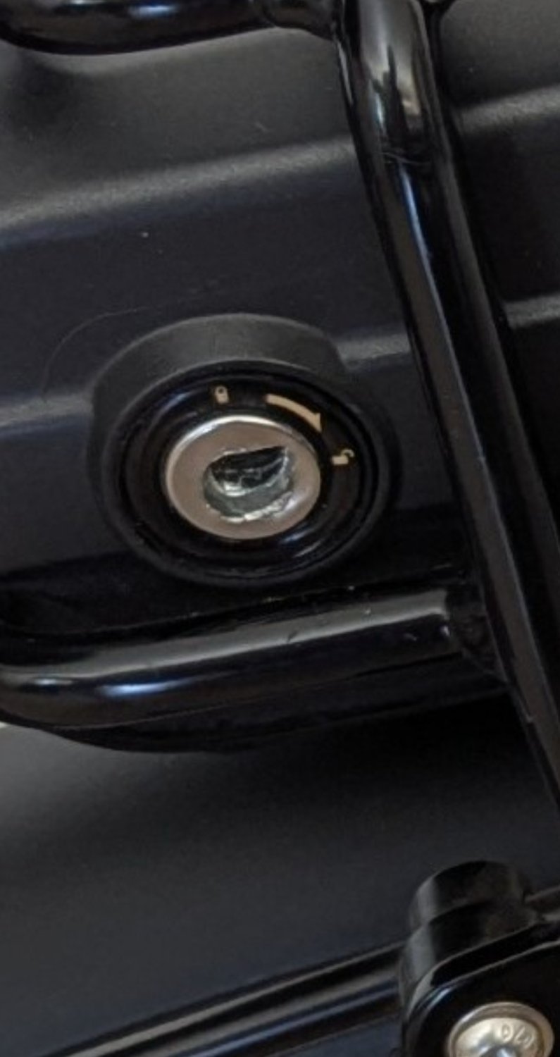

I have a problem with the Lafree that I hope someone on this site can help me with. I bought the bike as Demo, the dealer did not have a key for the battery and Giant/Momentum cannot provide one. I was told my only option was to drill the lock and then buy a new lock set. I have drilled the lock and can now remove the battery. However, I can't for the life of me figure out how to remove the old lock set and install the new one. Giant refuses to respond to my requests for assistance. Has anyone on this site gone through this and can provide some instructions on replacing the battery lock? Thanks for your help/

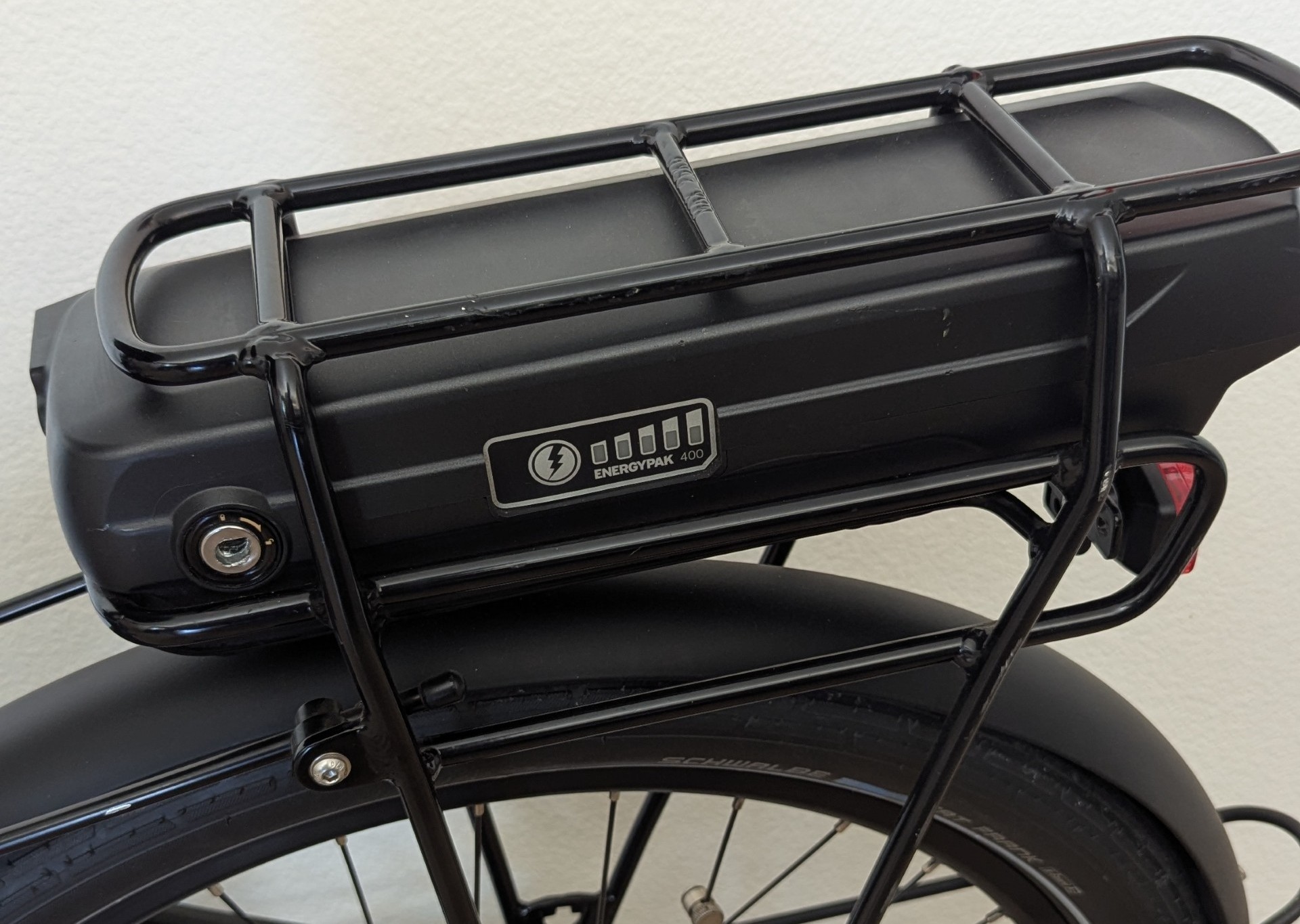

Here's my battery. It is not in the frame but in the rear rack.

I'm just guessing, but the battery case probably needs to be opened up to get to the key cylinder from the backside to remove it.
There's probably some screws that hold the battery case together that can be accessed when the battery is removed from the carrier.
Sometimes they hide the screws under stickers or grommets or rubber/plastic plugs.
You might have a sealed battery that can't be opened, but I kinda doubt that.

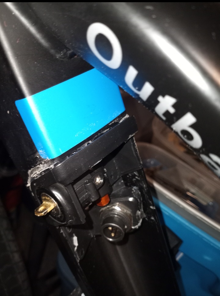

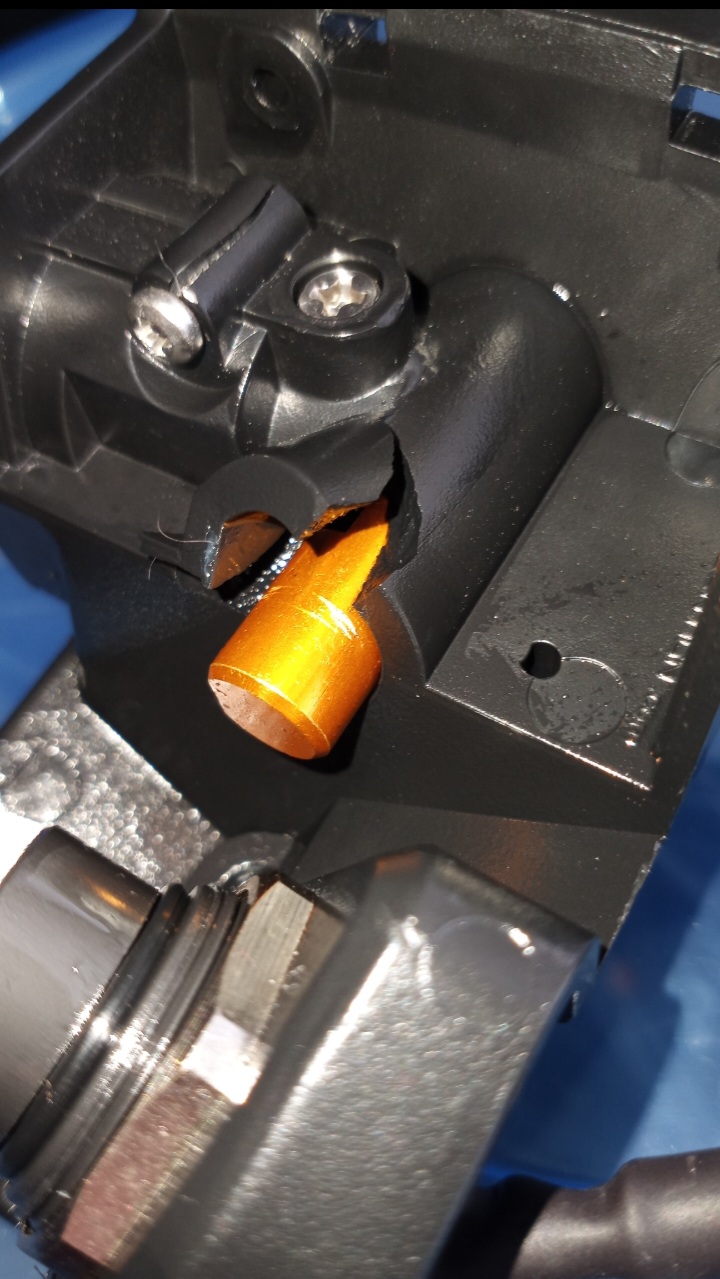

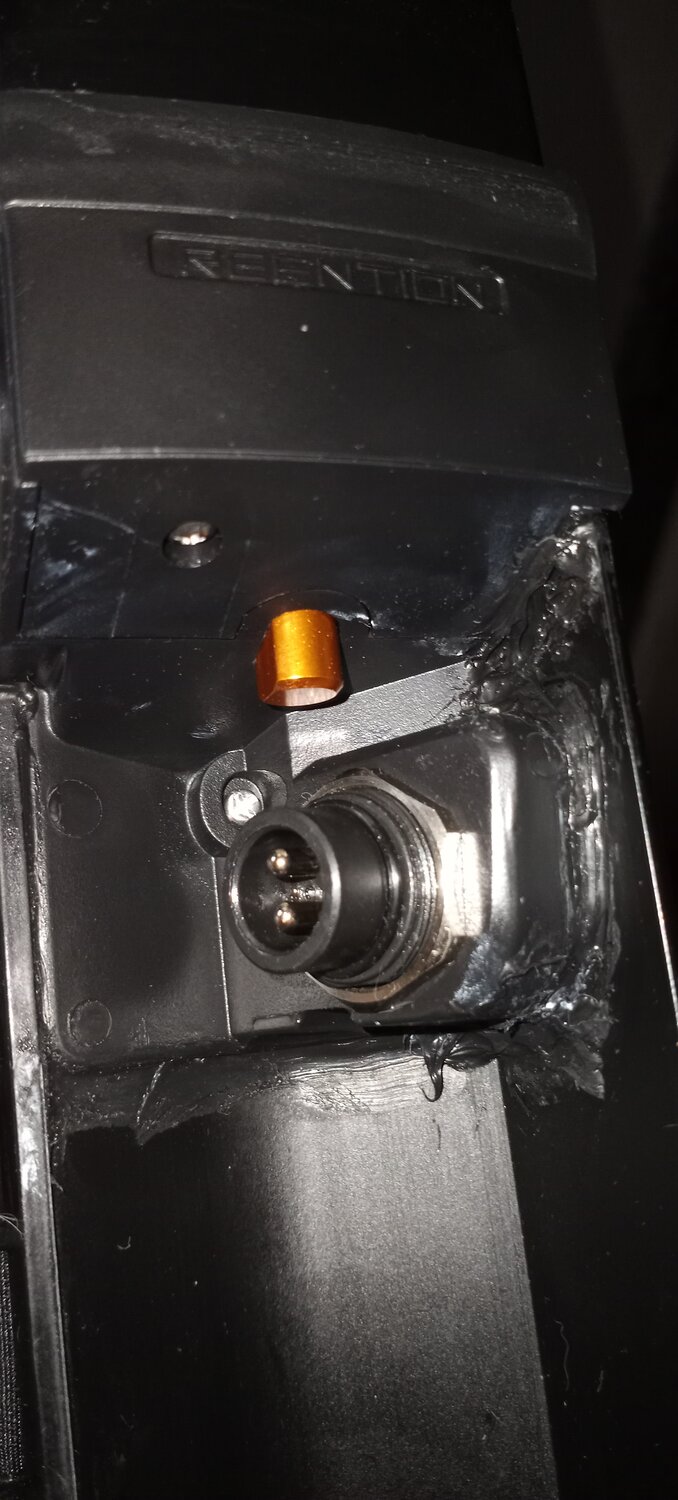

Here's some pictures of my broken battery bracket for reference.
You can't access the screws until the battery is removed.
(So that anyone with a screwdriver can't walk off with your battery. )

The battery is not sealed and I have it removed. I've tried taking out all the screw I can reach but can't open it up to access the locking mechanism. Please look at the picture I posted of the battery mounted on the rear rack. It's not in the frame.
