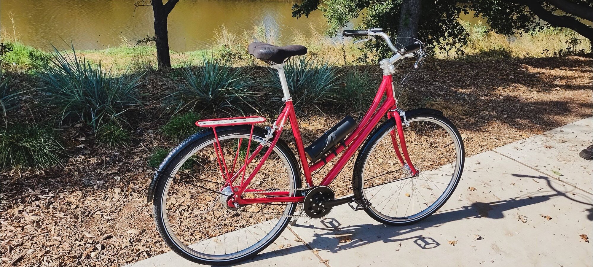

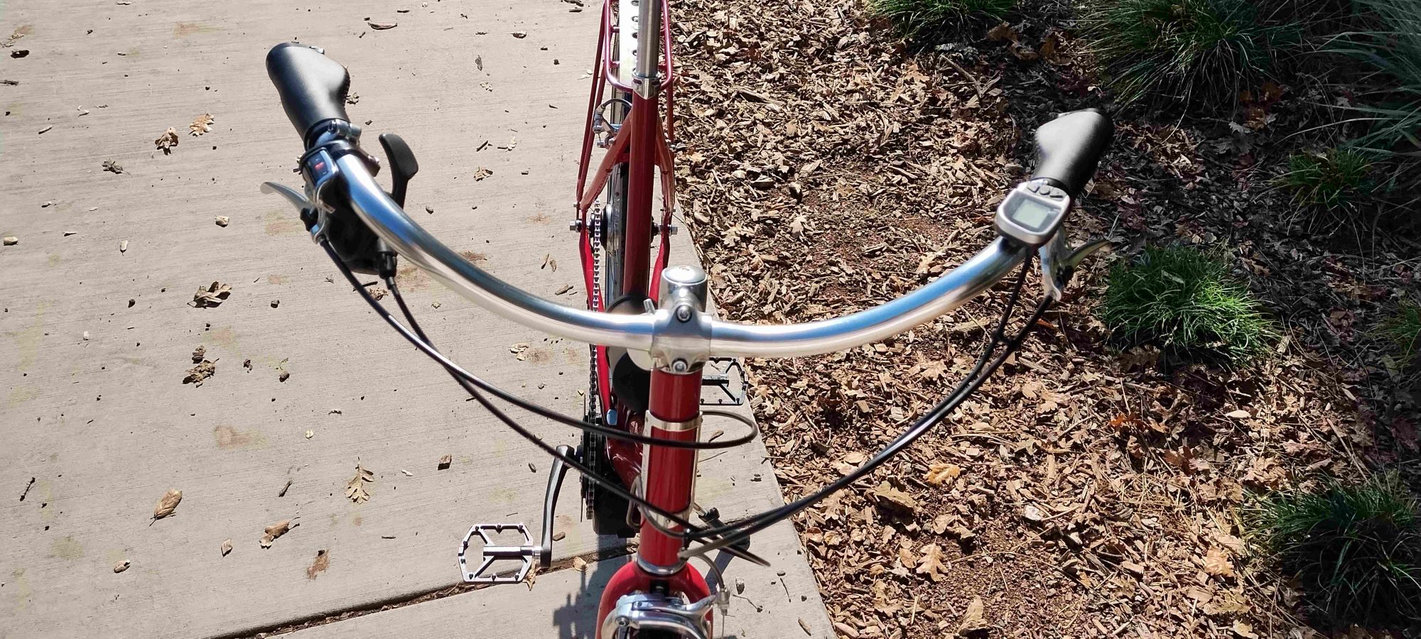

I also like MicroShift products. For example this bike has a Shimano Nexus seven-speed internal hub of gears. Instead of the original twist shift, I installed a MicroShift trigger shifter that is indexed for Shimano internal hubs. It is much smoother and faster, with less effort. The mid-drive pulls the chain through the gears and this bike cannot be ghost pedaled. It has a 42-t chainring to a 20-t cog for climbing and uses an e-1 chain for durability.
