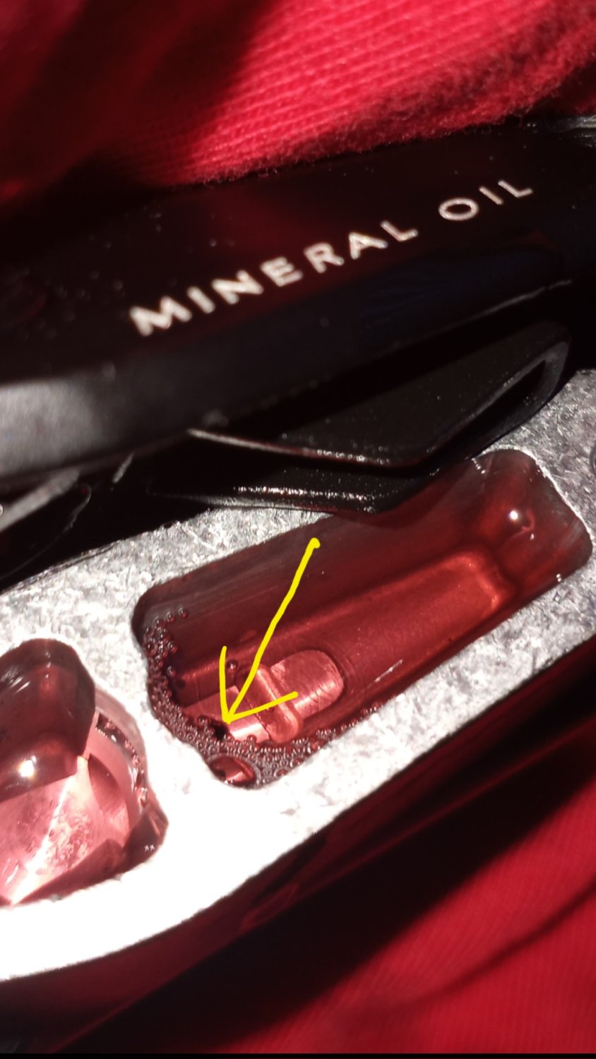

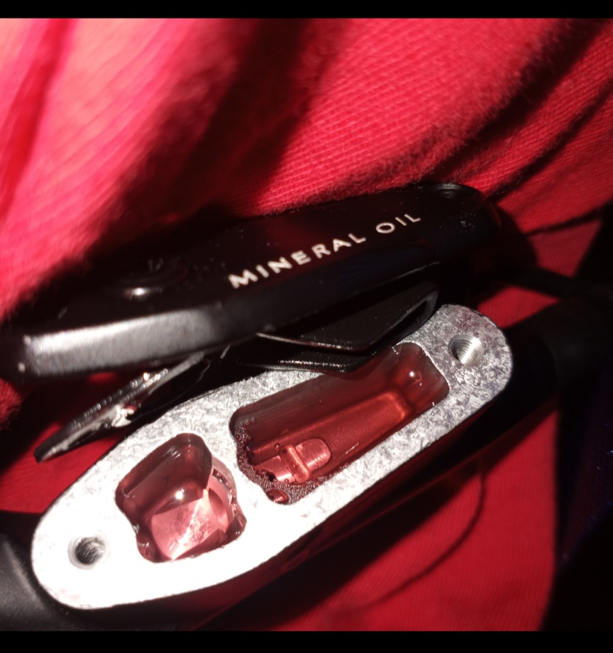

Then suddenly it will form an air pocket and not work at all.
Hydraulic brakes are fine to be upside-down if you don't touch the brake levers.
I keep flipping my ebike upside-down and always end up hitting the levers and getting spongy brakes.
I just stand the e-bike up against the wall and hit the rear brake lever a bunch of times to get the bubbles going uphill from the rear caliper.
The bubbles in the brake line rise up into the reservoir when the brake lever is pressed and released during normal operation, and the reservoir is right side up.
When the reservoir is upside-down, the bubbles rise up to the brake cylinder inlet port, but don't get into your brake lines if you don't squeeze the brake lever.

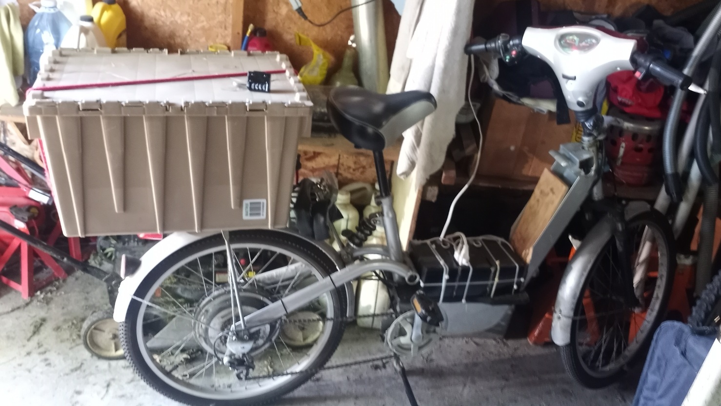

My old POS ebike does exactly that,..
It also cuts the power assist at 22 kph, then turns on the regeneration at 25 kph.
It was built for the European market so they had to flip the handlebars for Canada to get the throttle on the right where it should be. 😁
So the gear shifter is now upside-down.
