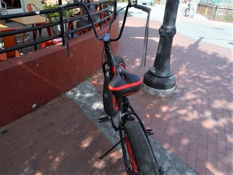

Is this the type of Bafang HD you like? It is trying way too hard to be Butch as compensation for what does not measure up. Yes, I converted it too. It is what the customer wanted and yes, the wires are hidden.

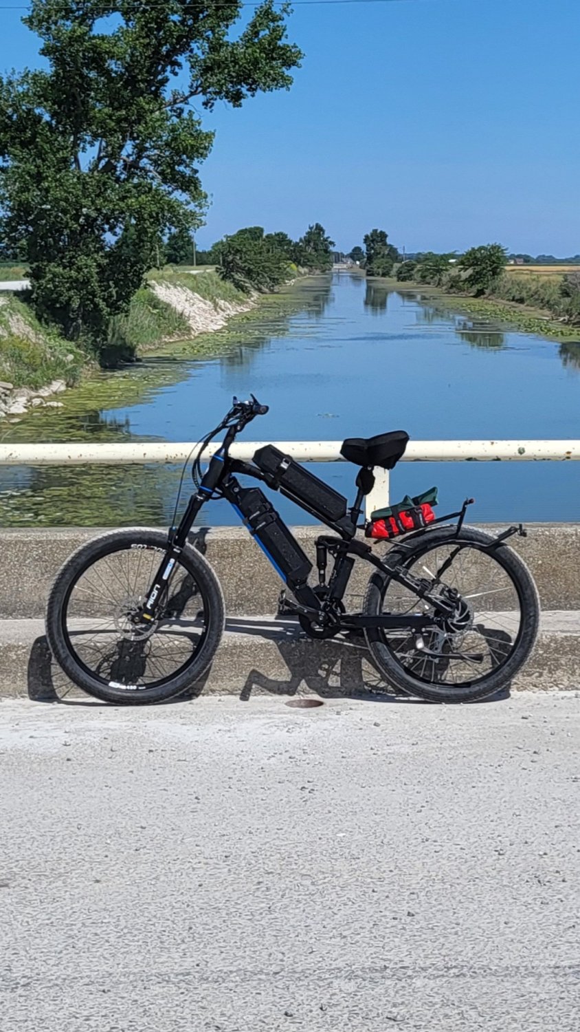

I like my Bafang.
It's got two Bafang motors and four brake switches now,..
