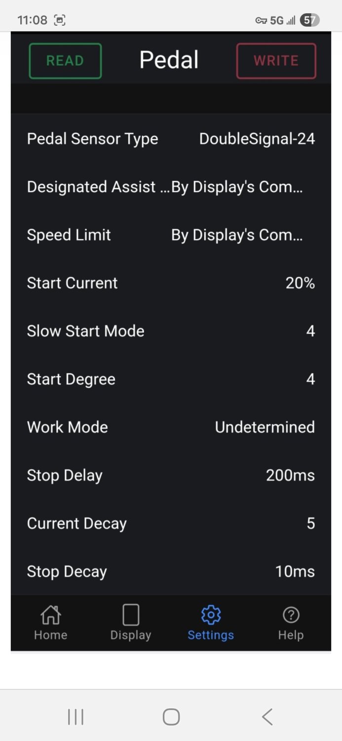

There are two kinds of 'lag' and 'over-run'. The first is time. It is set in 100 millisecond increments. Visual perception takes 100 milliseconds. You want a little lag such as 500-700 milliseconds so the bike is not too jumpy. The same goes for over run. You do not want it so that if you have a minor adjustment in pedal pressure it abruptly shuts down. The next is set by degrees of rotation, so if the pedal is bumped a little it does not go flying, but is still highly responsive. There is another variable and that is cadence. To be smooth the power delivery curve should ramp up with cadence, maybe peaking at 110. Ideally it will be highly responsive without being lurchy. Then there is the torque sensor sensitivity. As @BlackHand mentioned, you want it to be sensitive, but not jump around if you are not pedaling perfectly smoothly, and you should be able to downshift while coming to a stop. It is set in milliamps.

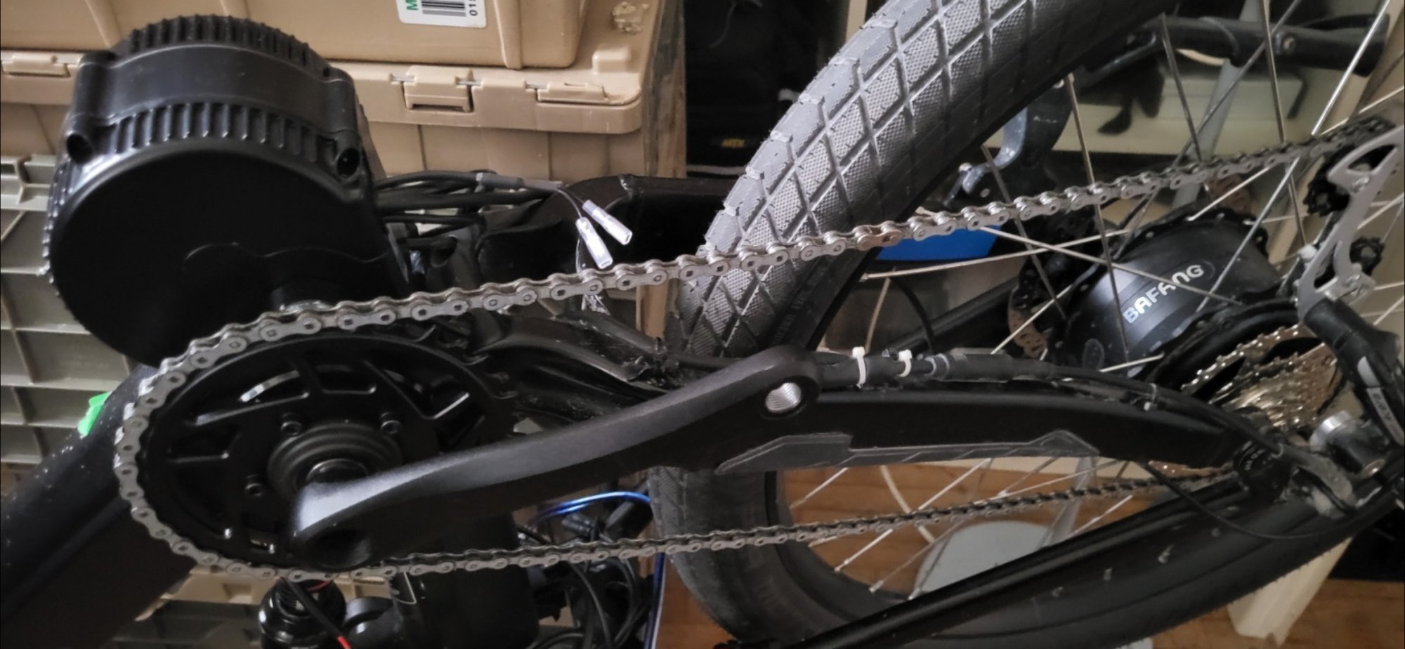

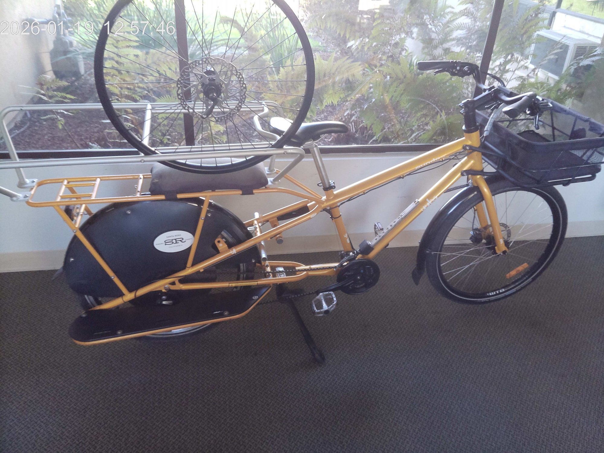

This one just came in. It is a Bionx Yuba Mundo that is in perfect condition. The Bionx hub-drive system died and is not supported, making the bike less than useless due to weight and rotational weight. The new owner bought it for $250 on FB Marketplace. This week the old wheel goes and it gets a mid-drive. The mid-drive will be set for maximal smoothness and power, but with a low top speed. It will hall two kids, a tot and a baby. We don't want them to get whiplash.
