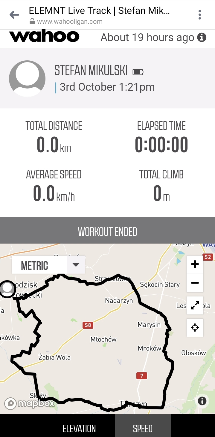

Excellent review Stefan! If you by chance have a screenshot of what the tracking beacon looks like can you please post it? Strava Beacon is useless in Japan because it doesn’t provide lat / long or geo location names etc. - here’s a sample :
Wahoo Live Track shows your actual ride progress, and the remaining route (if you ride with a Route). It does not show the ride data (all are zeroes) though.

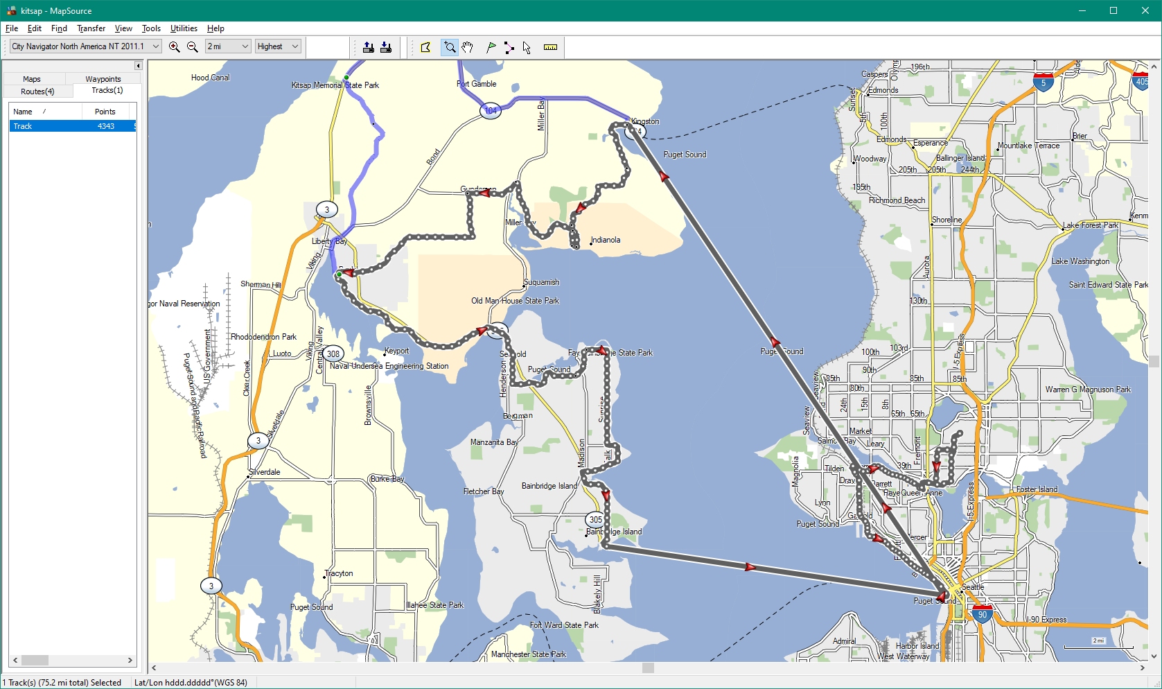

Here's what happens when Mission Control loses a connection for a while and then reconnects. We were not flying but on a ferry boat and the Specialized was off for about 45 minutes and then 30 minutes. It did not have those same long tracks when we stopped for lunch since we were not moving.

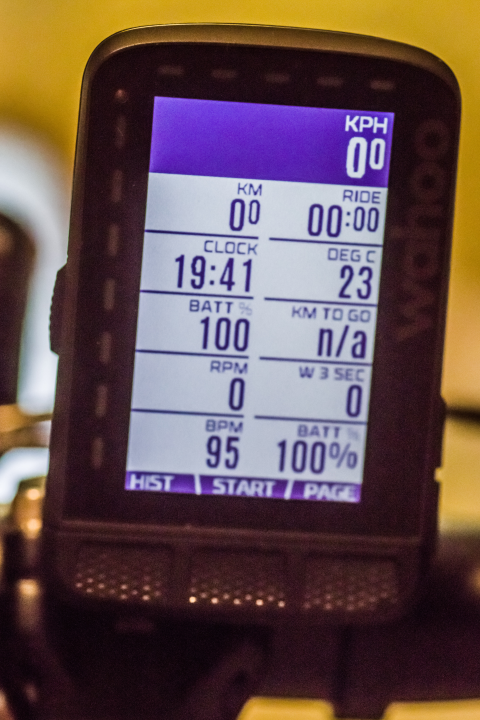

Besides, my current config of ELEMNT Roam is this:
The Battery % in the left column is for e-bike, and the Battery % field bottom-right is for the device battery.

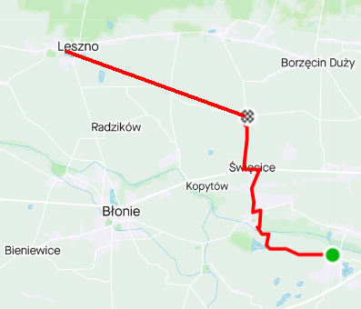

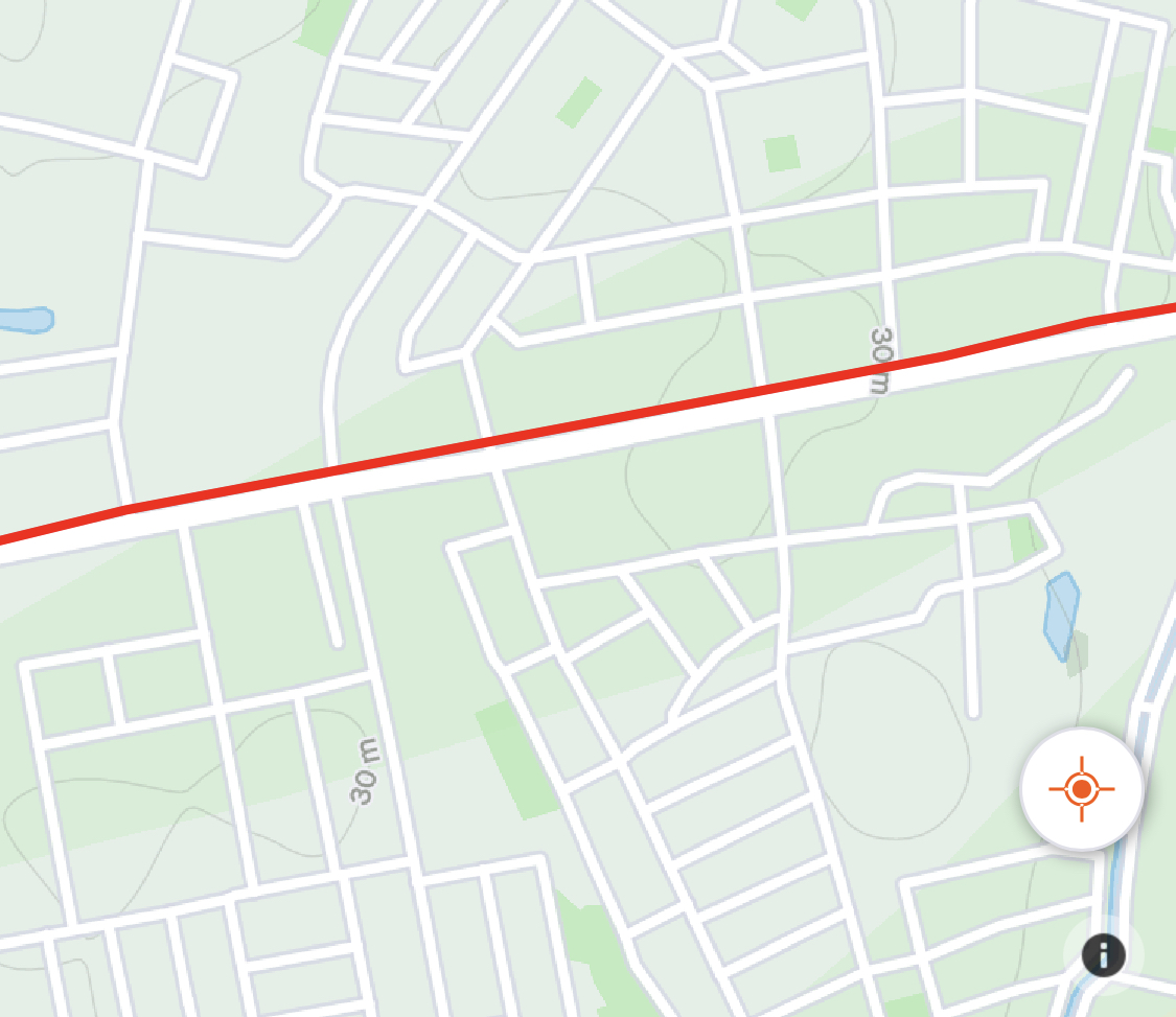

The First Negative Wahoo ELEMNT Roam Ride Report
If you ride a bike with no sensors, the Roam solely depends on its GPS, which might be inaccurate but it works. Add a speed sensor (it is actually a wheel RPM sensor) to get more accurate distance measurement; in case the sensor gets disconnected, Roam will switch to the no-sensor mode, and everything is still fine. It is not so nice when you have connected your e-bike as a sensor:
Case A: Let us assume the entire e-bike gets disconnected for any reason: the Roam will switch to its bare bone version, which is fine (had such a situation once)
Case B: Let us assume only the wheel RPM sensor of the e-bike got disconnected because of some reason (probably a software bug or whatever). In such a situation, you still can see the E-Bike Reported Speed, Battery Level %, Cadence but Biker's Power value becomes zero. However, the Roam thinks the e-bike is stationary, and gets into Auto-Stop, meaning the Distance and Time variables get frozen, and your ride is not recorded anymore. What a bummer!
I should always keep BLEvo running on my smartphone in the back pocket for backup purposes! The Roam deprived me of 17 km of my Strava ride data, the data I had to re-create manually post ride. Interestingly, the return ride was served by the Roam without any hiccups. Yes, I could see a large "LEV Motor Error" message on the ELEMNT twice. What error?! No error has been ever reported for my Vado SL before. (I think the Roam is the error really...)
I don't complain. Things happen. I only need to learn to keep a backup device with me. I also intend to disable the Auto-Stop. Besides, the calibrated perfect Schwalbe Smart Sam 37-622 wheel circumference has been 2159 mm (as opposed to the default value of 2180 mm for 38-622).
