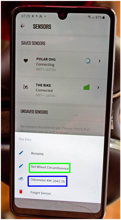

Pairing E-bike with the Roam
Your Specialized, Giant, or another ANT+ compatible e-bike is seen by the Roam as a sensor (the same way as your heart rate monitor is seen by the Roam). The first pairing of my Vado SL only connected the Cadence and Power sensors of the e-bike. That was wrong. Later, I deleted the sensor named E-Bike and paired my Vado SL again. Only that time, I could see the proper picture of fully connected e-bike in the Elemnt Companion App:
You need to see the Odometer status if the e-bike is properly detected as a full blown Sensor.
Note: I also paired my Polar OH-1 HR monitor with the Wahoo.

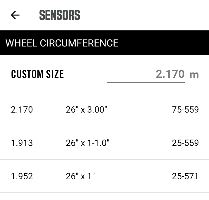

Wheel Circumference Is Critical!
As long as your e-bike has been connected to the device as a Sensor, you should verify the Wheel Circumference! Let me explain that, as the matter is not that simple.
  • All your e-bike really meters is the number of revolutions of the rear wheel per minute;
  • Your e-bike has the Wheel Circumference (WhC) value coded in the firmware by the factory or a dealer;
  • The RPM multiplied by WhC gives the Distance ridden;
  • The Distance ridden divided by Time gives Speed.
If -- by chance -- the value of WhC coded inside your bike is proper then no worries. However, changing your tyres to another size (or even riding at different inflation pressure than expected) will dramatically and badly affect the values reported by the e-bike. (It also can happen the coded WhC value is simply wrong!)
Now: Elemnt Roam will always report Speed as reported by your e-bike; you cannot change that behaviour. However, what really matters is the correct Distance ridden. And you can modify the Wheel Circumference value in the ELEMNT Companion App.
Elemnt Roam will read the Wheel Circumference value off your e-bike (it is 2180 mm for my Vado SL 4.0 and 2255 mm for my S-Vado 5/6). You are free to type any value instead here.
Let me give you an example: My Vado has the WhC value coded as 2255 mm, and that is for stock 29x2" Specialized Electrak 2.0 tyres. However, I swapped the stock tyres for 47-622 (28 x 1.75") Schwalbe Smart Sam. Consequences:
  • The Speed reported is (and will be) always too high (it depends on the WhC value stored in the bike)
  • The Distance reported will be correct only if I change the WhC to 2220 mm in ELEMNT Roam Companion (connected to the device, and the latter to the e-bike).
(Similarly, I'm experimenting to find the proper WhC value for my Vado SL with new 37-622 tyres).

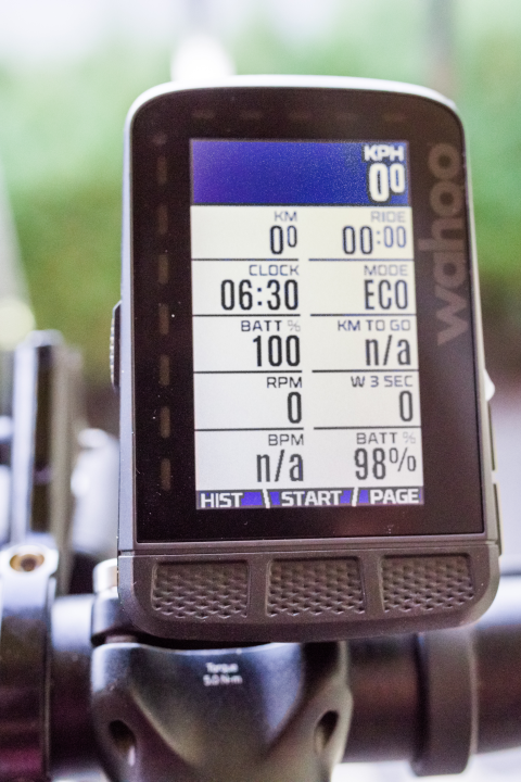

E-Bike Data Fields
As long as your e-bike has been properly identified as a Sensor, there is pretty a lot of information extracted from the bike. For instance Speed, Cadence, Rider's Power, Assistance Mode, Battery % or Range are taken from the e-bike. There are three e-bike specific fields available:
  • LEV Battery: Your current battery %. It is not to be confused with Battery (which is the device battery %) or with Phone Battery %;
  • LEV Travel Mode: It is OFF, ECO, SPORT/TRAIL, TURBO, SMART (Or ECO or BASIC or ACTIVE etc. for Giant e-bikes)
  • LEV Range: The Range is not given by Specialized e-bikes but it is given by Giant ones.
("LEV" is for Light Electric Vehicle).
Here is an example how a well configured Workout Data page might look like:
Up to 11 data fields can be selected to the Workout Data. My selection was: Speed, Distance, Ride Time, Clock, Travel Mode, Bike Battery %, Distance to the Route Destination, Cadence, Rider's Power (average for last 3 seconds), Heart Rate, Device Battery %.
There is an interesting (Wahoo specific) way to limit the number of fields visible, and to increase the font size: just operate the Up and Down buttons. As the font increases, the less important data fields are removed from the view. That's why you are expected to not only select the desired data fields in the Companion App but also sort them from the most to the least important to you.

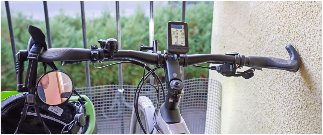

Regarding Vado SL, I got rid of the smartphone and the TCD display from the bars:
Clean & sleek
I could get rid of the smartphone from the bars. The display of the "big" Vado is mandatory, though.

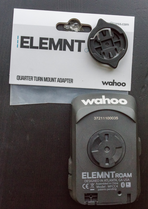

Specialized Display Mount and Wahoo
The Specialized Display Mount is for Garmin. If you want to re-use it, Wahoo comes with an inexpensive Garmin adapter:
The Wahoo ELEMNT Roam comes with a rock-solid dedicated out-front mount (I used it on my full-power Vado) and with a stem mount to be installed with provided zip-ties.

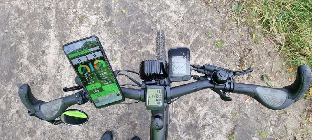

I still use BLEvo, only the smartphone more typically resides in the back pocket of my cycling jersey than on the handlebars. I can copy the detailed ride information to Strava by hand only I have become too lazy to be doing that. I will copy that info for the "Bolimoza with Jacek" ride.
What I like about Wahoo/Garmin is these bike computers include a thermometer (important information related to clothing change on the ride).

It is necessary to calibrate the wheel circumference in Roam for this reason:
The only distance information Roam actually gets from an e-bike is the RPM of the rear wheel. That rotational speed needs to be multiplied by exact wheel circumference to give accurate distance ridden; and such calibration is the best done by comparing the measured the figure of GPS distance ridden to one calculated by the Roam and based on the e-bike wheel RPM. (Garmin Edge users can just select "Auto" for wheel circumference estimate: My brother tells me the Auto feature is not very accurate in the Edge, so he calibrated the WhC for his e-bike by my method).
Interestingly, both Garmin Edge and Wahoo Element bike computers rely on sensors. For example, a Wahoo speed sensor is a necessary buy for a traditional bike, with the Wahoo power meter as a nice extra. If no sensors are present, Garmin or Wahoo rely on the built in GPS module. (Specialized and Giant e-bikes with ANT+ already have the appropriate sensors that supersede the internal GPS of the device).
To get detailed Specialized e-bike info, I still need to run BLEvo but the smartphone doesn't need to be on the handlebars anymore.
