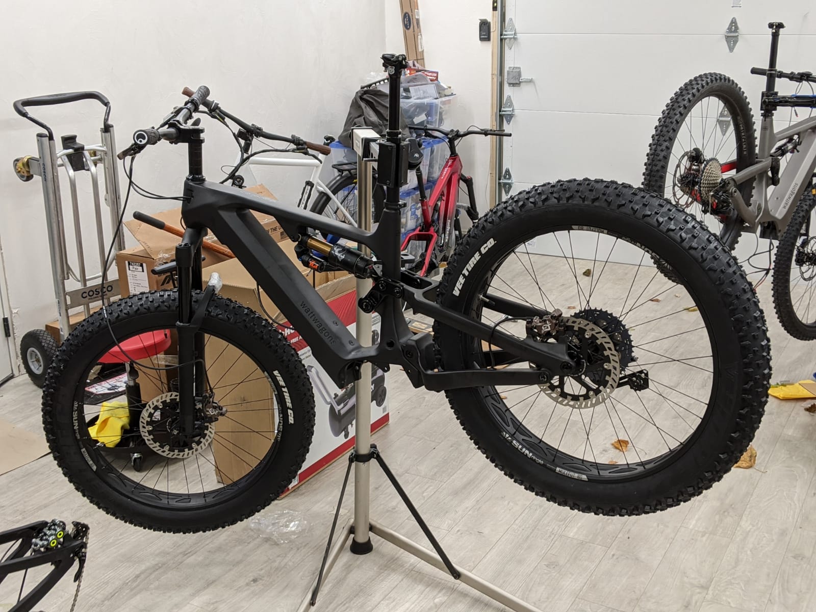

Digging the Porsche Grey!A few more build pics ..Note that the downtube is the same for the new UC Pro. We will get those frames in a few weeks .. yay!
The fat tire is 4.8 with MDRP rotors. View attachment 70774

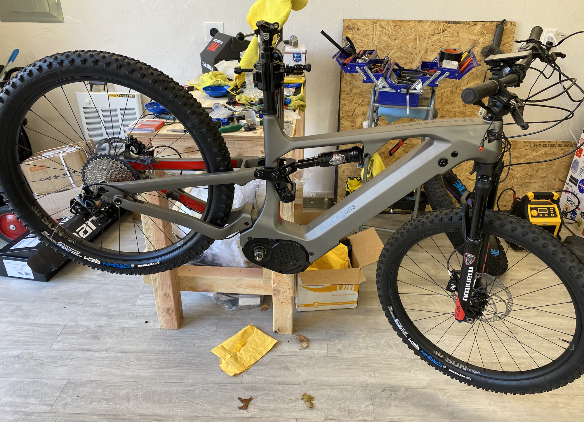

The Porsche Grey is with 27.5*2.8 inch tires View attachment 70775
IMO 1000W nominal is plenty for most cases with the new controller . You can do 2300W if you want to but that’s the safest upperbound.Pushkar, What is your feeling regarding the wattage possibilities of your controller? $ aside. We're all tempted to put the pedal to the metal but ... respected folks around here are saying the max is just too much with the Archon. For a guy like me, 70 years old, but a kid at heart and a bike rider for 66 of those years, but who has no need for speed (but would appreciate power for hills) what configuration would be your considered recommendation?![]()
the new (to be renamed UCPro) will have an even nicer triangle (as you can see on the 3D print). Very clean look. We have also re-done the belt adjustment piece to bring it in line with the titanium version.Looks real good, Pushkar. I really like the shape of the downtube battery enclosure. I dare say if the UC Pro looks anything like this FS bike, it’s gonna come out beautifully.
Will we be seeing a finished version soon? I suspect there are a few of us on this thread that are waiting for the final pics of this upcoming beauty.the new (to be renamed UCPro) will have an even nicer triangle (as you can see on the 3D print). Very clean look. We have also re-done the belt adjustment piece to bring it in line with the titanium version.
