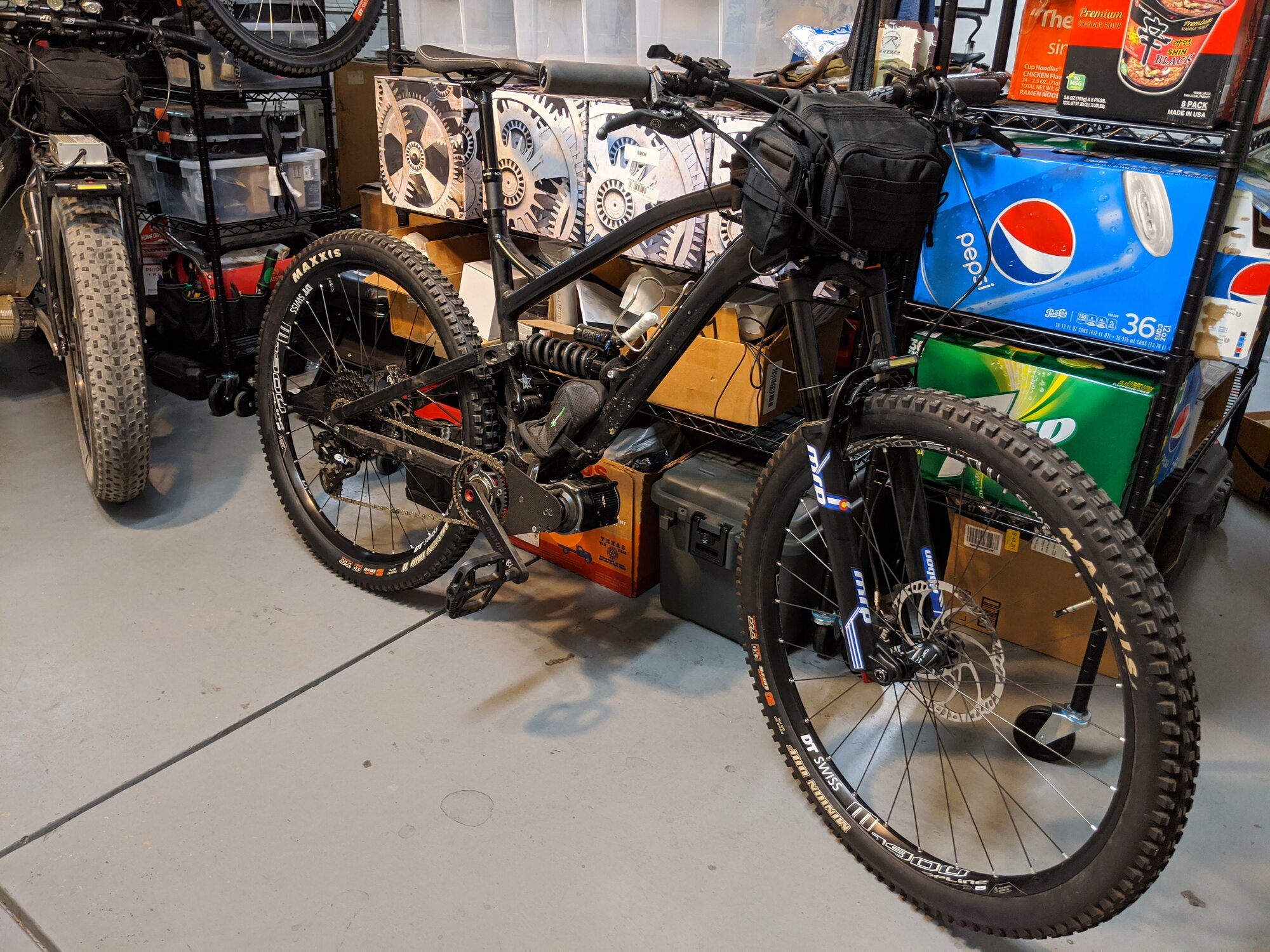

The weight of the hub is not such a big deal, assuming you don't go bananas on the size. Assuming you do it right and use a geared hub, you will have an underpowered motor thats singlespeed. I *guess* thats livable, but only barely so. What you need to do is ride a hub on singletrack with very low power (I have found 250w output using pedal assist is about right) so you gain a traction benefit without creating a risk of the wheel popping up over a root, and then coming back down pointed in an unfortunate direction and off you go. Either faceplanting or off an edge where you need a parachute to stay out of the hospital.
Doing trails with a powered front wheel takes a fair amount of skill, and *is* rewarding once you know how to do it right. But... I would never do it as the sole mode of power. This is the realm where a pedal-only mid drive really shines.
BTW when I say I wouldn't do a front hub alone this is where I'm coming at that statement from:
and this
