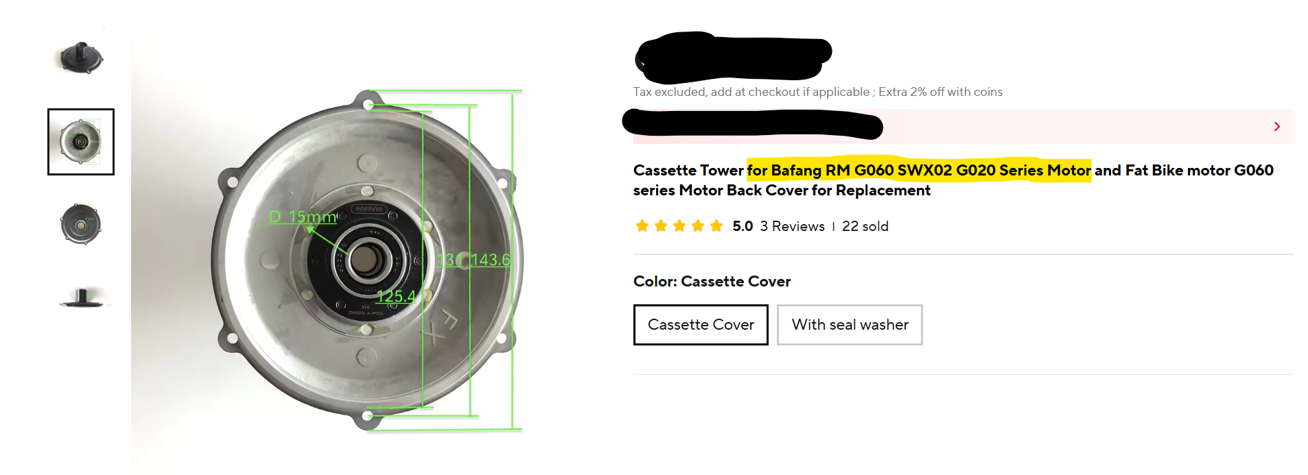

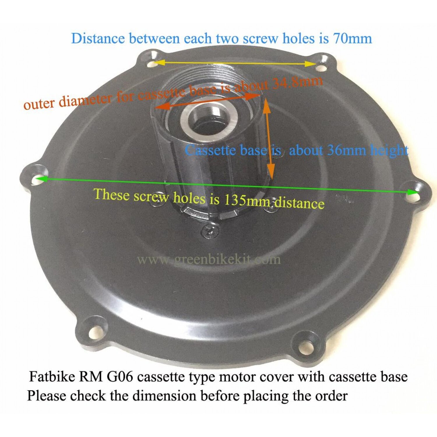

If the motor is a screw-on freewheel and not a cassette motor, Bafang does make an outer motor cover that has the Cassette mount for some of their IGH motors. You may be able to source it out somewhere.
Yes but the axle will still be for 175mm rear spacing, so that translates to about 7.5mm shorter on each side, best case. About a bolt's length. Not going to be so easy to get around that. But worse, the 750 has an oversized power plug that can oly be threaded thru as a bare wire. He would have to cut off each of those very thin motor wires and individually solder them back on. Not a novice job unfortunately.

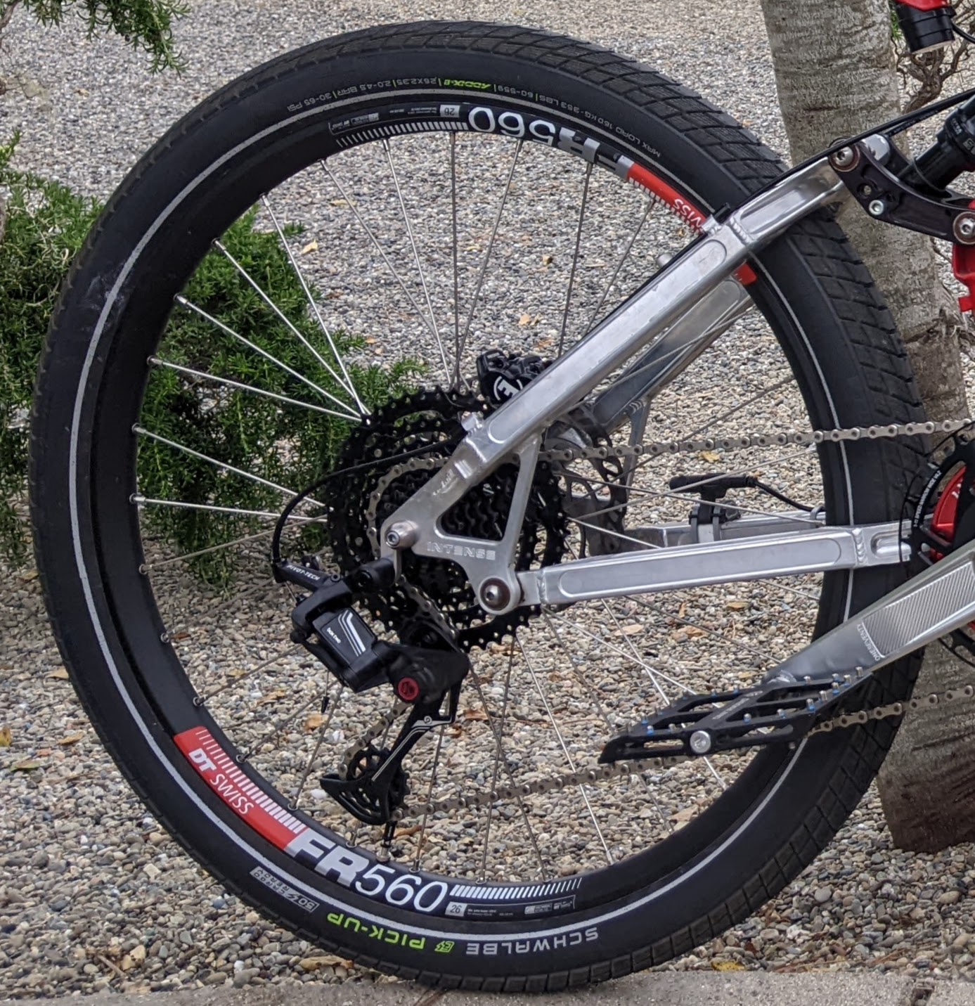

I use both Box and Microshift derailleurs. Box Two Extra Wide will do the trick for you. It has a very high level of fit and finish and shifts butter-smooth. I believe you have to match it with a Box shifter, and on my most recent build I chose a Box One because of its uber smooth cable and cable housing. I do have a Box Two with a Box Two shifter on another bike and there's nothing wrong with that setup, either. On that setup I use the Box 3 11-46 cluster. You don't want that cluster. Its largest two cogs are each pinned to the next smallest cog and to fit the freewheel, because of this, a spacer (which they include) is required. I called Box and talked to a product guy and asked whether a setup like this would work well with a powerful mid drive and he wasn't sure. No fault of theirs as they are building for analog MTBs and not ebikes. FYI this cluster is a Sunrace CS-M983 with a Box label on the lock ring.
I also have Microshift Advent drivetrain components and they are much cheaper than Box, and perfectly functional. The derailleur is not as premium-looking as the Box, with a slightly less refined powder coat finish vs. the top-drawer Box finish, but you are never going to notice that after you install it. The Box does shift slightly more smoothly, but that may be because I have the Box on a cargo bike with some chain alignment challenges. The Advent has a fantastic clutch on it. One thing that stands out big time is the Microshift Advent 11-46T all-steel cluster (the 11-42 uses alloy for its biggest cogs). It is head/shoulders over the Box/Sunrace since it is 1-piece steel (no spiders at all) and also pinned together. It is also about half the price. It works great with the Box derailleur/shifter or the Microshift Advent. Its absolutely the cluster you want in conjunction with a Bafang mid.

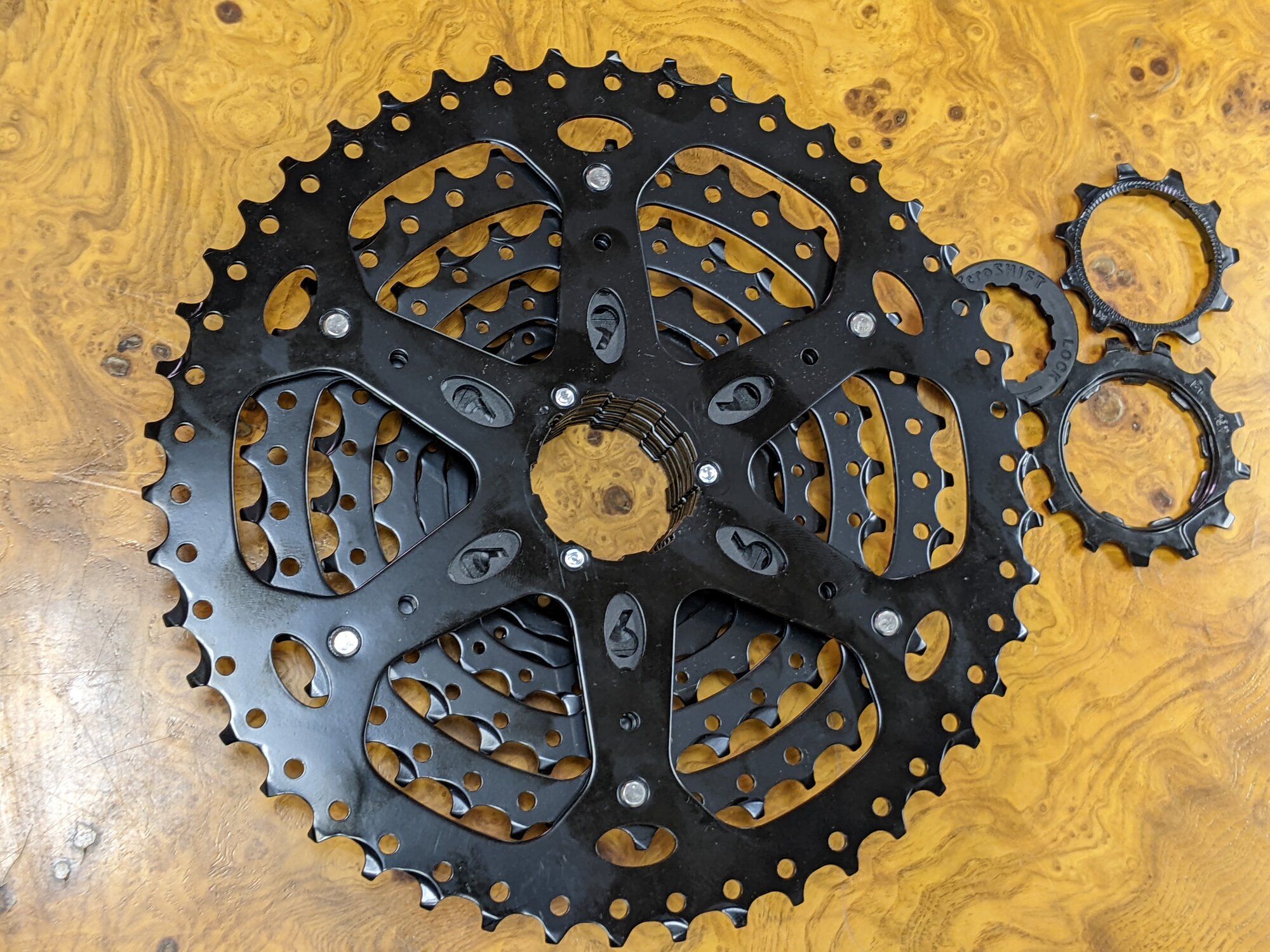

Note the pins and the 1-piece construction. $39 retail IIRC.

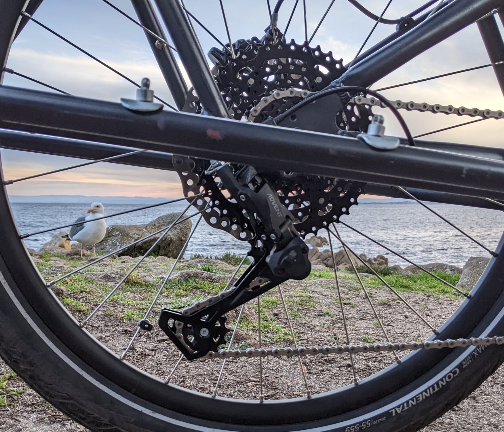

This is the Microshift cluster with the Box 2 X-Wide derailleur
...and the same cluster with the Microshift derailleur

A big thank you! It's all done. I got in two test rides and one crash. So funny. I learned a lot. I had some difficulty, made some mistakes, used box tech support via email which was great. I sent them pics and they told me what was wrong with my install and how to fix it. I followed their instructions and everything works perfectly. I bought a KMC, 126 link, 9 speed E bike chain ($47) and some tools ($50) to change the cassette. All in all, I have about $355 invested in this drive train ($215) and tools. I ended up with a 52t chainring ($30) and an 11/50t cassette. 1st gear is 1:1.04, from 1:1.53 and 9th gear is 1:4.73 from 1:3.82, which is not dramatic on paper but when climbing a steep hill, it is much easier and I can get up the hill much further before falling or adding electric power. The top end on the other hand is very noticeable. I cannot run out of pedal resistance on flat ground and have reached a top speed of 33 mph on the flats.
Box three, Prime 9, X-wide, Multi-shift, 11/50t group set

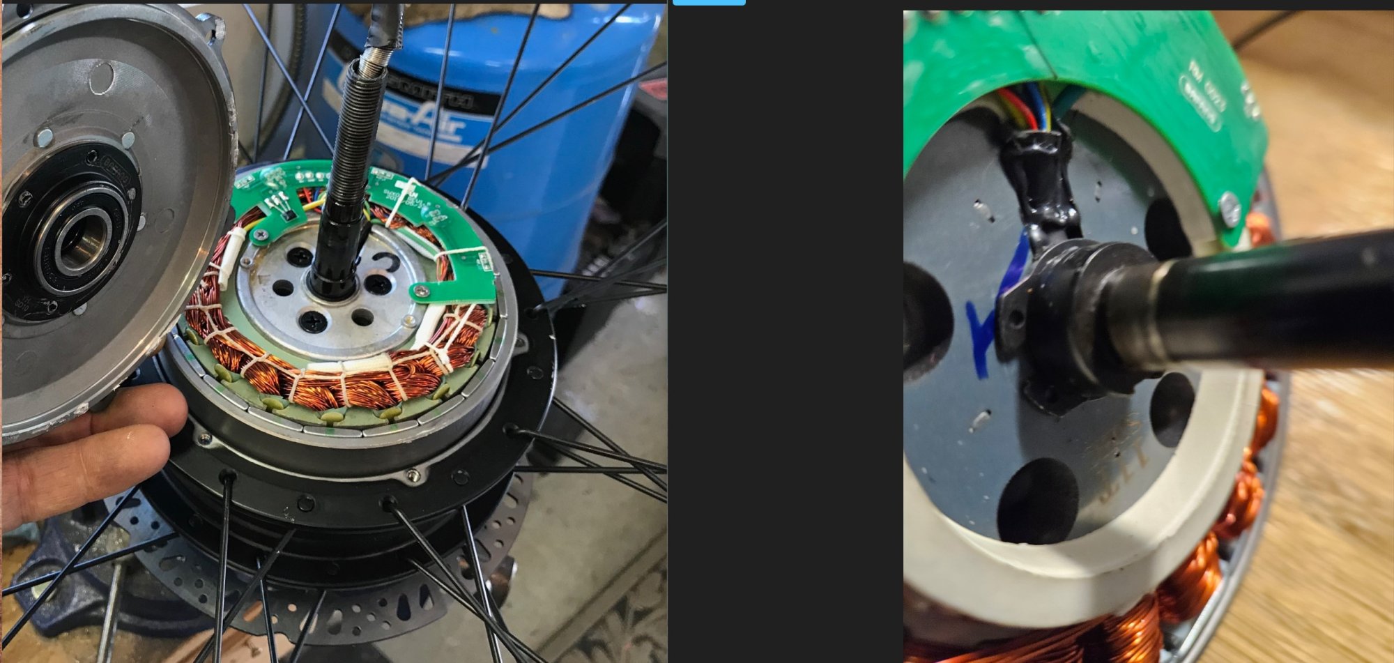

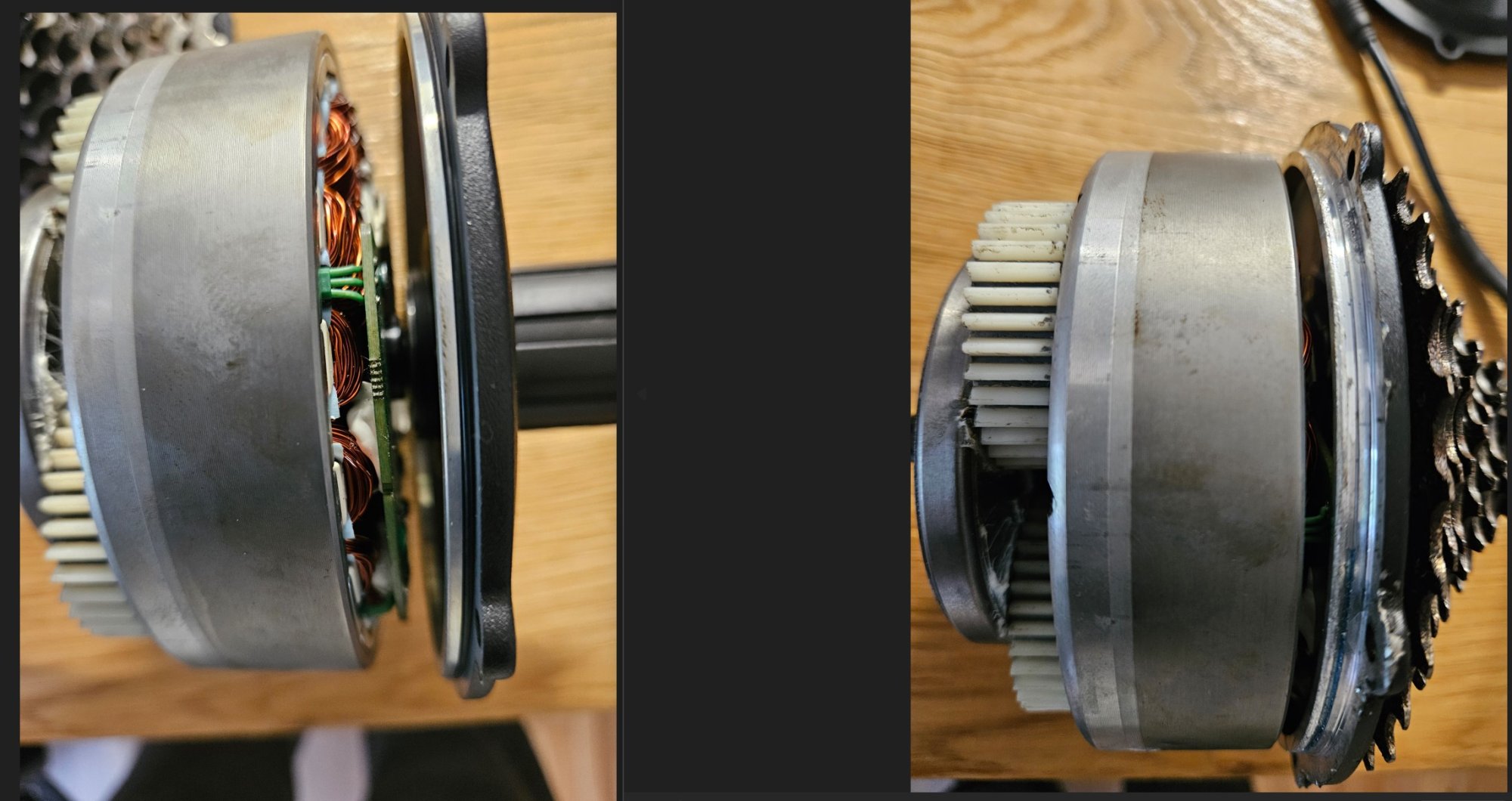

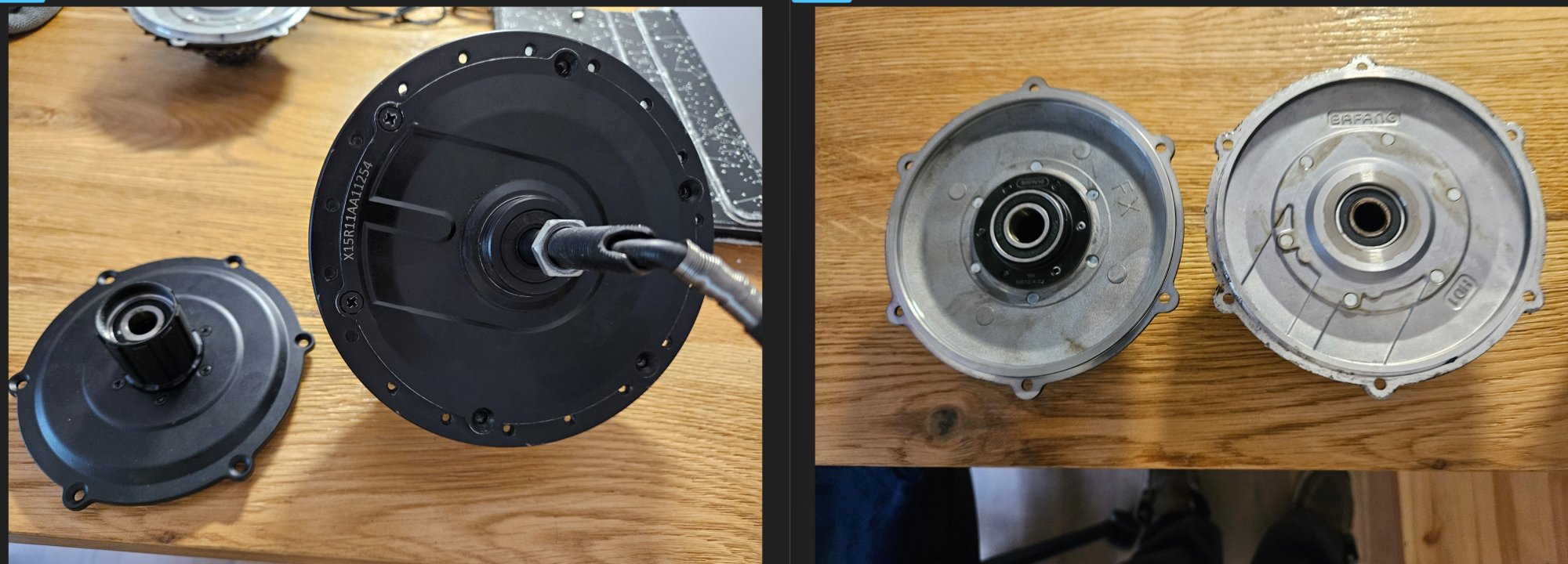

Hi, could anybody tell me if I take the motor out of a Bafang rear hub motor which is originally a Cassette version could I place just the motor into a freewheel casing both are 175mm drop-out.
