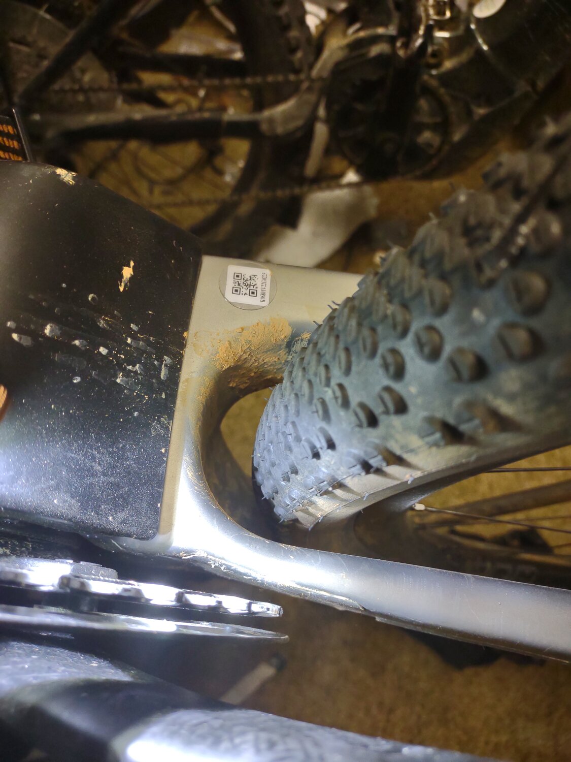

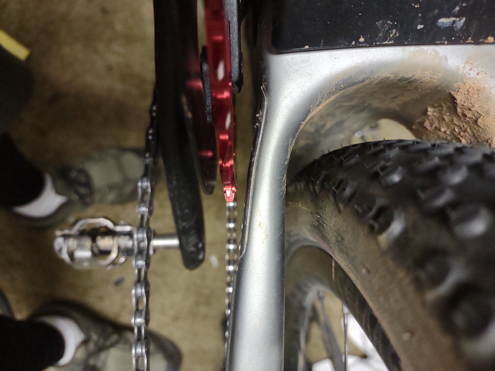

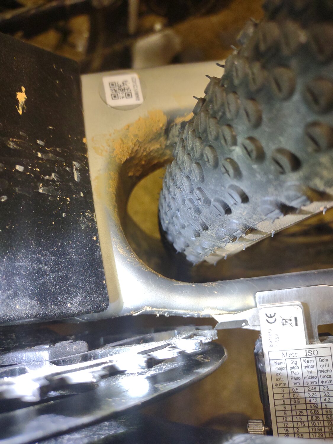

Quick update I tried a 48t on it will fit fine on a size medium so again, I would recheck your measurements (I will do pictures in anotehr post so people don't get the wrong information) but the chainring itself (not sure if chainline or not) appeared to catch not being a narrow wide like the 46t one I have been doing the fast group rides with. So, I will probably by another one of these great running cheap and quiet VXM Chainrings in a 48t to try for fun. I don't really need it full time unless I was doing more long distance flat/rolling group rides.
I really don't expect these rings to last a real long time but I have had this last one I use last a season. Care should always be taken when running alum chainrings on an ebike generally I would get FSA ebike specific alum rings. Otherwise steel (which works your chain over), but that is better than having a freaken chainring break when you are hammering out of the saddle. :) https://www.amazon.com/gp/product/B085SZV3NX/
Here is the real pics of the chainring clearance on a medium Canyon Grail On frame, Again, I have been using the 46t and it cleared a 48t see tech details above. Measured with a 46T it had 4mm (see where I used the calipers to measure and if you are using a narrow wide chainring be sure to measure at the wide tooth :) ...) , of clearance. Still am waiting on the 48T narrow wide chainring to try when I get back to colorado. But, again so people don't get the wrong information. This bike in at least a size medium and probably larger will fit at least a 46t and maybe even 48-50. (I am not going to test a 50t on it because there is no real reason to) I can get out of the saddle and sprint (thanks to speedbox), up to my normal sprint speed with the 48t. Disclaimer, I am not a sprinter I am talking about when the wild and wonderful accelerations happen in the pack and one needs to quickly bridge from a large gap, back to the draft.

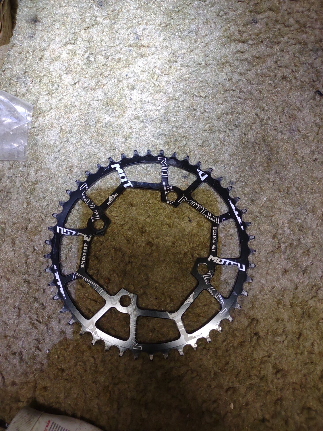

Okay here is the real clearance with a as described above narrow wide 48t version of that chainring that just came in. As you can see it is just fine and is about 3.5mm.
Yeah that looks like its safe, without need to space out chainring with washers. Really appreciate sharing the experience and the photo!
