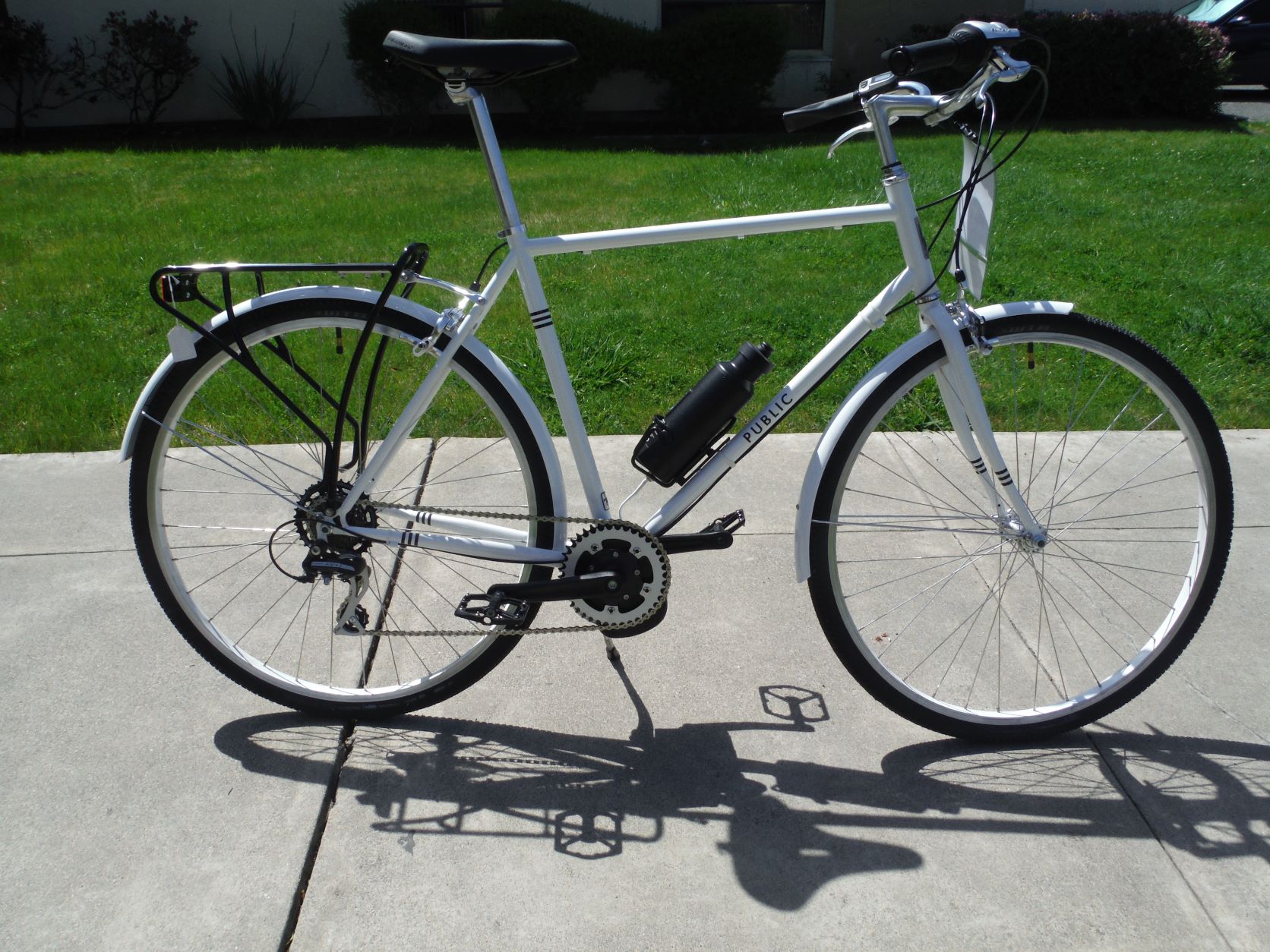

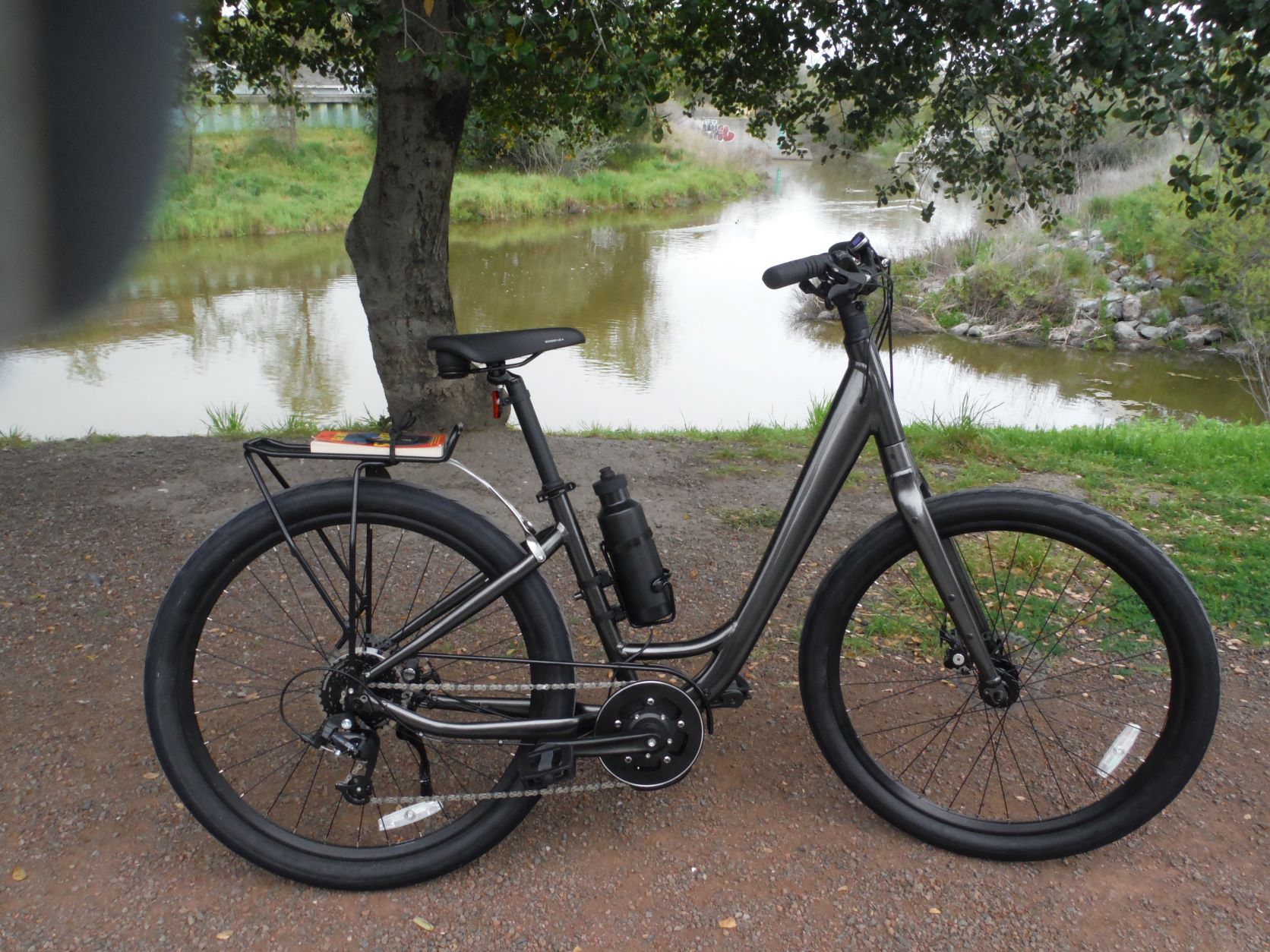

Hi M, and welcome to EBR. I recently converted a couple of Giant Momentum Vidas that are super comfy, lightweight and can take some trails and will do big hills. For hills you will want the motor in the middle of the bike so the power goes through the gearing system. Here is a white bike that I just made and will sell this week for $2499. It has gravel tires. Maybe someone is doing quality conversions in your neighborhood. I am in the SF Bay Area. Good electric bikes look elegant and ride smoothly. These are class 3 but look class 1
