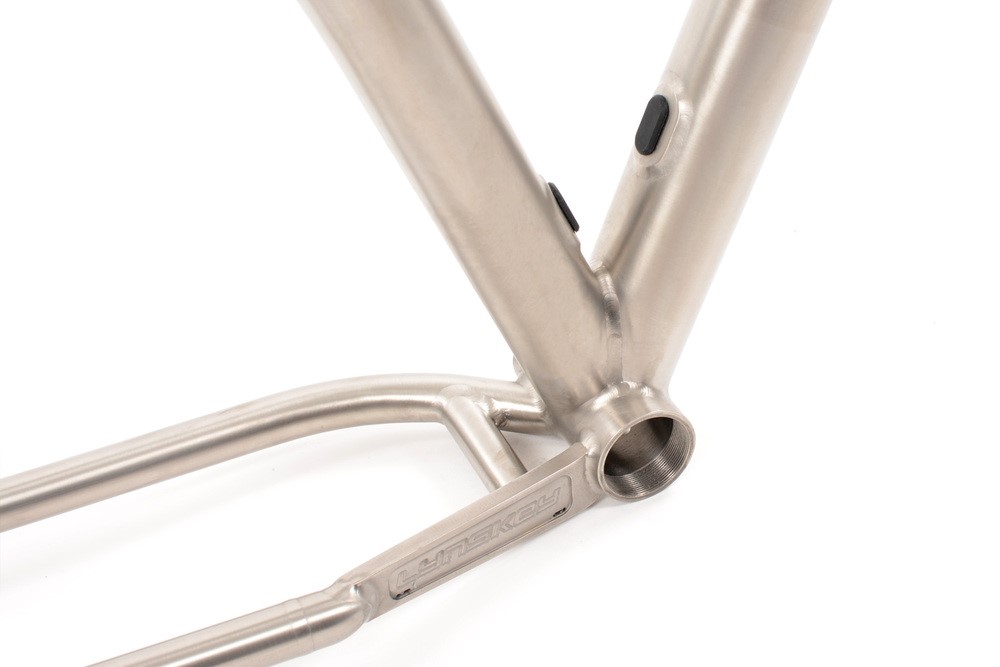

I'm going to 3D print a thinner cable guide and it looks like the bridge plate might actually line up with the hole in the plate on the chainstays, so I'll first give this a shot. Since we have two bikes, it might be fun in the future to try both motor types and see how it goes. What's most important for me at the moment is that any system I use has to be extremely intuitive, since I'll be sharing the bike with another rider who isn't necessarily into this kind of thing.

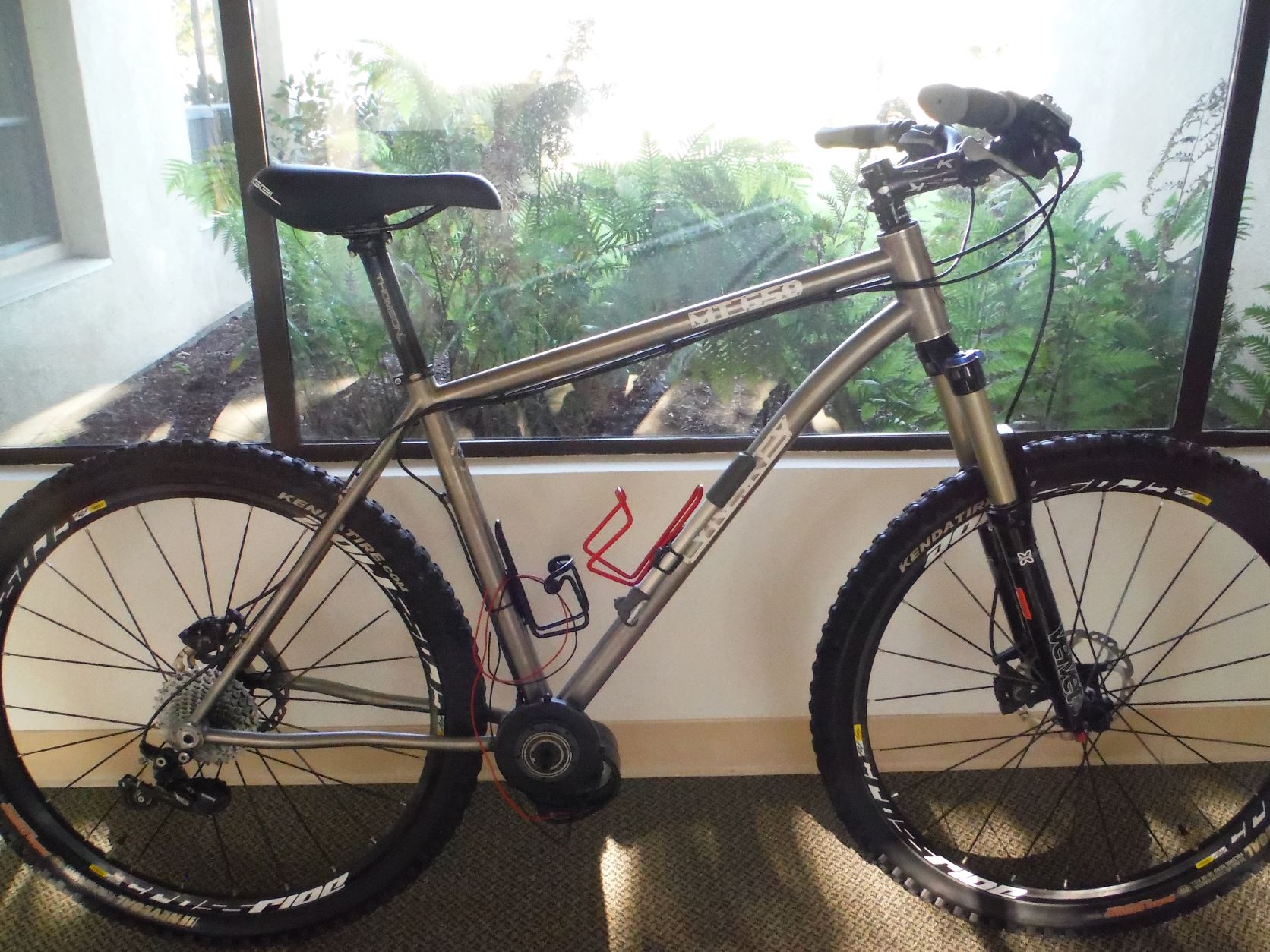

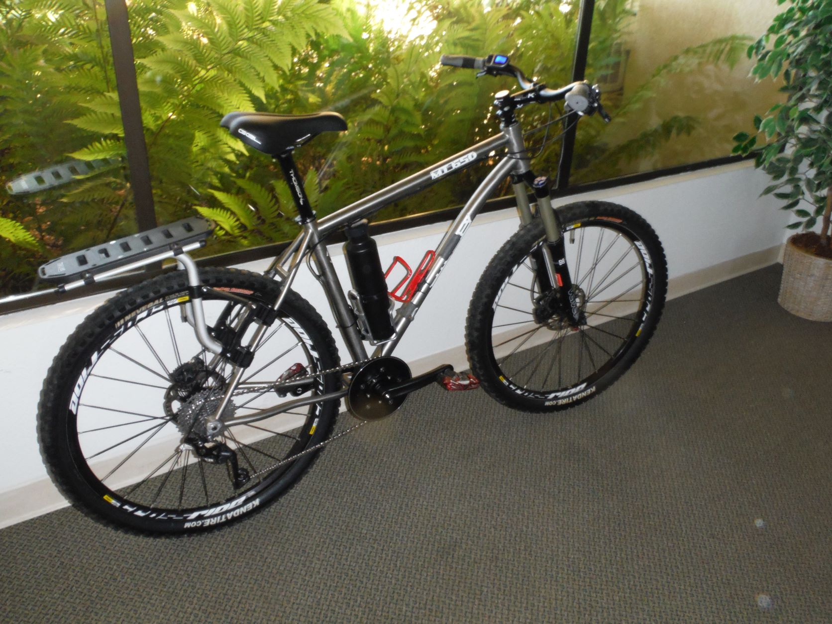

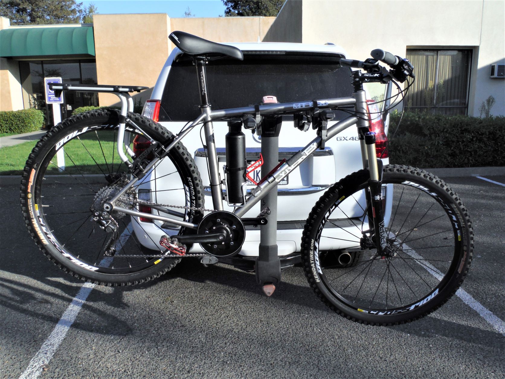

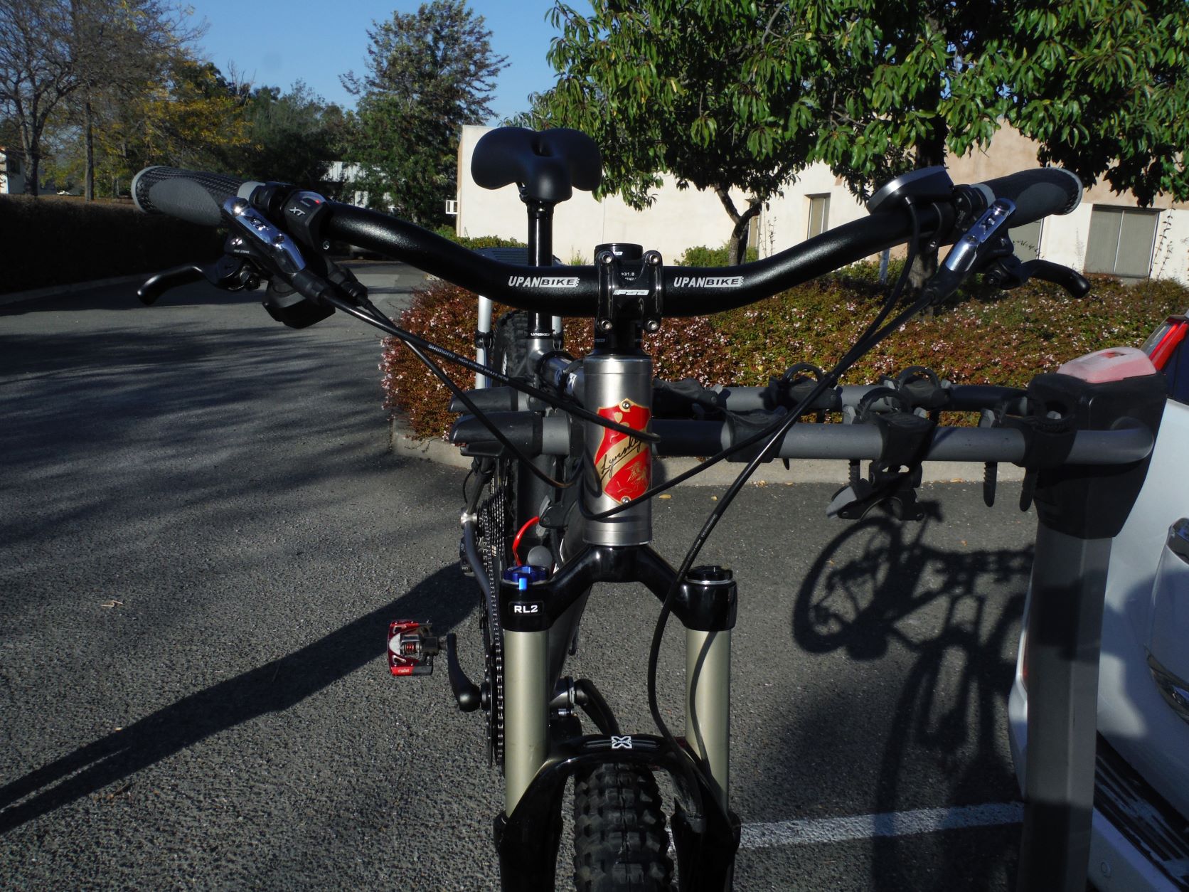

It is an aluminum bike so drilling the plate will be easy. Remove the screw of the BB cable guides, chucking the plastic piece. One of these is for the front derailleur which is going anyway. The rear shift cable can be run one of two ways as continuous housing. 1) Following the rear brake housing until the seat stays, then down the right seat stay to the shifter. 2) Over the top of the bottom bracket and down the underside of the right chain stay. With option two, do not be tempted to make the curve too tight over the bottom bracket or you will have shifting problems. Do not run any wires or cables between the motor and the bottom bracket. If you use zip ties with option one they can be touched with matching nail polish so that they go unseen. I drill bikes every week. Just be thoughtful when doing it. You are just modifying a kickstand bracket. Here is a bike made yesterday.
